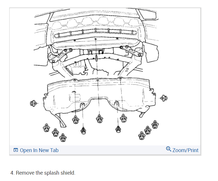

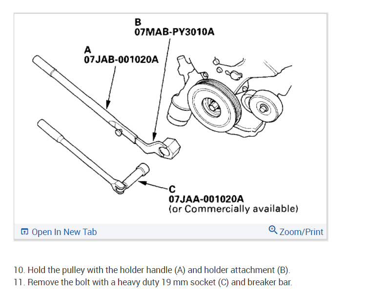

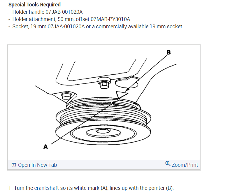

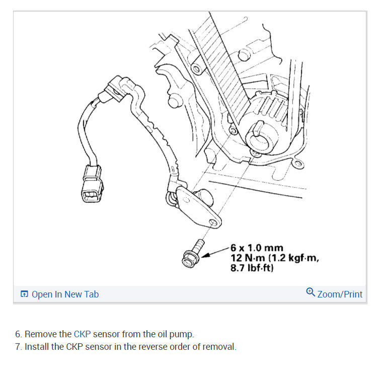

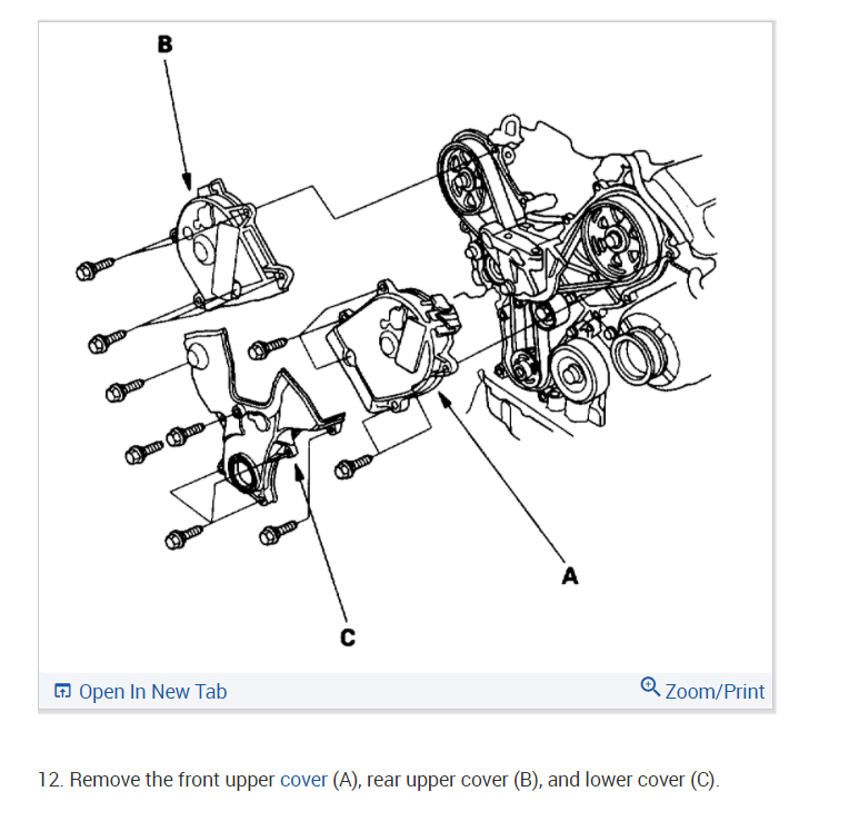

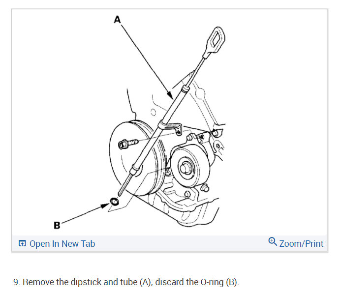

I am trying to replace the crankshaft position sensor. I am having trouble locating it. What all needs to be removed to get to it
Apr 12, 2021 at 11:11 PM
CERTIFIED EXPERT
52,796 POSTS

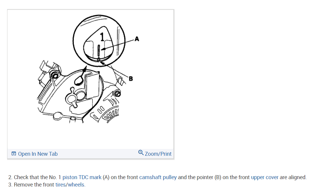

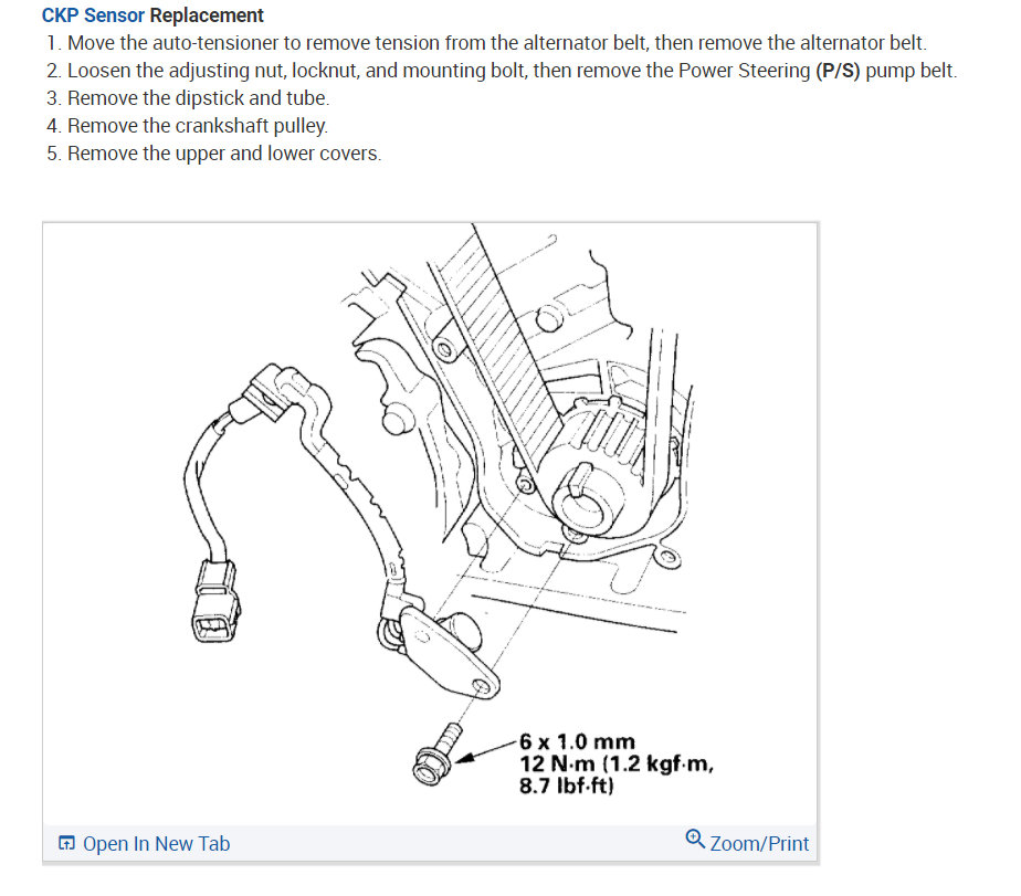

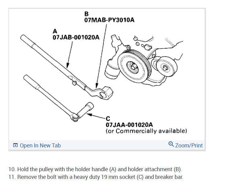

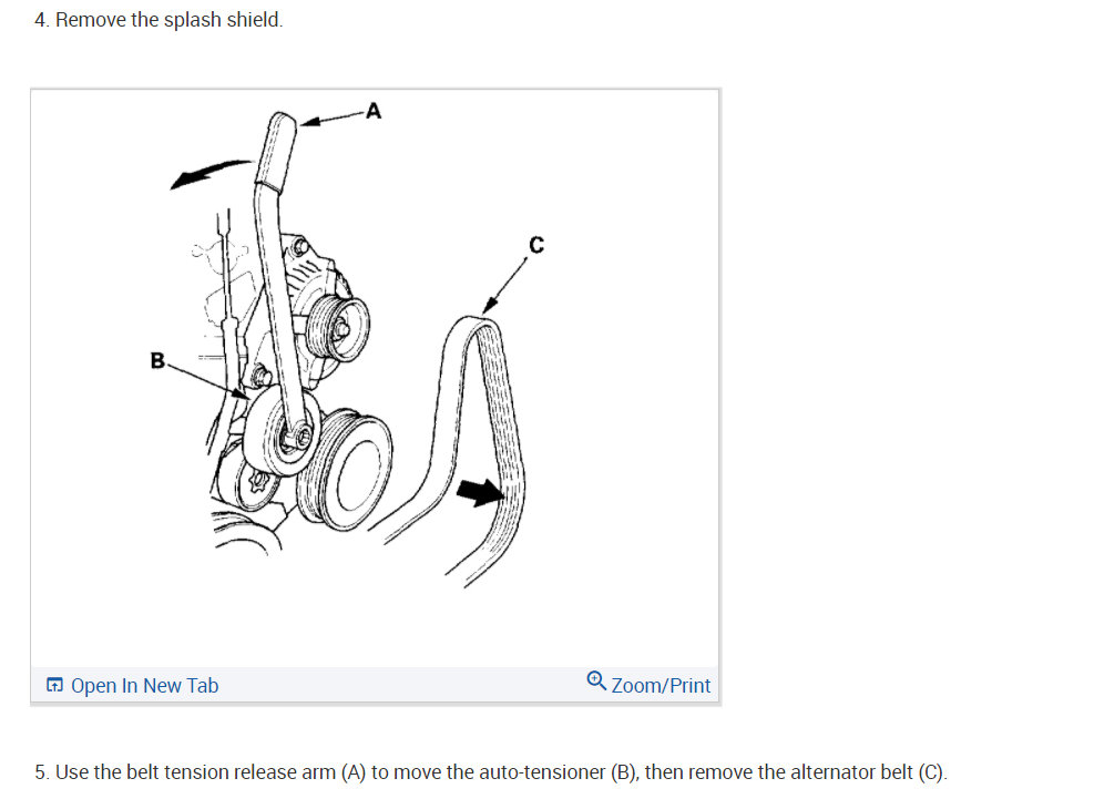

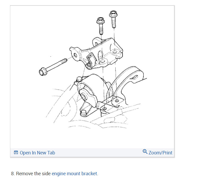

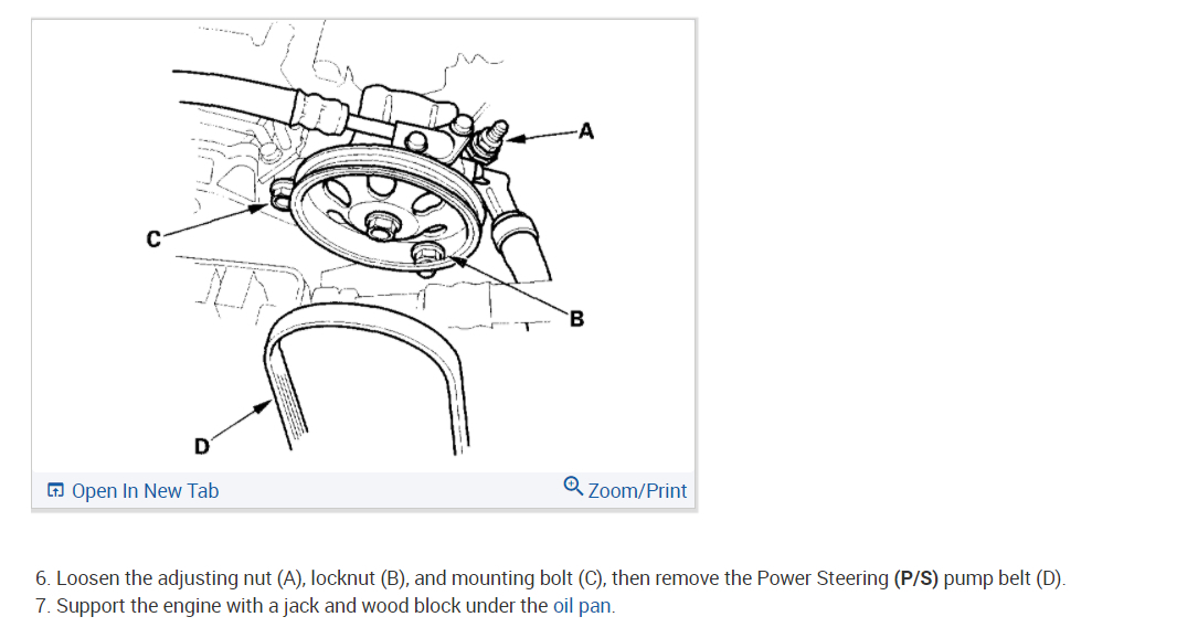

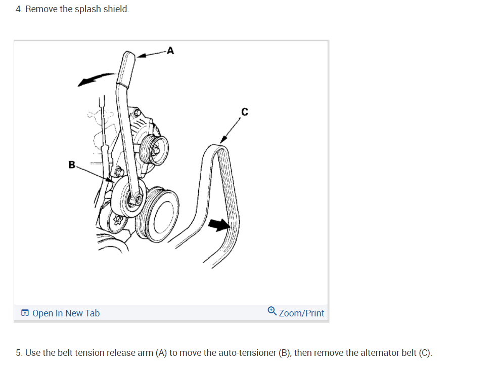

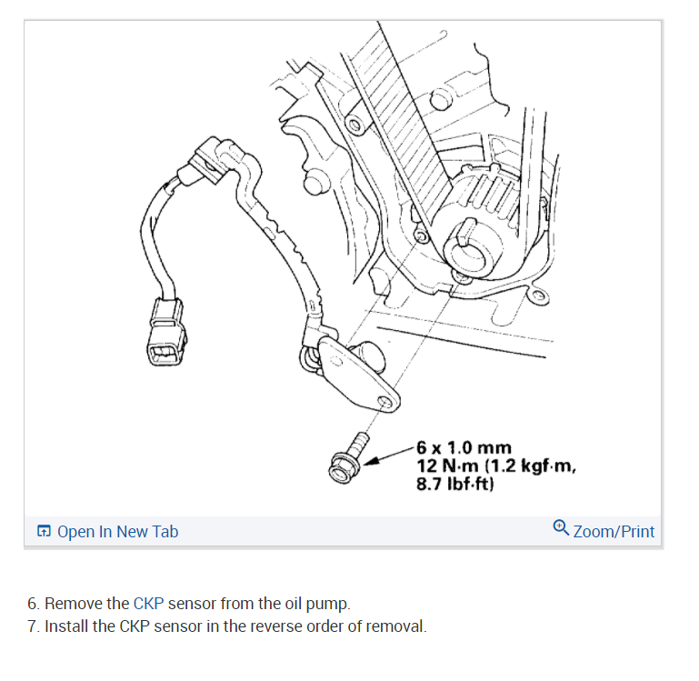

Good morning,
I attached the steps for you for the replacement of the crankshaft position sensor below. It is under the bottom cover for the timing belt at the crank pulley.
