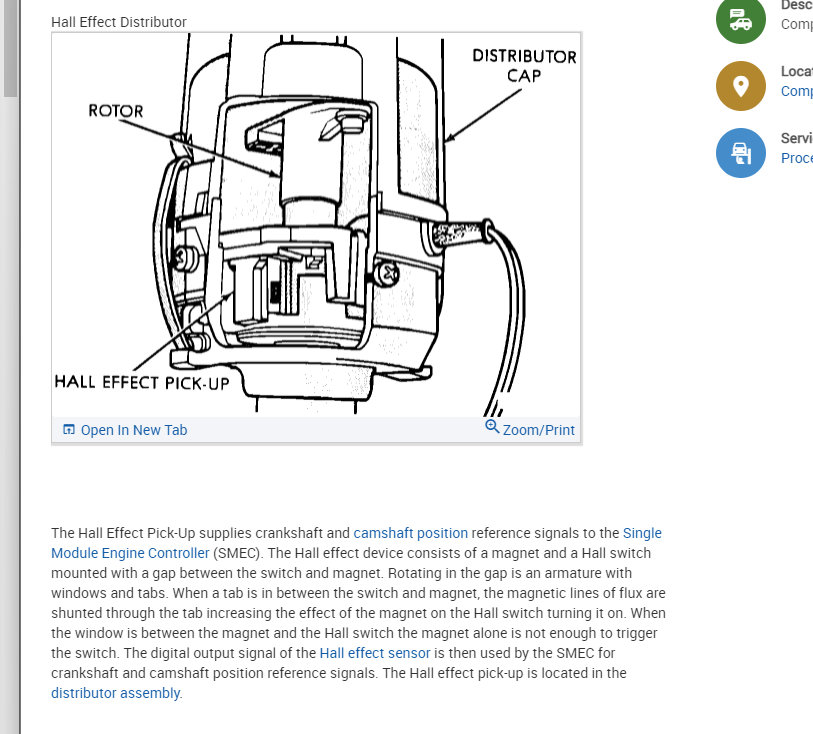

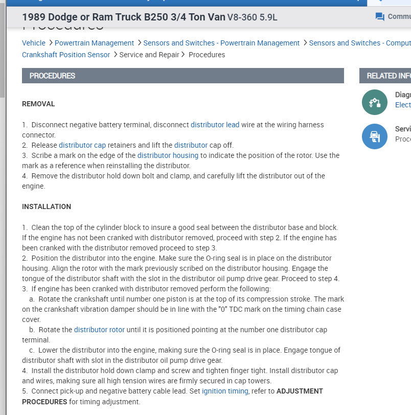

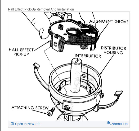

I am including the info from the manual on the 5.9L which puts this CKP as part of the distributor. It is called the Hall Effect
Pick up.
So, I am attaching the info on this from the manual. Let me know what other questions you have about this, and we can go from there.
