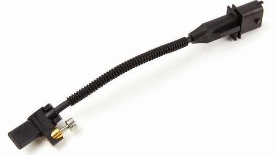

Where is the crankshaft position sensor on the car listed above four door?
Aug 20, 2018 at 8:34 AM
STEVE W.
  • 15,113 POSTS
If you look at the "rear" of the engine at the area where it attaches to the transmission the crank position sensor is bolted in place with a single screw in line with the transmission dipstick at the bell-housing. What is the issue you are having? Crank no start or?
