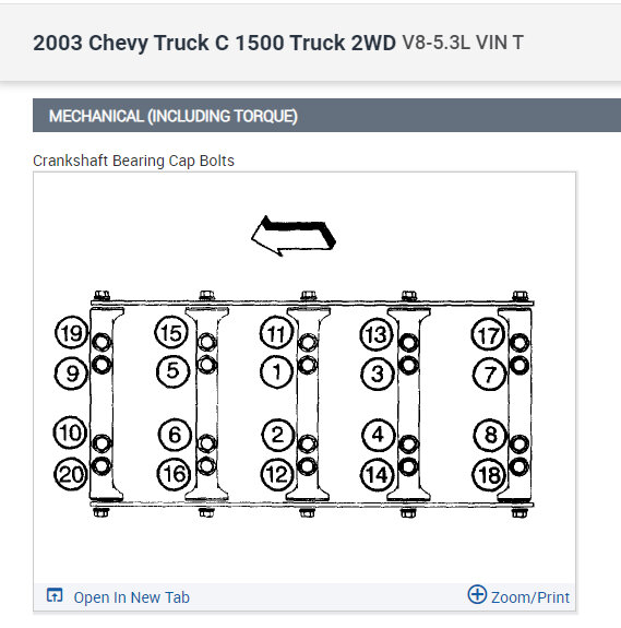

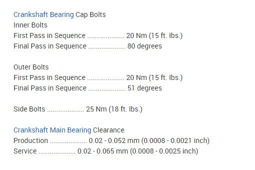

Rebuilding 5.3 vortec out of 2003 Chevy Silverado 1500
Installed crankshaft bearings and crankshaft checked clearance was in spec.
Installed caps and tightened to correct torque and angle to all bolts’
I know the numbers on crankshaft is correct for 5.3. I go to turn it and it’s locked up.
It was king main bearings I used?
It won’t spin at all. What could the problem be?
Thanks

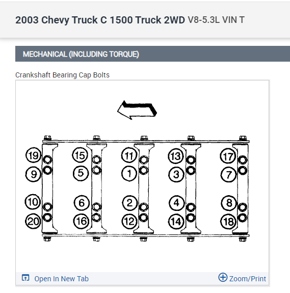

Thanks
