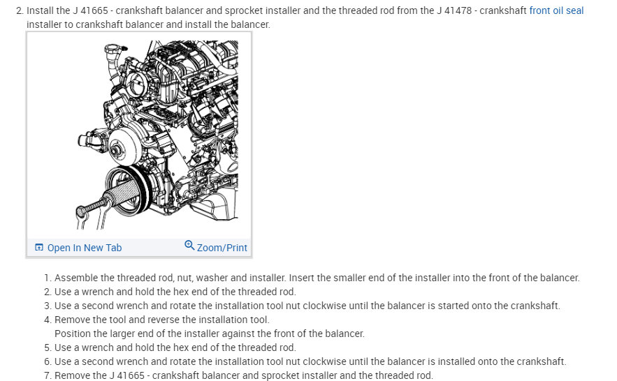

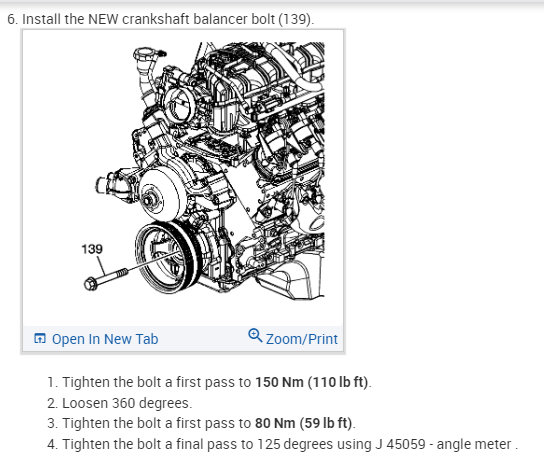

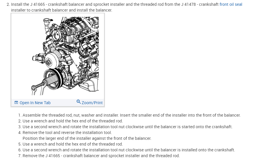

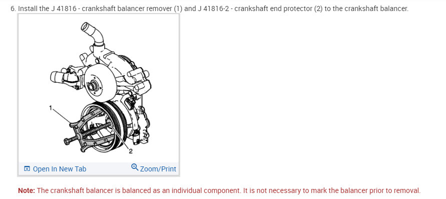

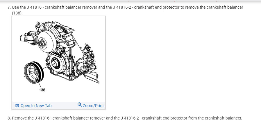

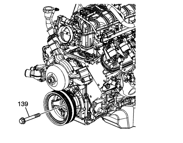

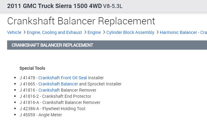

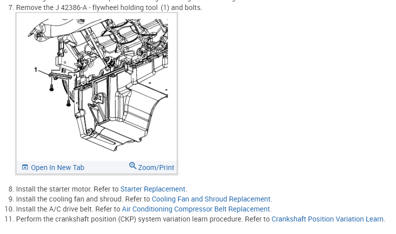

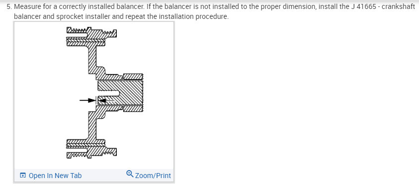

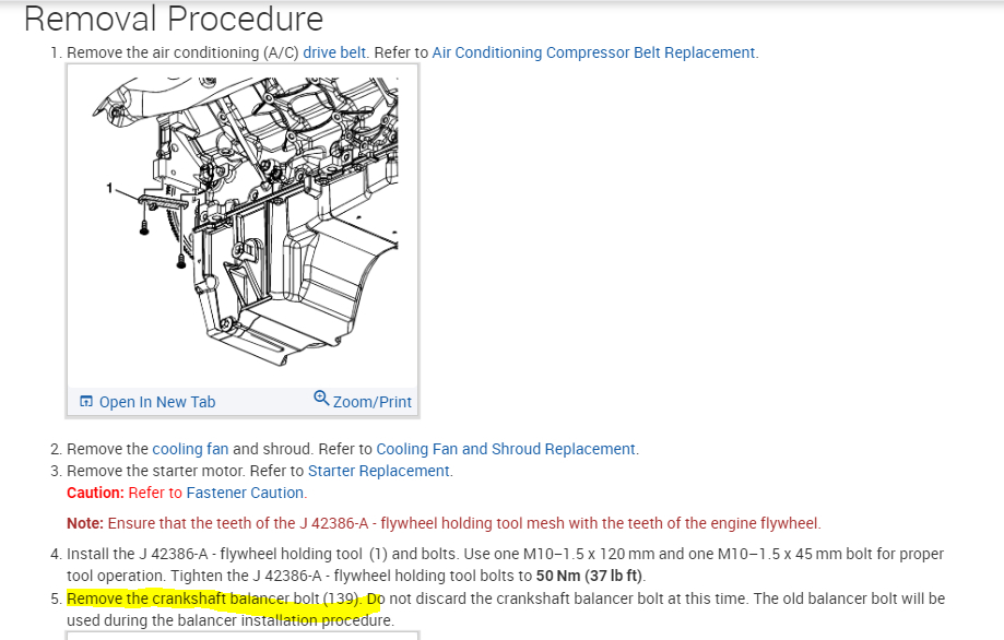

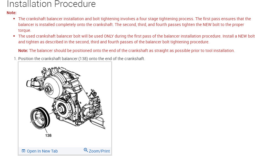

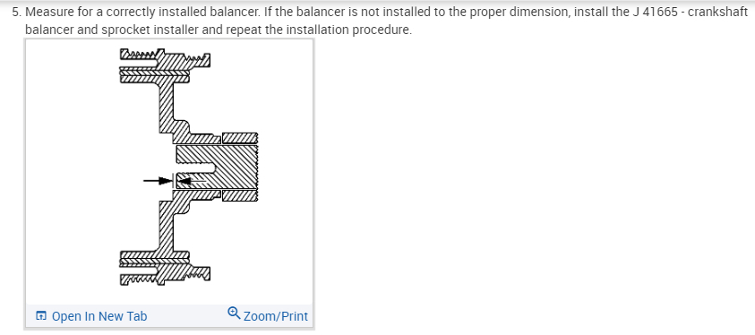

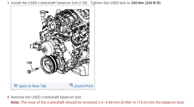

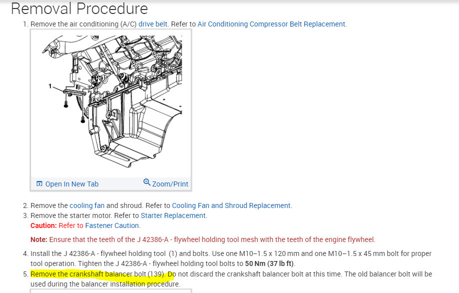

I went through the manual for replacing the balancer, and there is nothing mentioned. I don't know if you need them, but I did include the directions for the removal and replacement. I highlighted the only line related to removing the bolt. Also, you will need to replace that bolt once it is out. However, you will need to temporarily reuse it in the installation process.
See pics below.
