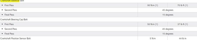

I need crankshaft pulley torque.
Jul 2, 2018 at 5:23 PM
I believe you are referring to the crankshaft balancer (harmonic balancer). I have attached the torque specification for all crankshaft related bolts for your review.
Let me know if this helps.
