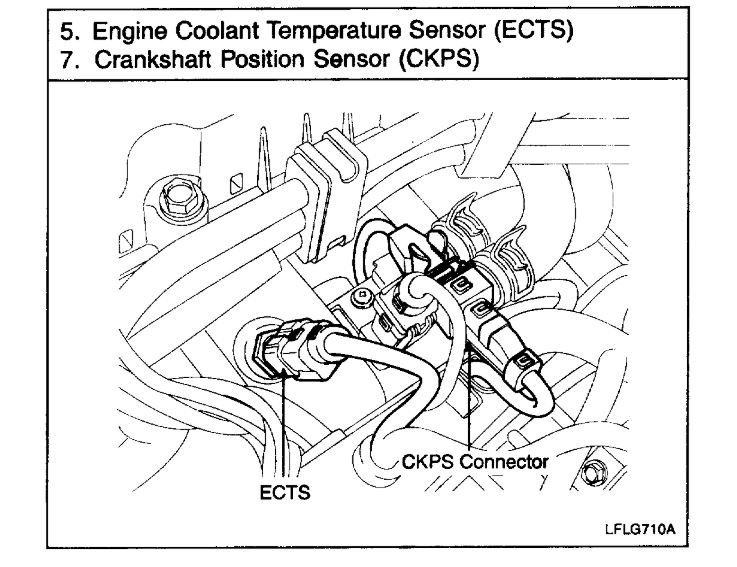

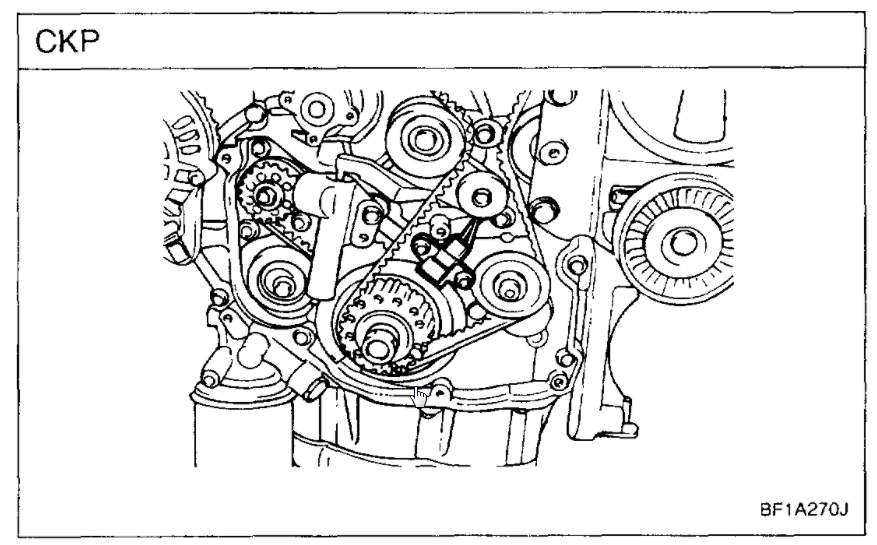

Where is the crankshaft position sensor located and how to change it?

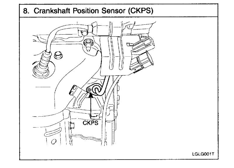

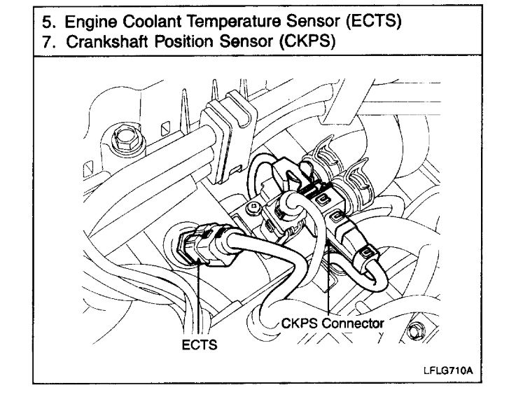

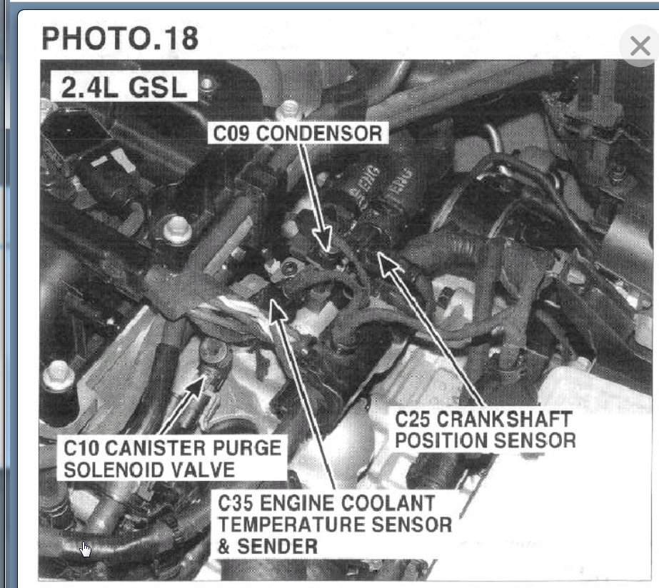

Good morning,

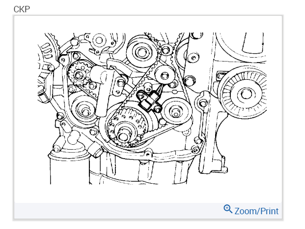

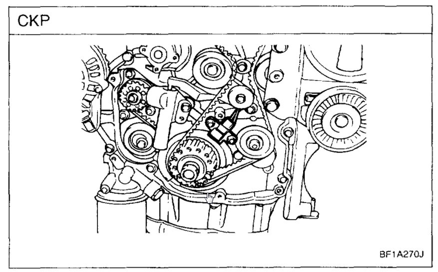

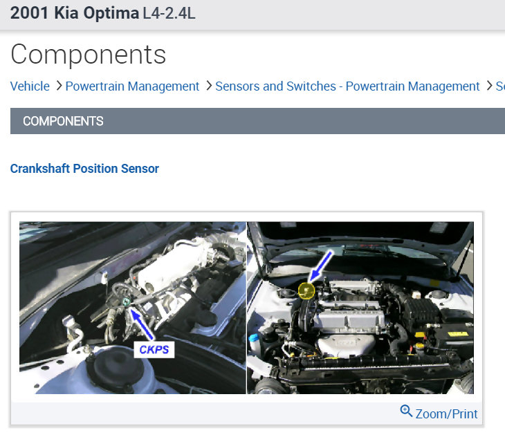

You did not list the engine size so I attached pictures of both engines of the location. Why are you replacing the sensor? Do you have a code or does the engine not run? Check out the diagrams (Below). Please let us know what happens.

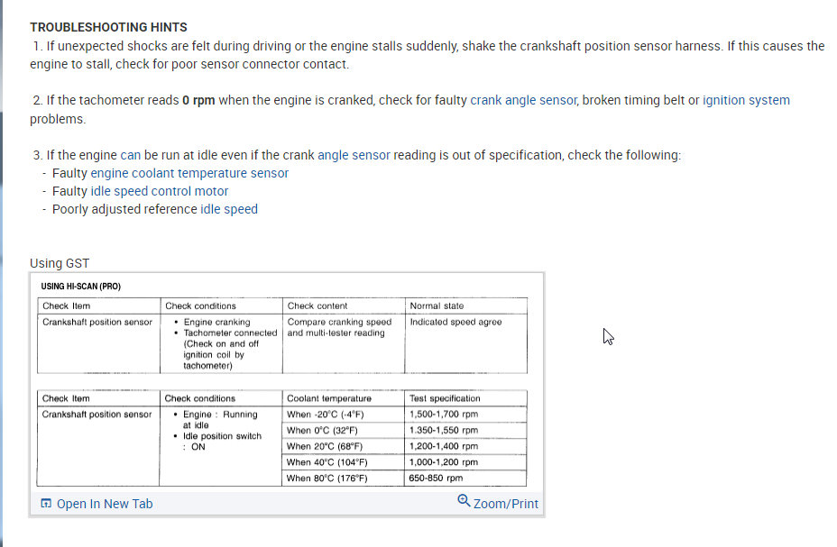

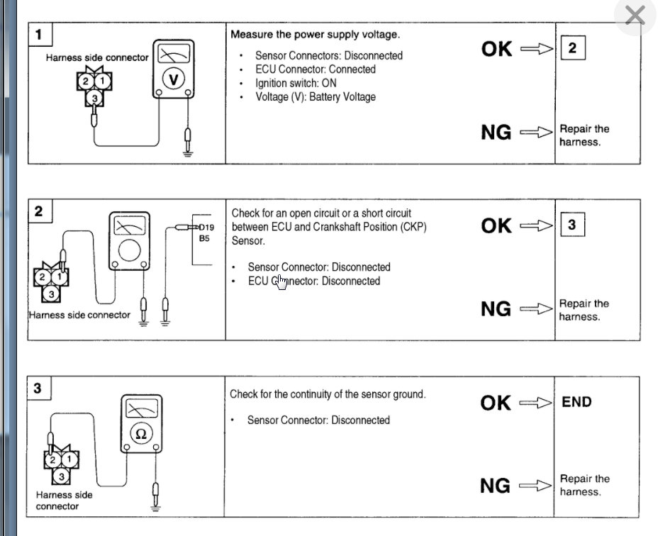

CERTIFIED EXPERT
18,907 POSTS

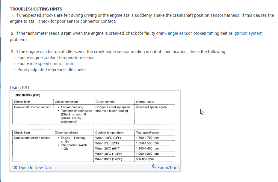

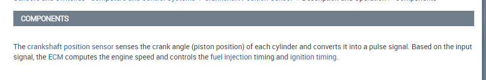

Here are some guides on how to replace the CKP sensor plus some more info on what happens when a CKP sensor fails.
Plus here is some more info on how to replace, location, and general info on the crankshaft position sensor.
Let us know if you need more info. Thanks

RASMATAZ
CERTIFIED EXPERT
75,992 POSTS
See below, the other end is at the computer

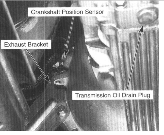

Where is the crankshaft position sensor located in 2.7 v6 engine
Feb 5, 2021 at 10:27 AM
(Merged)
KHLOW2008
CERTIFIED EXPERT
41,814 POSTS
The crankshaft angle sensor is located on the bell housing on the drivers side here is a guide to help you see what you are in for when doing the job.

RASMATAZ
CERTIFIED EXPERT
75,992 POSTS
Here is a guide to help you see what you are in for when changing the sensor out plus the location of the sensor for both the four and six cylinder engines below. Check out the diagrams (below). Please let us know if you need anything else to get the problem fixed.
