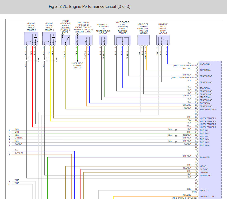

6) Replaced CPS (three prong harness engine side prong one Ground good, prong two or center five volts and prong three no volts).

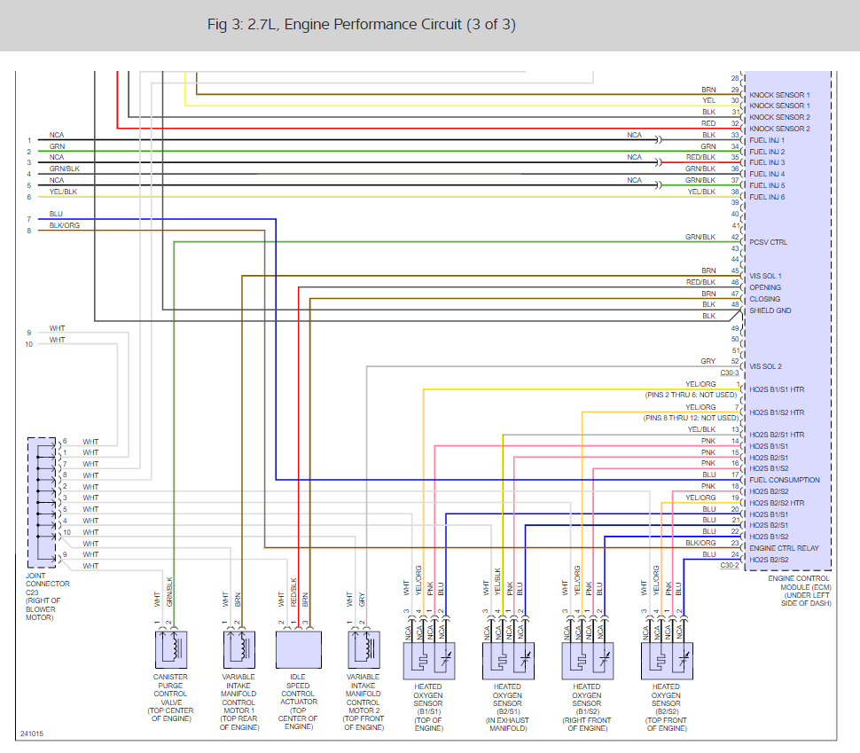

7) Injector wire harness engine side, 4.3 volts K on EO, .63 volts on other. Not switching.

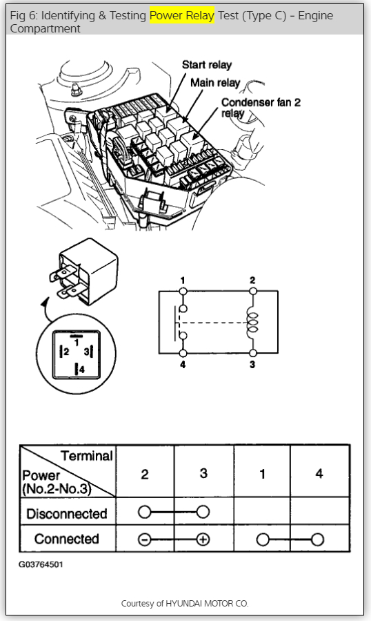

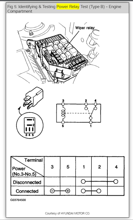

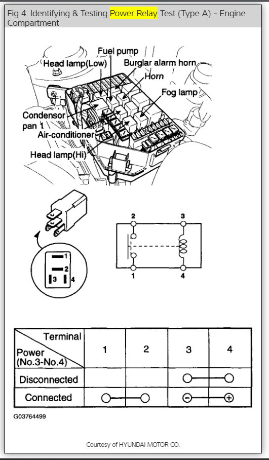

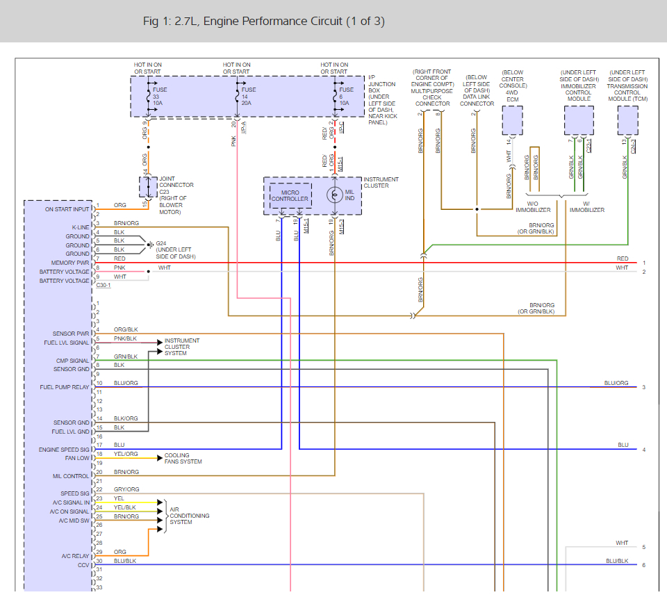

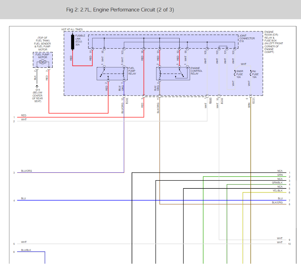

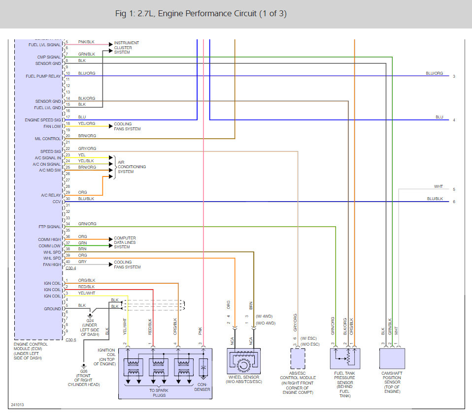

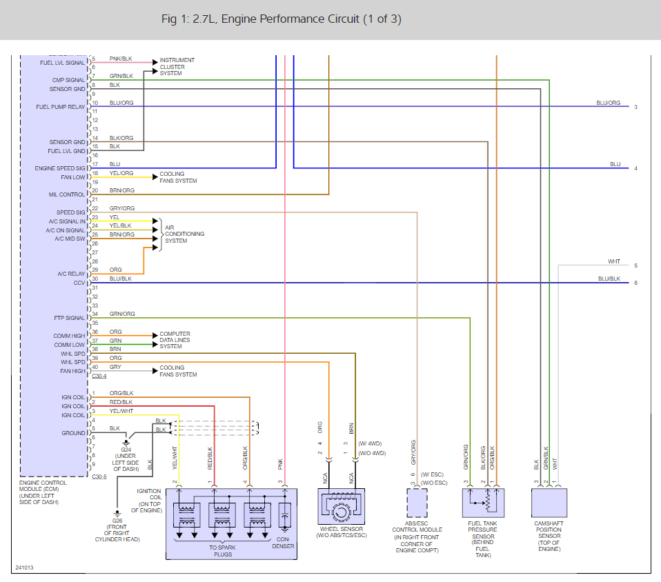

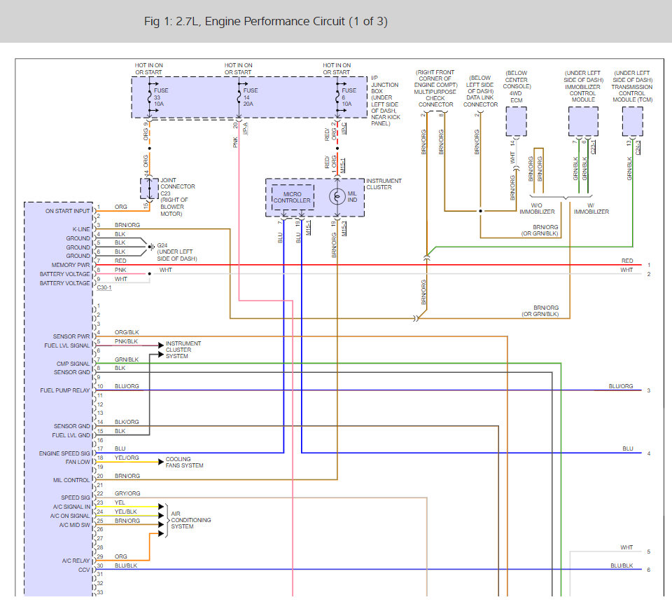

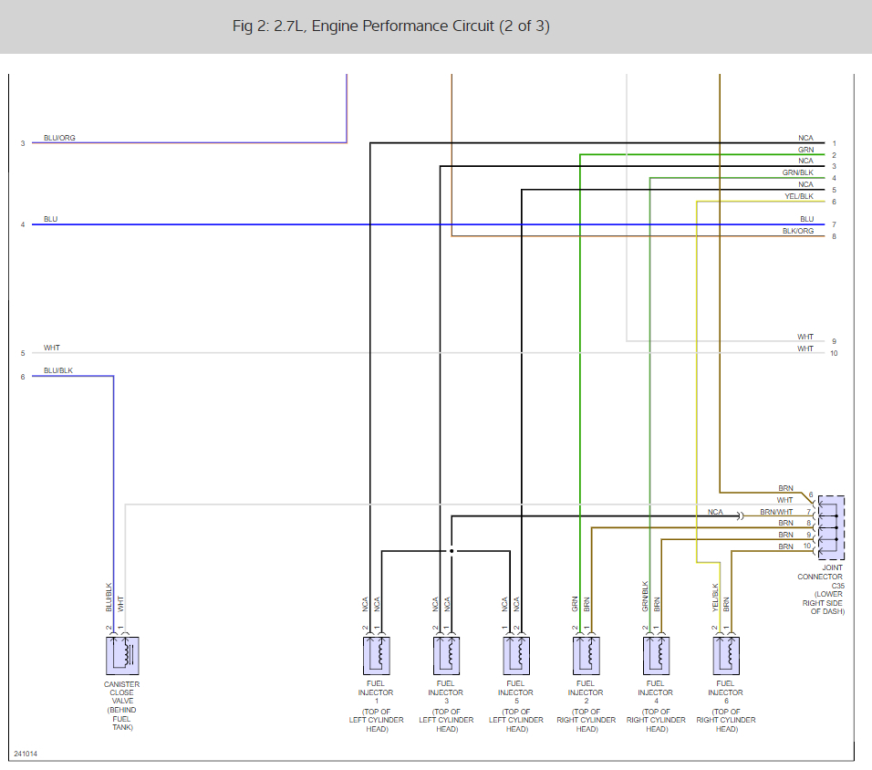

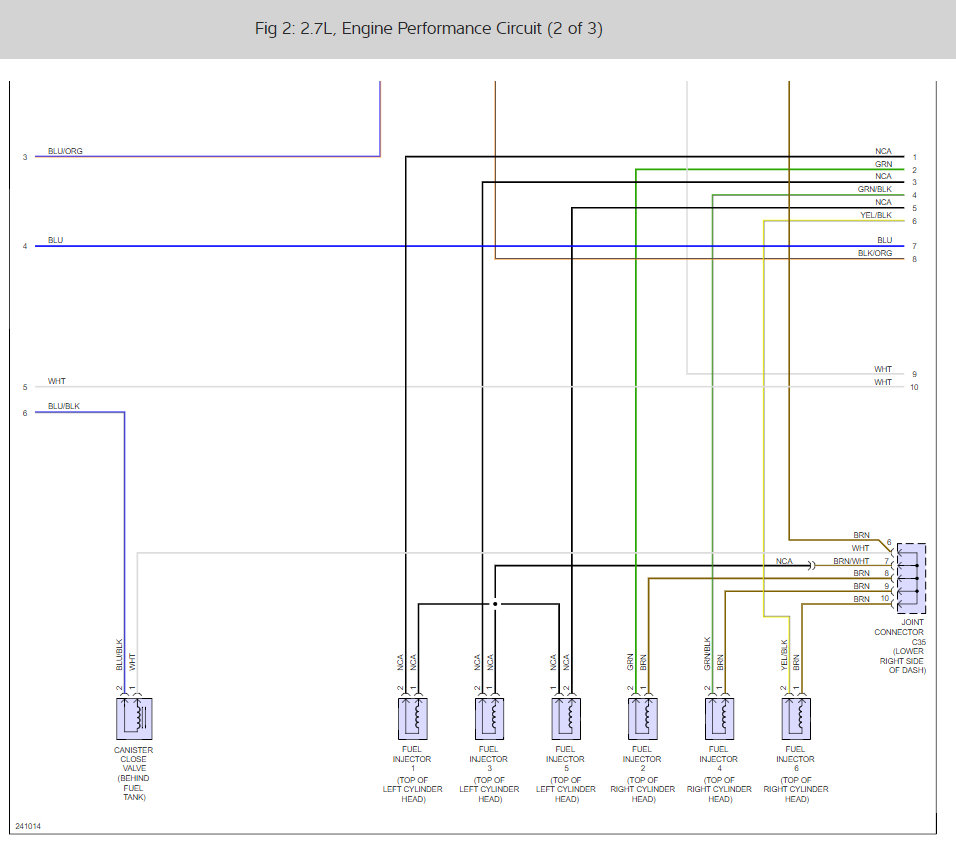

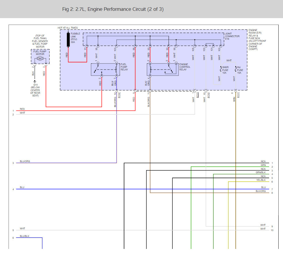

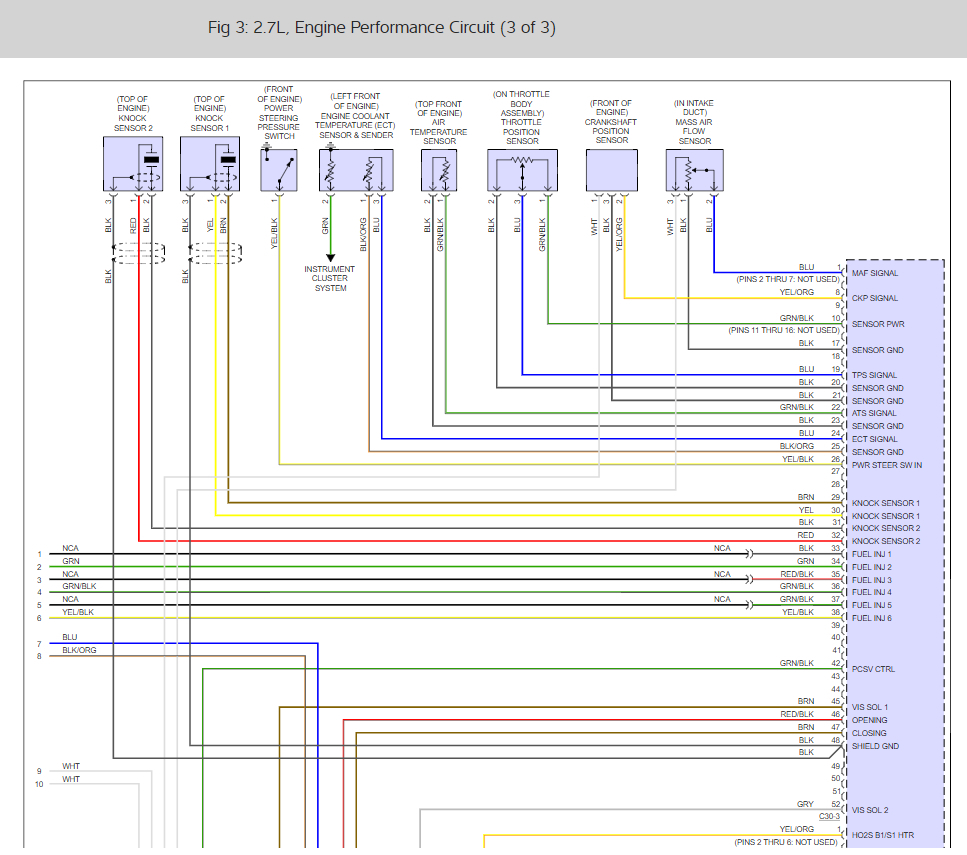

When you are cranking the engine over is the security light flashing? If not it sounds like the engine control module is not powered up. I know you said you checked the relays and fuses but I would double check them especially the main relay. The injector supply voltage should be 12 volts not 4.3 so I am thinks we are missing a voltage supply to the module or the PCM is bad.
Here are some guides and diagrams to help you do some testing.
and
(Diagrams Below)
Please let us know what you find. I'm interested to see what it is.
