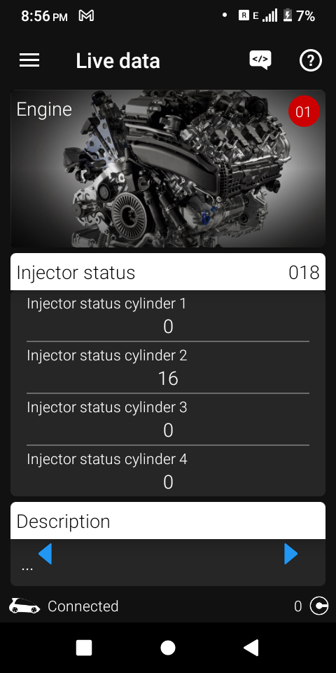

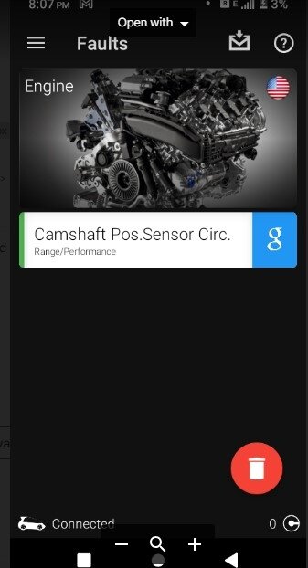

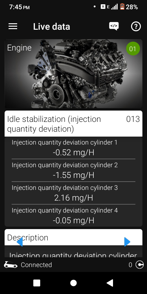

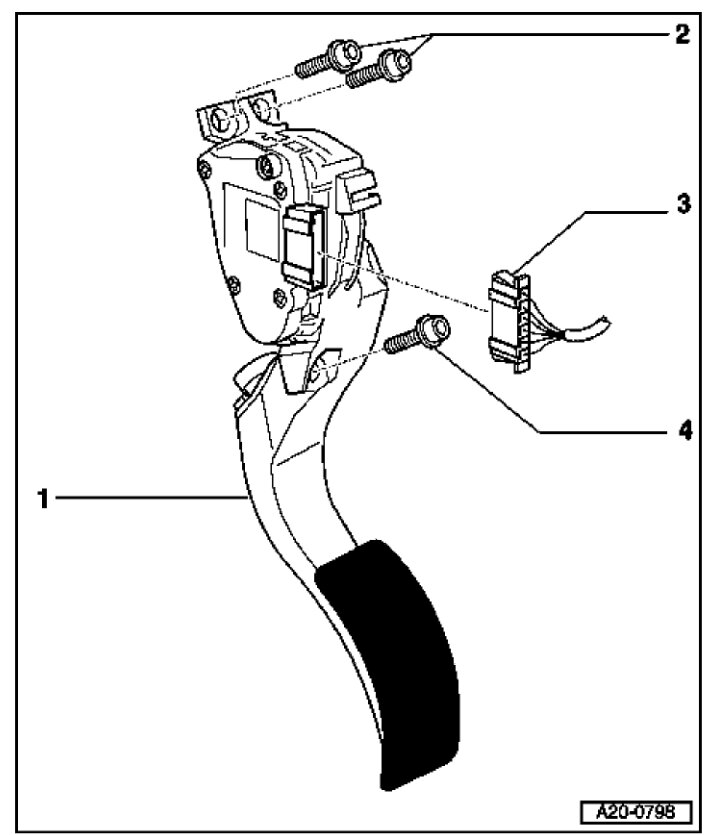

Thank you for your prompt reply. I have not yet investigated the possibility of the accelerator pedal position sensor being an issue but will investigate, although it has not come up on the car faults (recent scan). Perhaps it's also worth attempting to use a starting fluid, which i have not tried - where do we spray this, by the way? I haven't used this method before. Lastly, I'll try to bleed any air bubbles from the fuel system this week, to isolate it.
Here are all the fault codes presented by the car. It does seem that no engine faults were picked up, including injectors. But I'm not so certain if new faults would emerge after the car had started.
