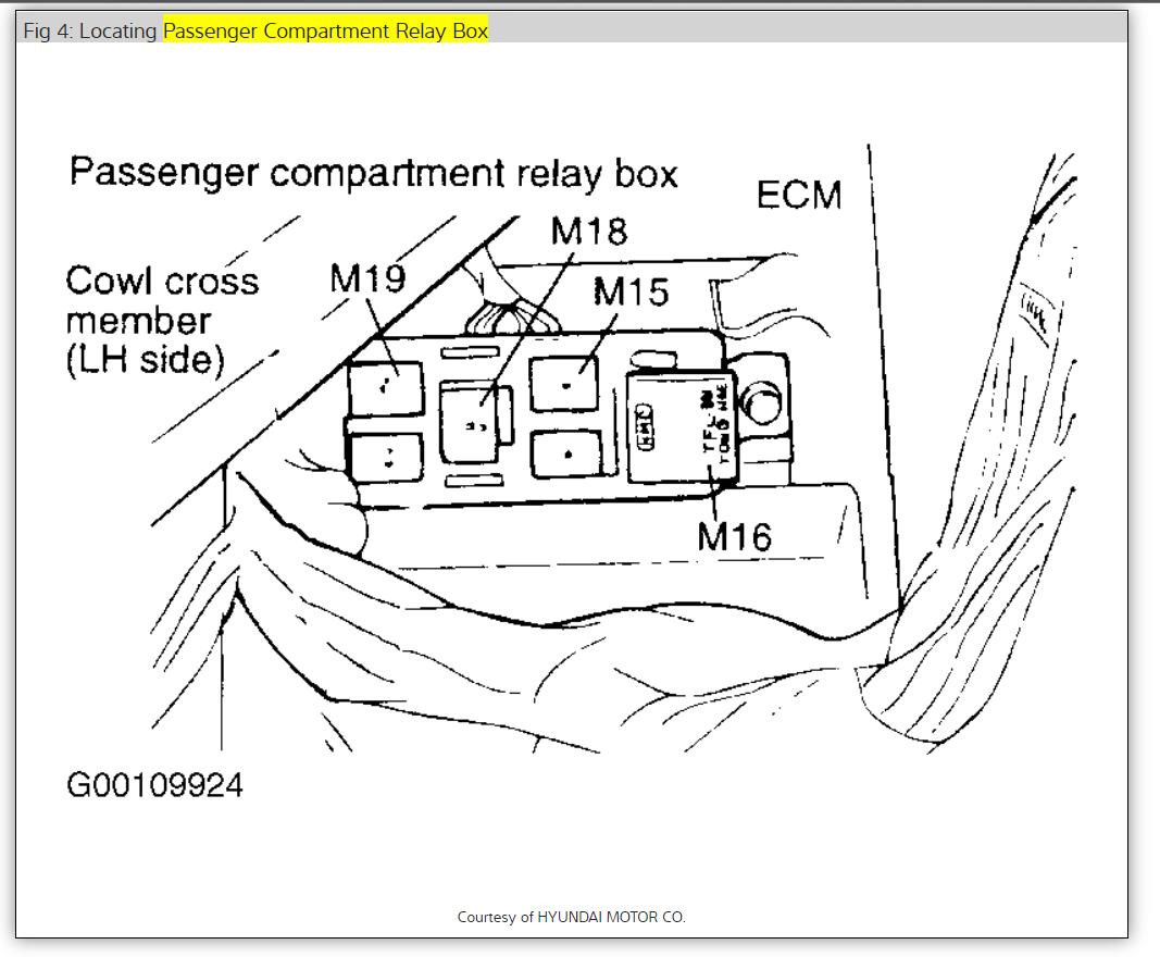

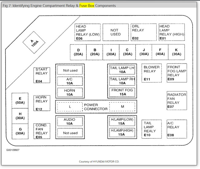

replaced starter now power to coil but no spark.

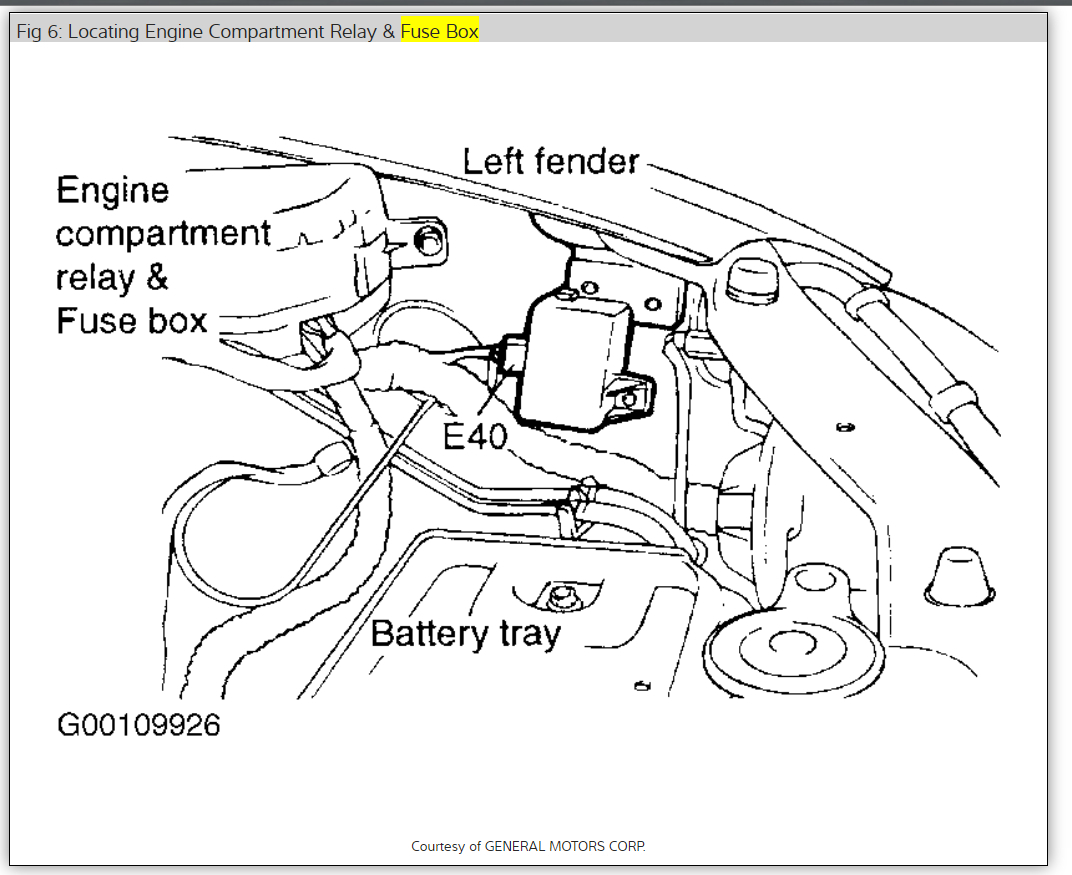

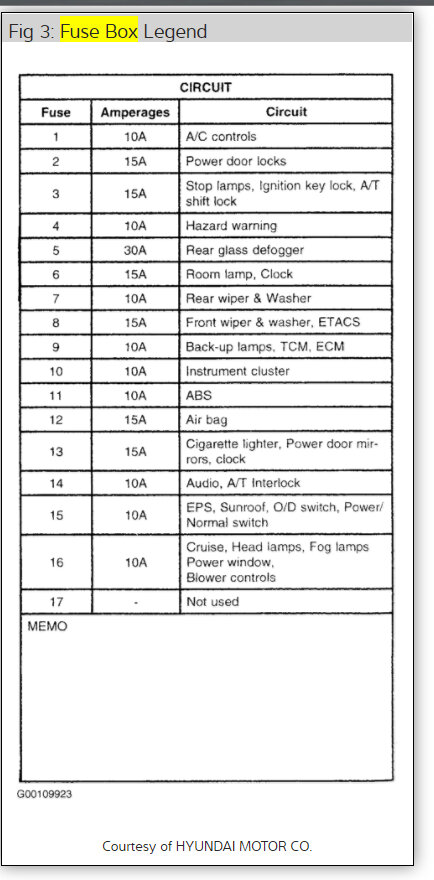

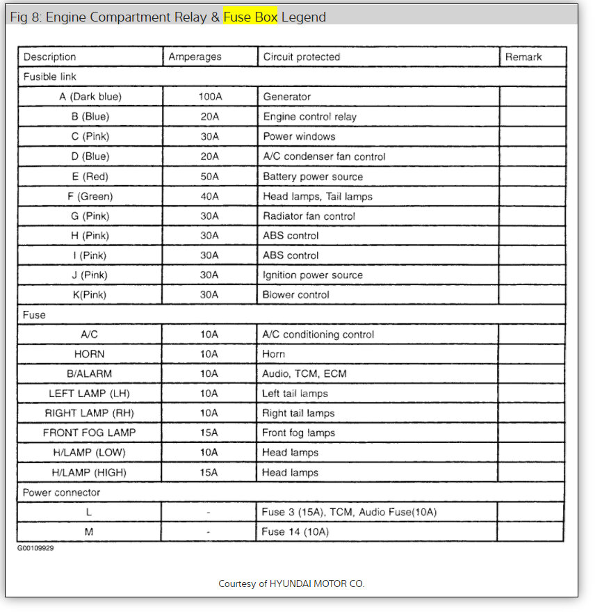

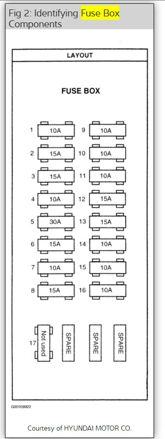

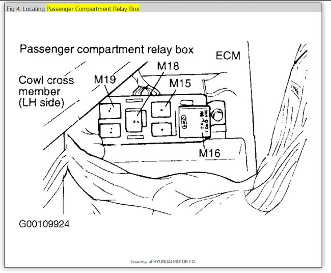

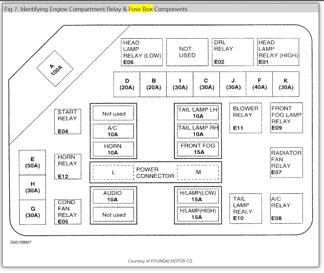

It sounds like it popped a fuse let's check all fuses. here is a guide and I have provided the fuse locations in the diagrams below:
