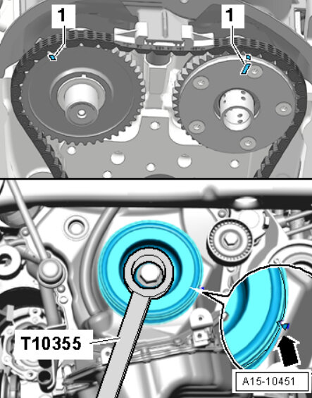

The timing chain looks good so I don't think it jumped, I have seen the wrong weight engine oil hold the lifters up and cause this issue. Did the engine oil get changed recently? Here are the timing marks if you want to double check them. Let me know if the marks are on or not. The chain marks may not line up, just check the marks on the balancer and camshaft gears. Check out the images (below). Please let us know what happens.

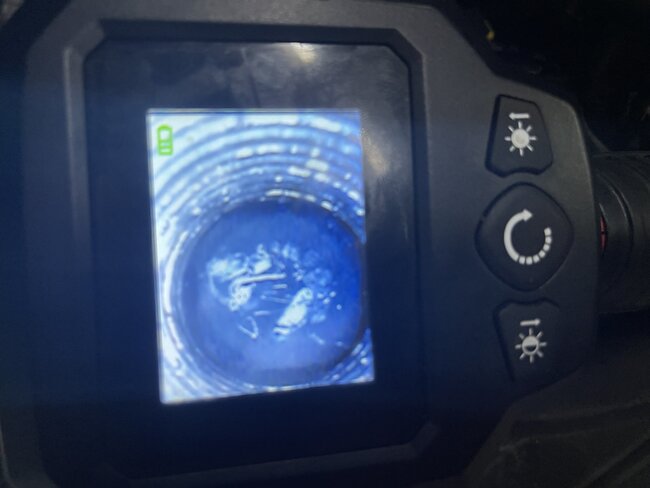

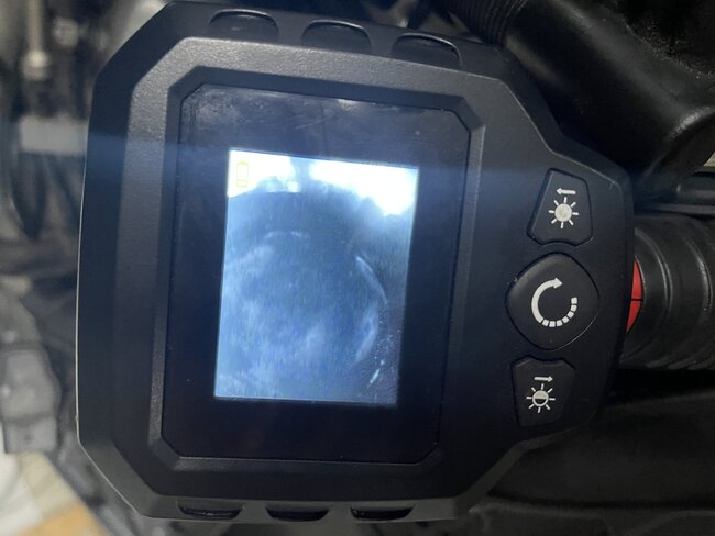

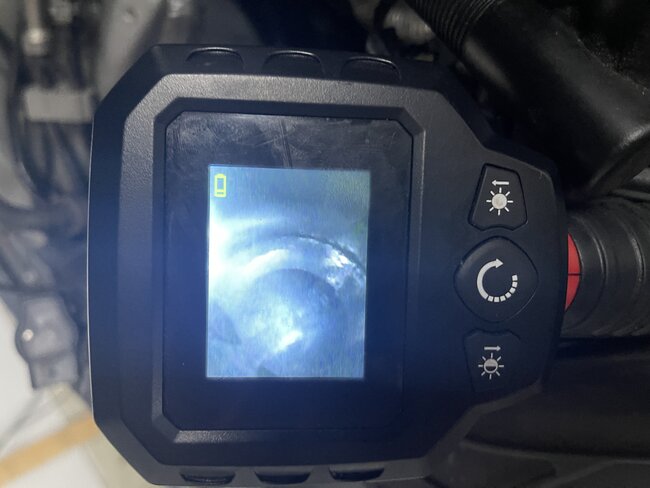

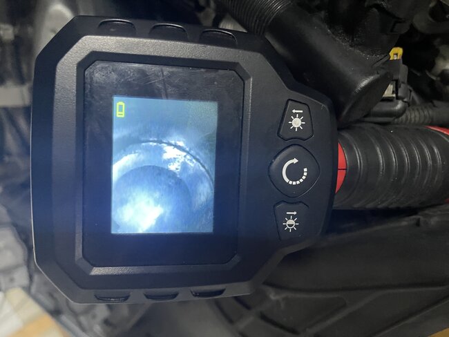

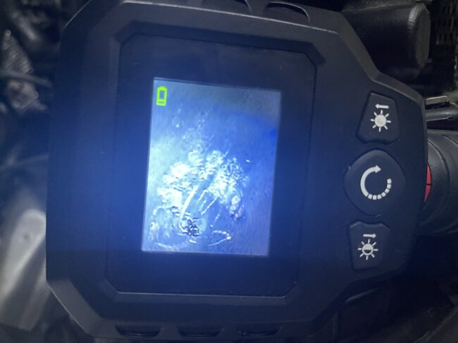

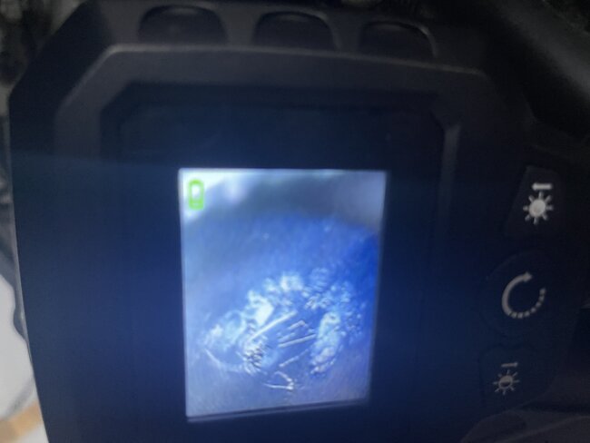

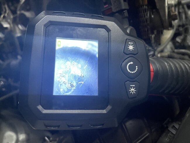

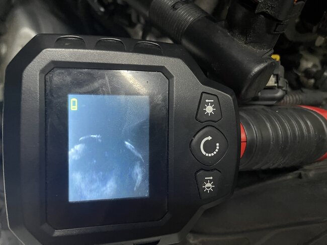

ya sorry I had an issue with one of the accounts so I tried the other account. Here are some pictures of the top of cylinders, not sure if you can see any marks at all for the valves. Only thing is that the first cylinder has some scratches from the screwdriver I installed IT to make sure its on TDC.

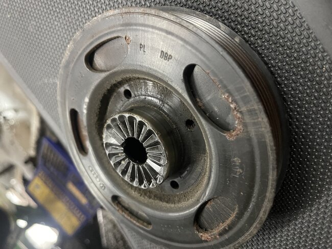

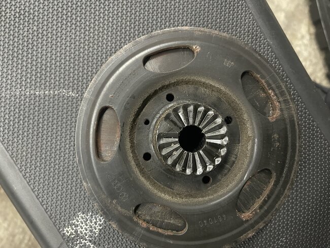

I son't know this happened, even with the tensioner still on but all the way cant believe it has stretched this much? I dont see anything broken or any gears stripped on the driveshaft gear itself.

WOW, that is a worn out chain or the tensioner is not working, good find. I would replace the timing chain kit which should come with a new tensioner and guides, replace them all. Was the engine making noise at idle ? It should have been lol. I would try to do a leak down test to make sure none of the valve got bent. Ken
