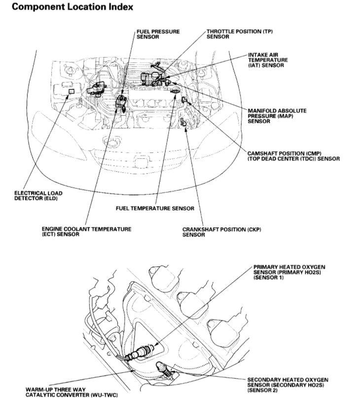

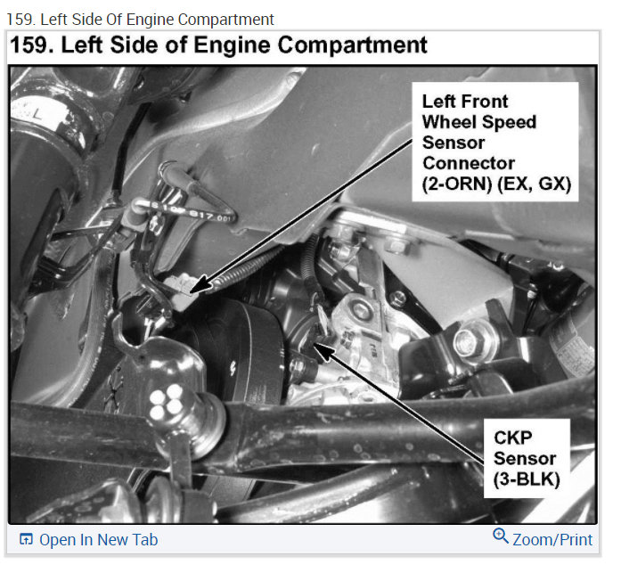

9 times out of 10 it will be the crankshaft angle sensor. Here is a guide to help test for spark and the location of the crankshaft sensor in the diagrams below.
Check out the diagrams (Below). Please let us know what happens.
