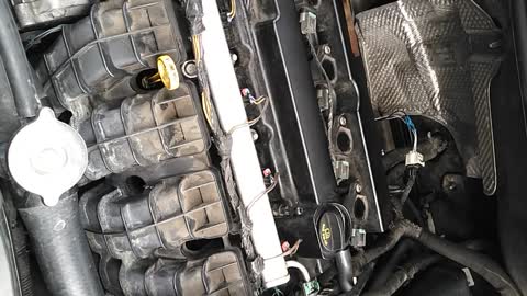

Hi, I am working on the vehicle listed above, the problem is it was making this rumbling, choking type sound when turning the ignition key, and when it did start up it has a really really bad noise and shaking idle, just for a few seconds then it shuts off. The owner had took it to two shops and could not have figured out the problem. I checked the spark plugs (owner had changed them 3 months ago) had a lot of carbon, I clean them,I check a vacuum lines,replaced crankshaft position sensor,clean all connectors, changed the drive belt,oil change,checked all fuses and relays. I even used starting fluid to help it start up. what can it be?

Hello, are you hearing any mechanical type noises when it's running? I've seen on these Compass's the rock arms popping of, due to build up in the hydraulic lifters, did you do a leak down test yet to see if any cylinders are sealing correctly. I guess these are prone to this happening due to lack of oil changes. If you pop the valve cover off you may find a couple rocker arms loose or popped of completely.

No I haven't done the leak down test yet, that was gonna be my next move. Did you see and hear the engine running on the video I sent? If so that's all the engine does sounds smooth but then in seconds you hear it rev up n down for another couple more seconds then just shuts off just like in the video. Actually I was working on removing the valve cover but seeing that it's hasn't been moved since he bought it and it's made out of plastic I didn't want to crack it because it's really stuck on there.

Yeah, it sounds like it's hunting for the correct idle, so I would suspect a vacuum leak for the idle, but that abrupt shut off is of concern. But the starting fluid keeps it running? Sounds like the fuel pump isn't keeping up. May be very weak and on its way out. If you have an amp clamp, fuel pumps usually run 6-9amps. See if it's dropping out. you may be dealing with a vacuum leak as well.
