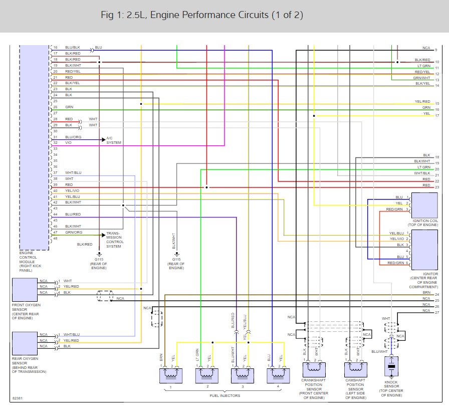

The spark must be at the wrong time is the only thing that can stop it from starting. Anyway this can be? Crankshaft trigger in the wrong place or? Can you take a picture of the crankshaft sensor?

I was wondering that same thing. I've changed the igniter with 3 others and still won't start. The crank sensor is in a fixed position, same with the cam sensor.

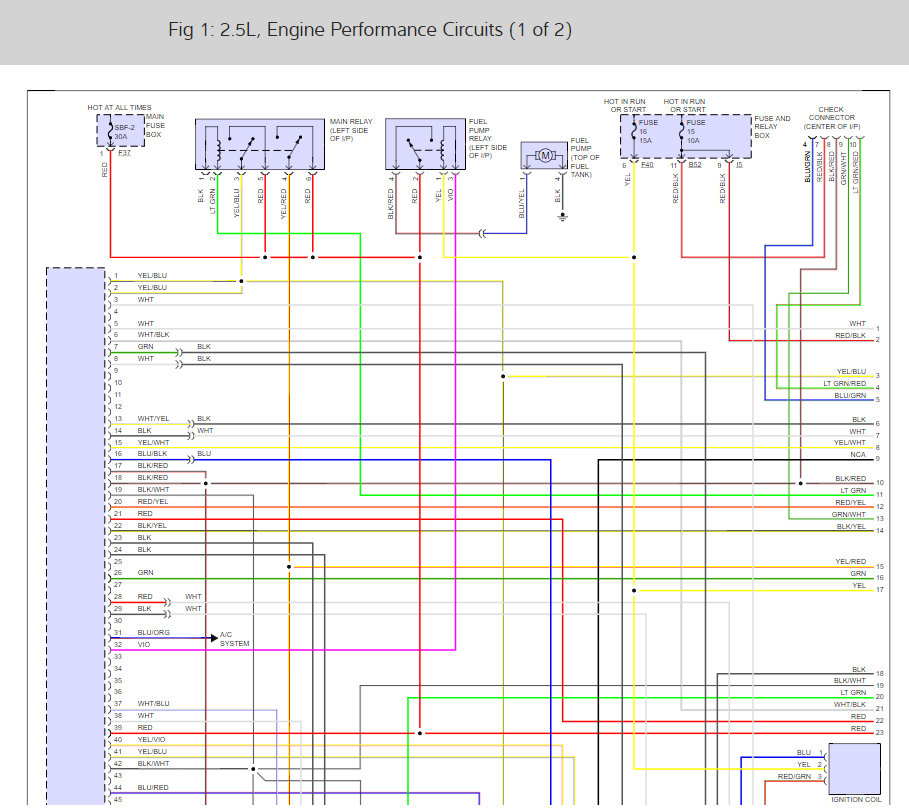

I am thinking a ground wire could have been left off for the computer wiring harness. Can you double check that all engine grounds are tight and secure please?

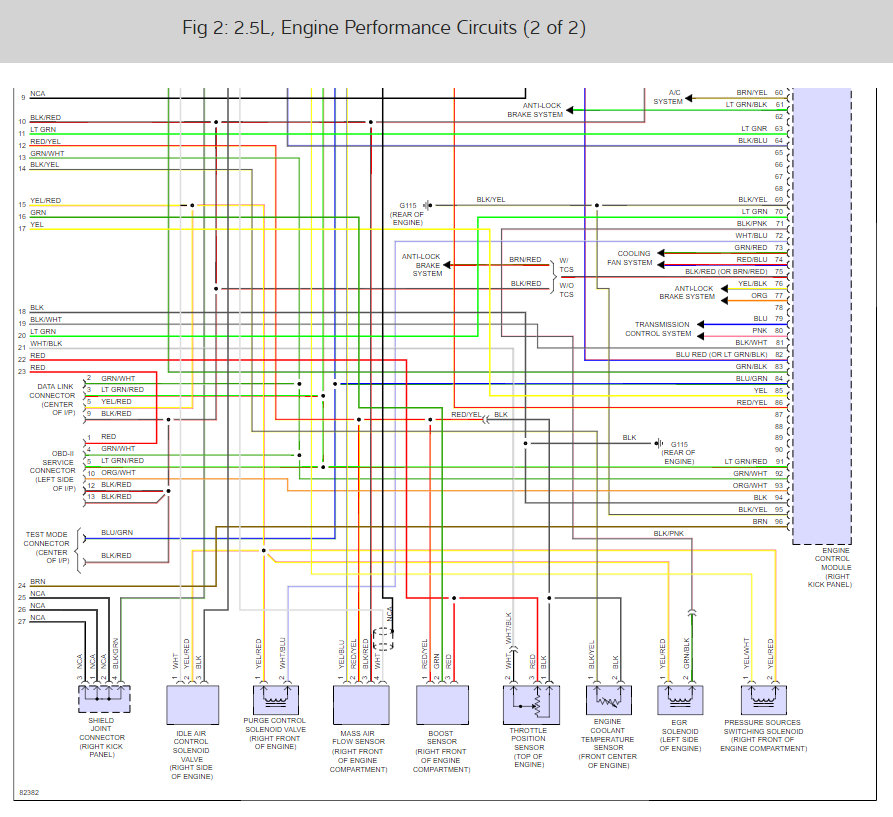

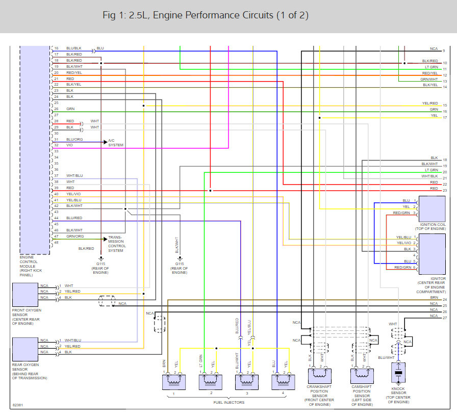

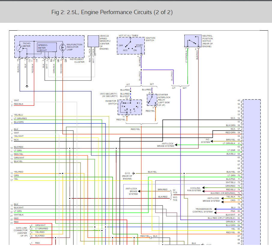

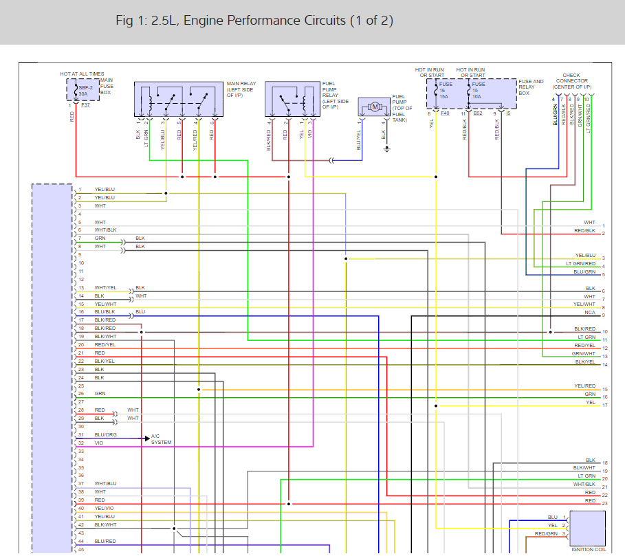

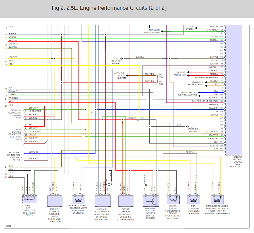

It sounds like you could of had a voltage spike that affected the ECM and fried the coil drivers but first lets check the wiring to the ECM power and grounds to make sure it has them all. here is a guide and engine wiring diagrams so you can confirm.

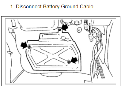

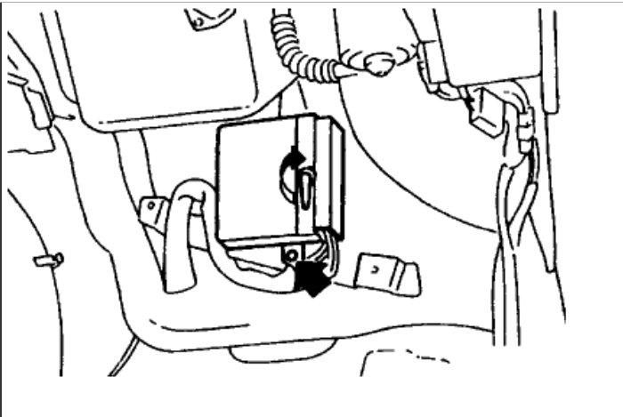

Can I put another ECM in my car to test to see if that's the problem? From another 1996 outback legacy.
Jan 18, 2018 at 7:01 PM
Yep you sure can, here is the location. Let me know what happens have a good weekend. ;)
