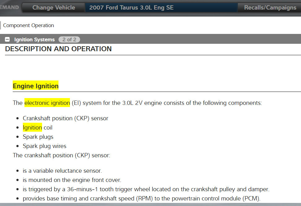

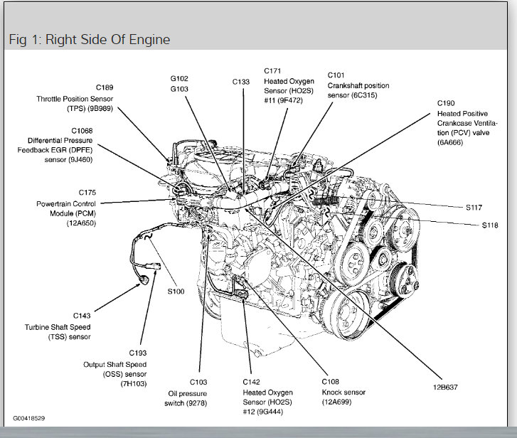

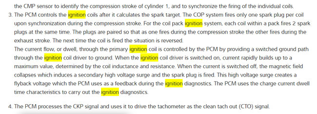

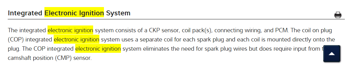

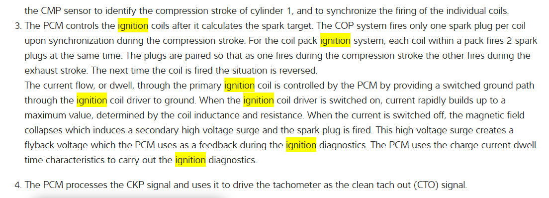

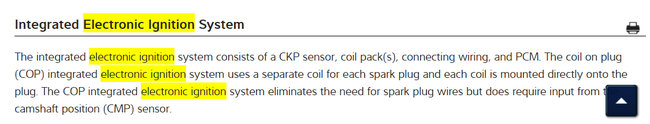

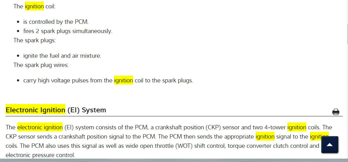

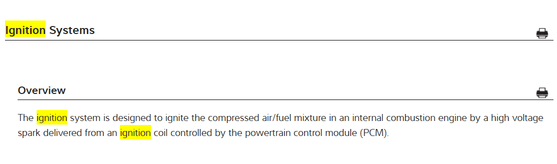

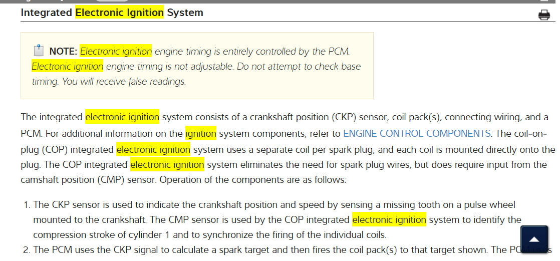

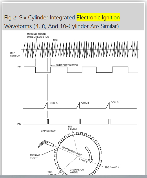

This could be a problem with your vehicle's Crankshaft Position Sensor (CKP). It is used by your vehicle's Power-train Control Module (PCM) to keep track of where the engine is in its four stroke cycle. If the PCM doesn't get a signal from the CKP then it will not fire the spark plugs or start.

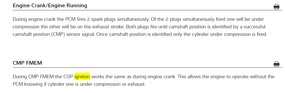

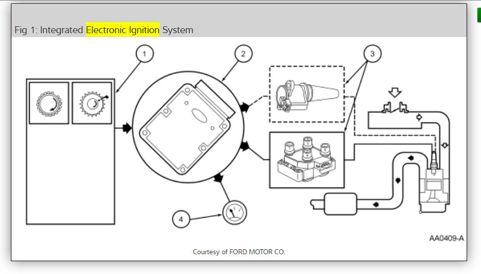

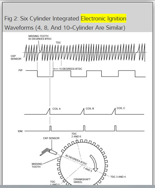

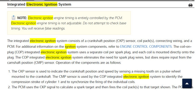

I have included a diagram of where the CKP sensor is as well as a description of how your vehicle's ignition system works in the diagrams down below. I also have included a few links below for you to go to:
https://www.2carpros.com/articles/how-a-crank-shaft-angle-sensor-works
Please go through these guides and get back to us with what you find out.
