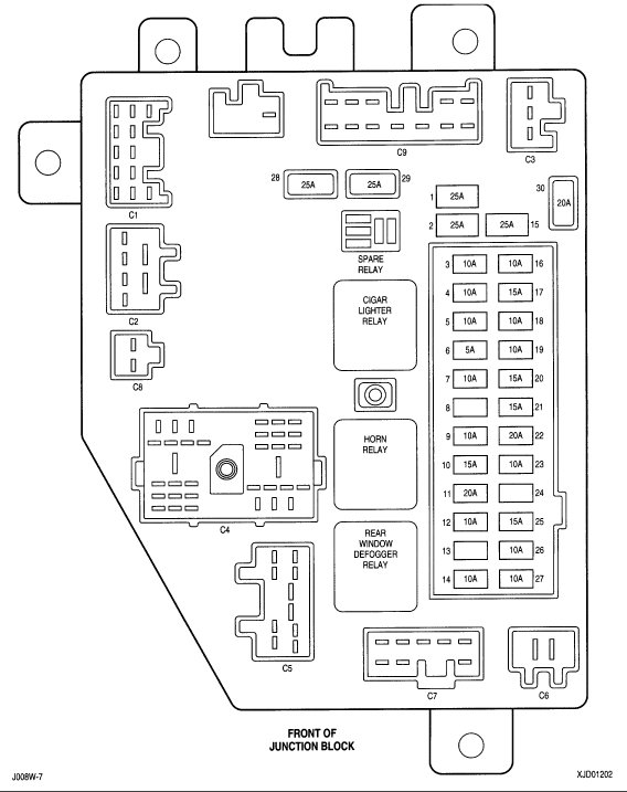

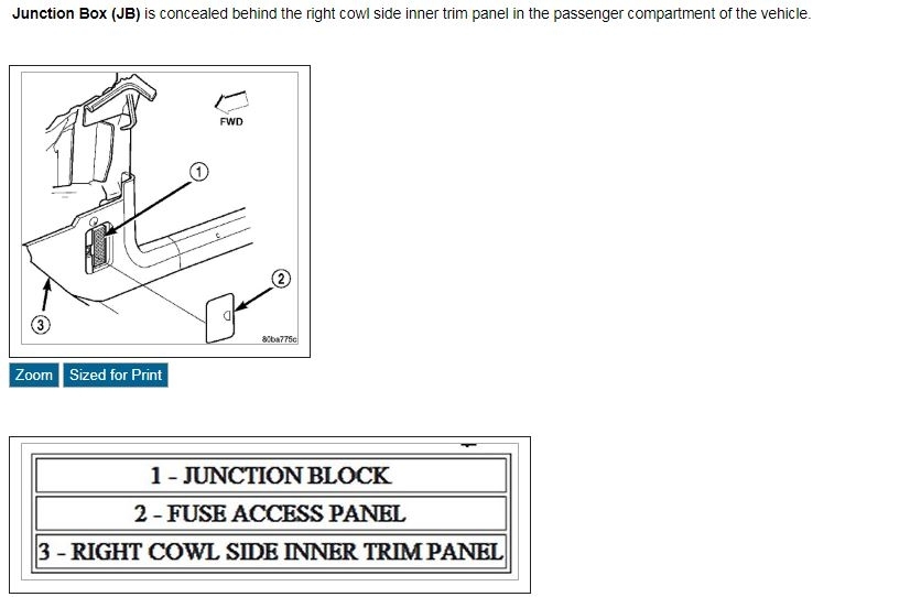

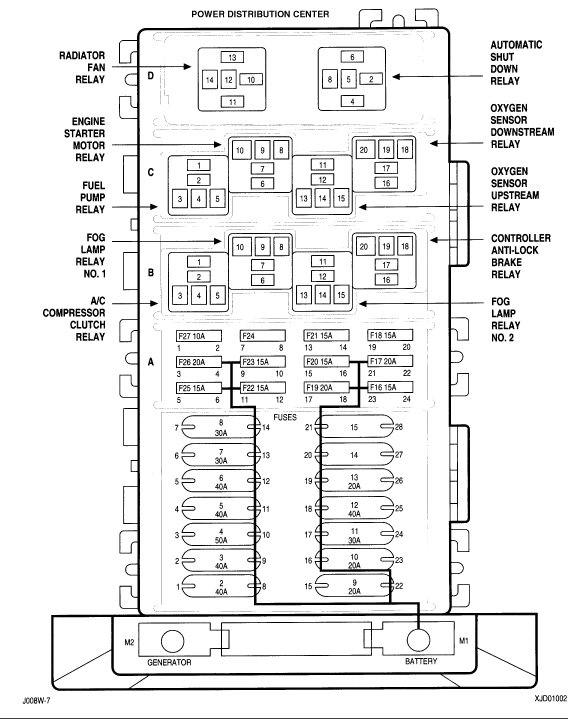

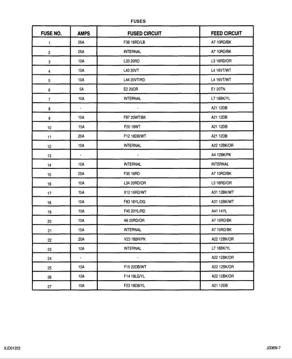

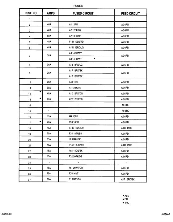

If you still do not hear the pump come on, then you need to check the fuses. There are fuse box diagrams attached below. The first fuse box to look at is the power distribution center, which is under the hood, right behind the battery. In particular, look at the fuses for "fuel pump", "ECM/TCM," "PWR Train," and "ENG Ign." ALLData's description (slightly confusing) is in the last image attached below.
