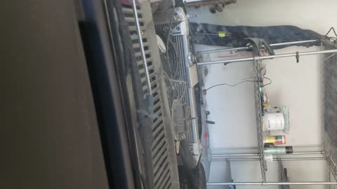

My pic shows the test process, the pic is showing a mechanical pump (pic I had on hand).

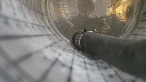

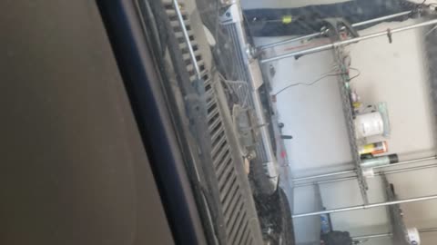

I honestly couldn't remember if you said 15 or 30 seconds so I did 15 and recorded it. It did 8 fl oz in 15 seconds so 16 in 30 which is a pint. I've attached a video as well.

Fuel video.

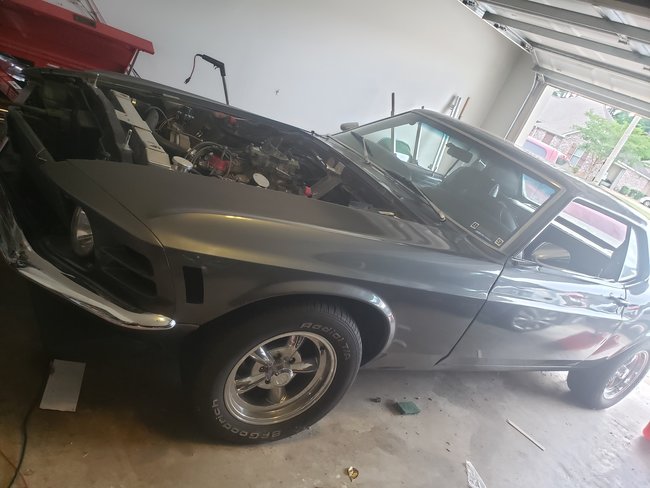

Still no pic of yours!

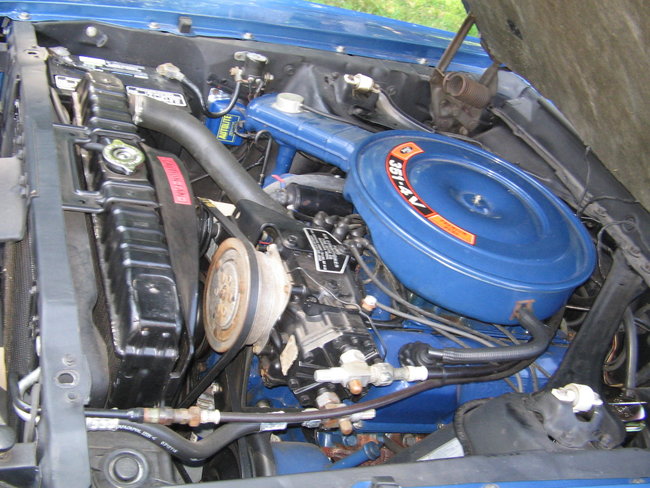

One of my Jeep buddies (he has a 1942) drove his 1970 Mach 1 over yesterday so we could charge the A/C. It will never compare to a having a Jeep!
The Medic
Jun 20, 2020 at 7:24 PM
JOSEPH KYLE MOORE
  • 11 POSTS
I swear I added it on the earlier post, lol might not have took. I love the blue on his.
