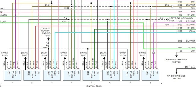

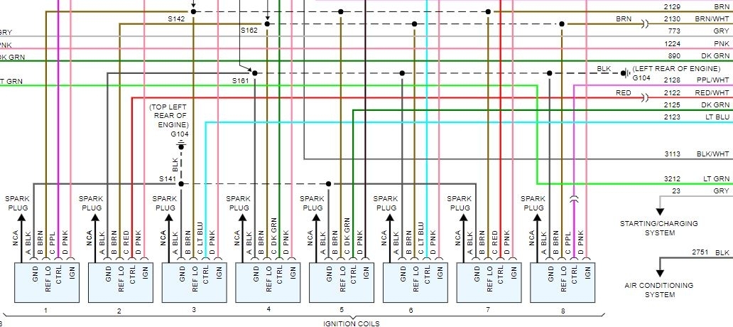

Now, if you find there is no spark, I think I know what is wrong. All of the coil packs have a common ground. The ground wire is black and is part of the wiring harness on the intake for the coil packs. The ground location is on the top left rear of the engine block. See the schematic I attached:
Locate the ground and check it's condition. Don't be surprised if the connector falls apart when you move it. Also, although the ground may be bad, it can still show continuity when checking. However, the ground can no longer take the current needed to fire the coils.
If you find the wire is good at its mount on the engine, work backwards from that point. If none of the cylinders are firing, it may be broken between the mount and the first coil pack splice.

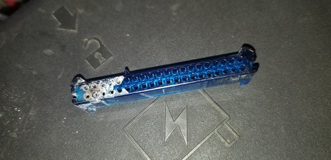

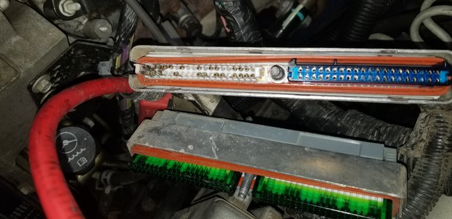

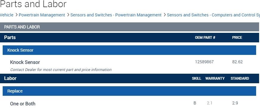

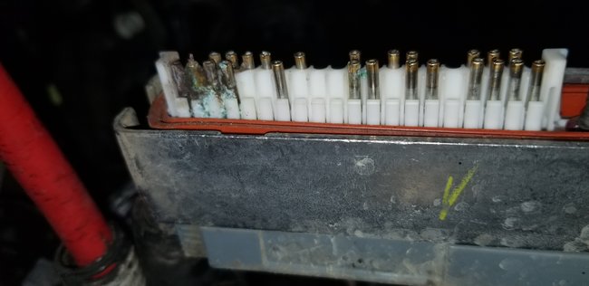

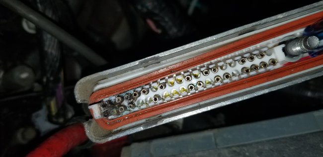

Thank you guys, I checked out those areas you recommended and all checked out good. I just gave up and took truck to dealership and had them check the vehicle and they found wires corroded in PCM due to water. When they removed wires going to computer they also found pin broken from PCM. I'm currently waiting for the repair to be done. I'll keep you posted of the outcome. They told me that when you get codes for knock sensors you need to replace them right away because more than likely they have water due to their location. They sit under the intake and absorb moisture and water. Total repair is close to $5,000.00. New PCM, new harness. I believe they said 18 hours of labor and around $2,000.00 in parts. I'll let you guys know the outcome. Thanks

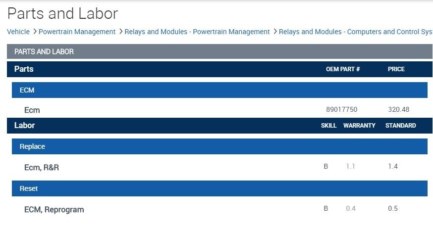

Wow. That's a lot. I'm not sure where you are located, so I have no idea of the labor costs. However, around here, I can't imagine it being more than $1,500.00.
I attached the flat rate hours for you to review and which also includes prices for the parts. Take a look at them and let me know if there is something I missed. I realize I didn't include a harness and labor to replace it, but.
Regardless, I'm glad it's getting fixed. Let us know if you have questions in the future.
