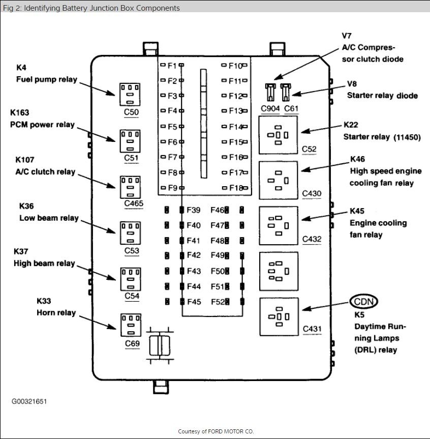

Now, let's move onto the no power to the coils, are you sure the key was on run?

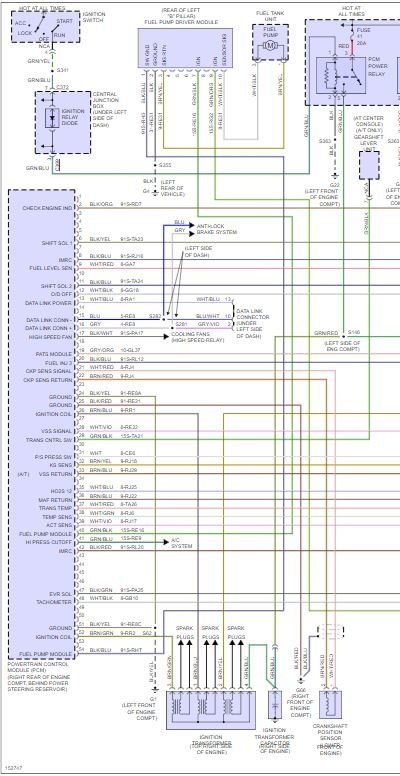

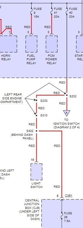

The ignition coils are fed from the PCM power relay and fuse 41,both in the battery junction box and the ignition switch.
Now about that 40a fuse, you never mentioned which fuse it was, was it #42?

Okay, first I did not put the jumper wire in an empty slot I know better than that, I put it in the fuse itself and then put the fuse back in its slot. Second it is a 20A fuse, that is my fault sorry I double checked that because I had 40A in my mind. And it is #40, but I get the point thank you. As far as the ignition coil pack, it is also a 20A fuse in #41 but it appears to be okay. I did pull it and checked the circuit with my test light and it had power. Yes I had the key on, the dash lights came on as well as the radio. I will go out and check again to make sure I did not miss anything.

I still do not understand though about this jumper wire. If you are jumping across the fuse whether or not the fuse is in, the possibility still remains that you could burn something up.
Remove that PCM power relay, check the prongs in the empty socket and make sure one is hot all the time and then an additional is hot when the key is on run/start, that comes from the ignition switch.
It just so happens the ignition switch is fed from that #40 fuse in the BJB, so it appears that may be the problem since that fuse keeps blowing.That fuse #40 feeds several things, including the ignition switch, light switch and a fuse #26 in the central junction box, so I would first remove that fuse #26 and see if that fuse #40 stops blowing, if not, disconnect the harness plug at the light switch and check again, lastly the harness to the ignition switch to figure out where the short circuit is first of all.

The jumper wire is in #41 fuse not #40. I still do some things old school or pre- computer. But I will go try this new information an see what happens. Thanks

Okay, I did pull the PCM power relay R2 and tested the prongs in the empty socket, but #3 came up hot with out the key and #1 only went hot with the key on. pretty much the exact opposite especially when the diagram on the side of the relay shows #3 as the switch side.

Okay, the fuses' tested okay, and you had voltage in the empty relay socket, so now put your finger tips on that relay and feel if it clicks or not when the key is turned to both start and run.
If not, then you may have a faulty ground from that relay, but if it does click and no voltage still to the coils, check if voltage is making it to the coils and if not, check along that green/blue wire to find the short/open.
