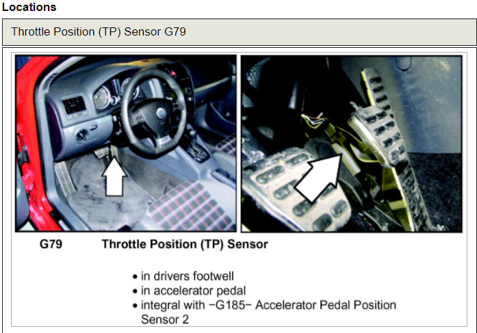

The P1639 is the clue. I would replace the throttle position sensor on the gas pedal a used one will be fine. Once you have replaced the sensor clear the codes and retry the car.
Check out the diagrams (below).

Thanks for your reply reply, just to confirm, the the TP sensor sits in the pedal itself? Or is it the plug(wiring) that plugs into pedal?

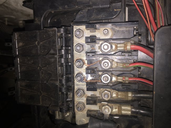

I have taken a picture of the battery last night I noticed that on the battery where all the connections are, there is about three of the plates that no more makes contact but looks like the previous owner just connected it with a copper wire. Any idea what these are for? As in what is connected to it?
See picture attached.
Feb 20, 2018 at 9:39 PM
Oh man, yes you should not have them like that because it is a fire hazard. It looks like the second one from the top is broken? I would replace these with new and see what happens from there.

Is it hey? Well then it has to be done fast.
I actually phoned Goldwagen and battery Centre to try and get the metal plate where I turn the 10mm bolts onto. Apparently they are so scarce and I should make my own using copper. I have made them all make contact with each other with the copper wire. but as you say, I should try to get that plate first.

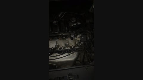

Morning Ken, see attached video. This time around it sounds a bit weirder than before. Let me know what you think? Thank you.
Feb 21, 2018 at 8:55 PM
Looks like you are not getting fuel into the engine. Lets do a fuel pressure test to see what you have.

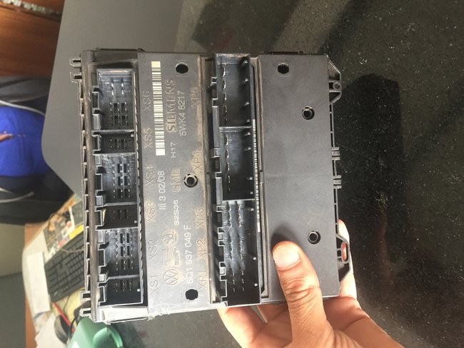

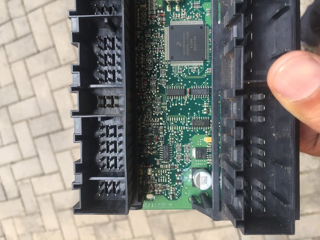

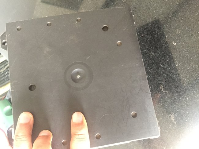

Apparently my comfort control module has blown? Says water went into it and that’s the reason the car is not starting or doing whatever it’s doing? No idea how water went in there?
I have attached a picture of what this unit look like. Please reply with your thoughts.

Water in the module will definitely cause the issue. So they replaced it and now the car runs? I would make sure water can get to the new module do you live in rainy weather? Make sure the car is sealed up tight.

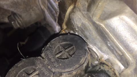

Furthermore, I noticed a water leak coming from something that Sits just behind the thingy that the plug leads come out of? I don’t know if that’s the coil? But the leaking thing is behind what I think is the coil. (Video attached) please tell me what this is called and how the leak can Be fixed?
This trial and error is killing the pocke but I guess there’s no other way.
Look forward to hearing from you again.
Feb 28, 2018 at 7:45 PM
I will be glad to help you but because this is a different issue we must start a new thread.
Please copy and post your question here and re-upload the video please.
