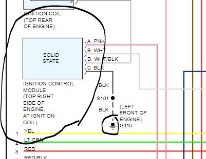

As far as the ground, I am so sorry, I was a year off. Different design on this year. Here is what I need you to do: When it doesn't start, see if starting fluid will do the trick, at least for a couple seconds. If no response from the engine, then it is ignition related. I realize it has good fuel pressure, but it could be losing an injector pulse, so I really need to know if that is the case.
If there is no spark, then I suspect either the ignition control module is bad or the crankshaft position sensor.
I attached a picture of the control module so you can check to see if there are any wiring issues.
Aug 9, 2019 at 8:18 PM
