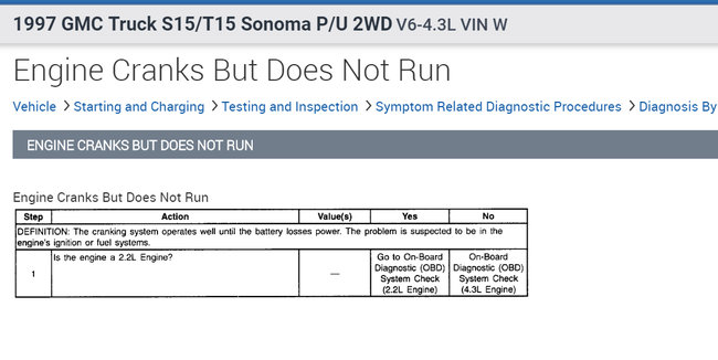

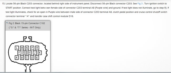

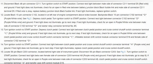

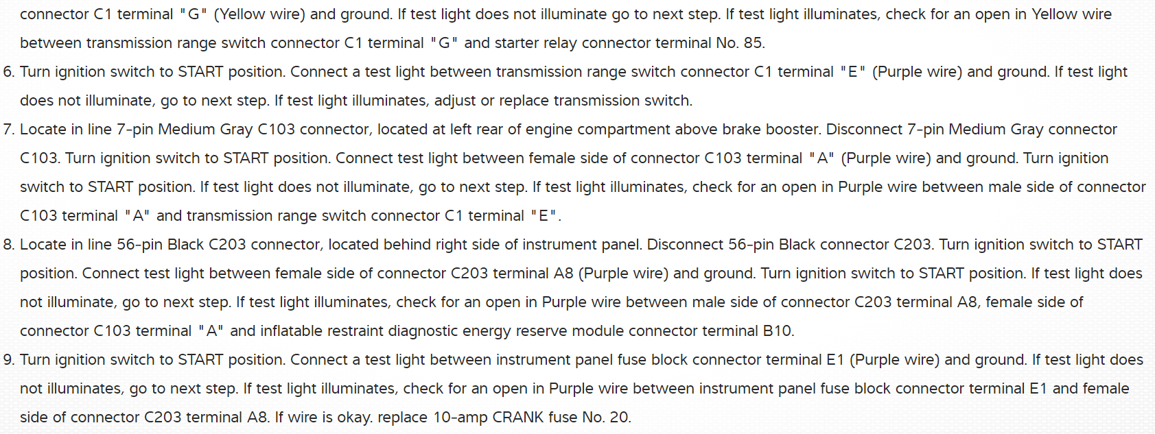

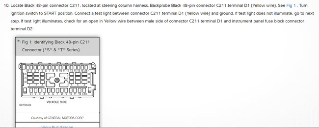

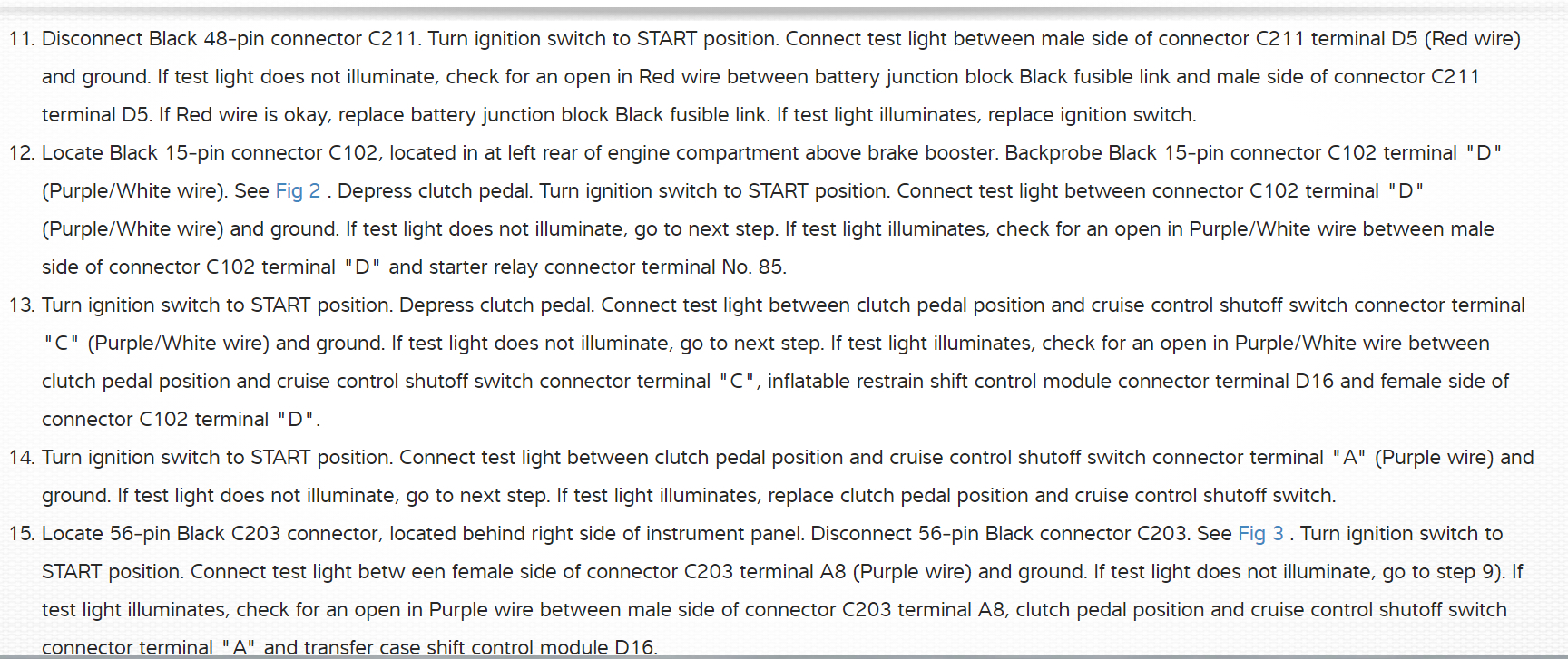

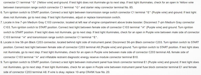

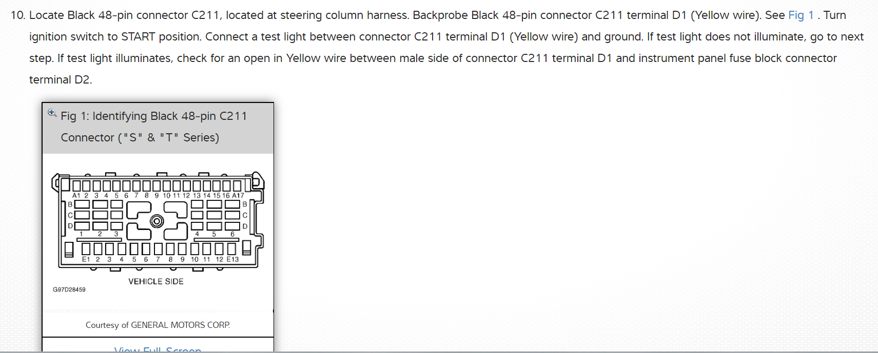

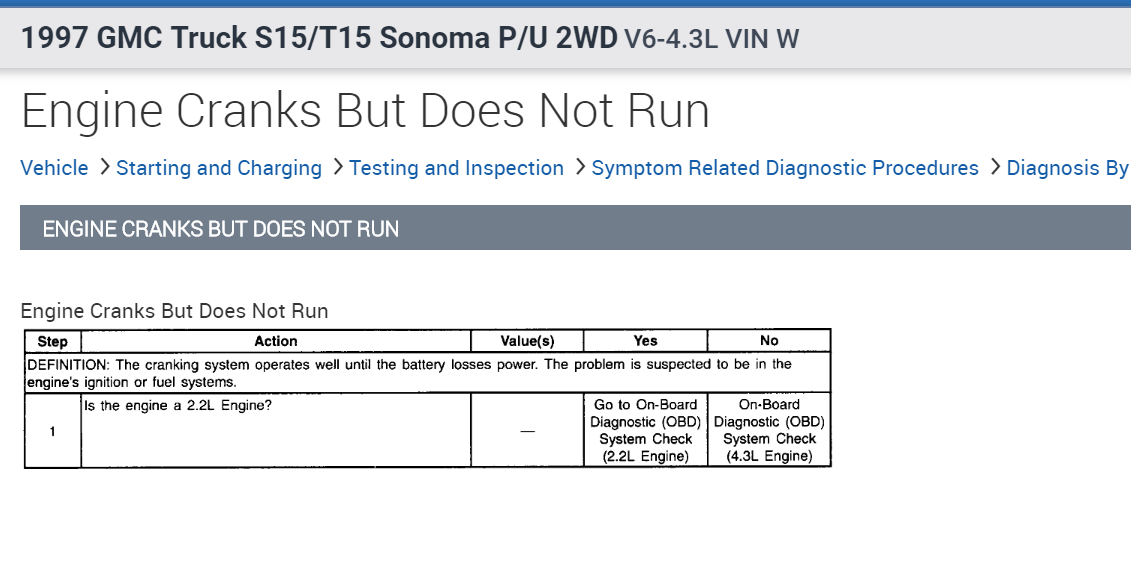

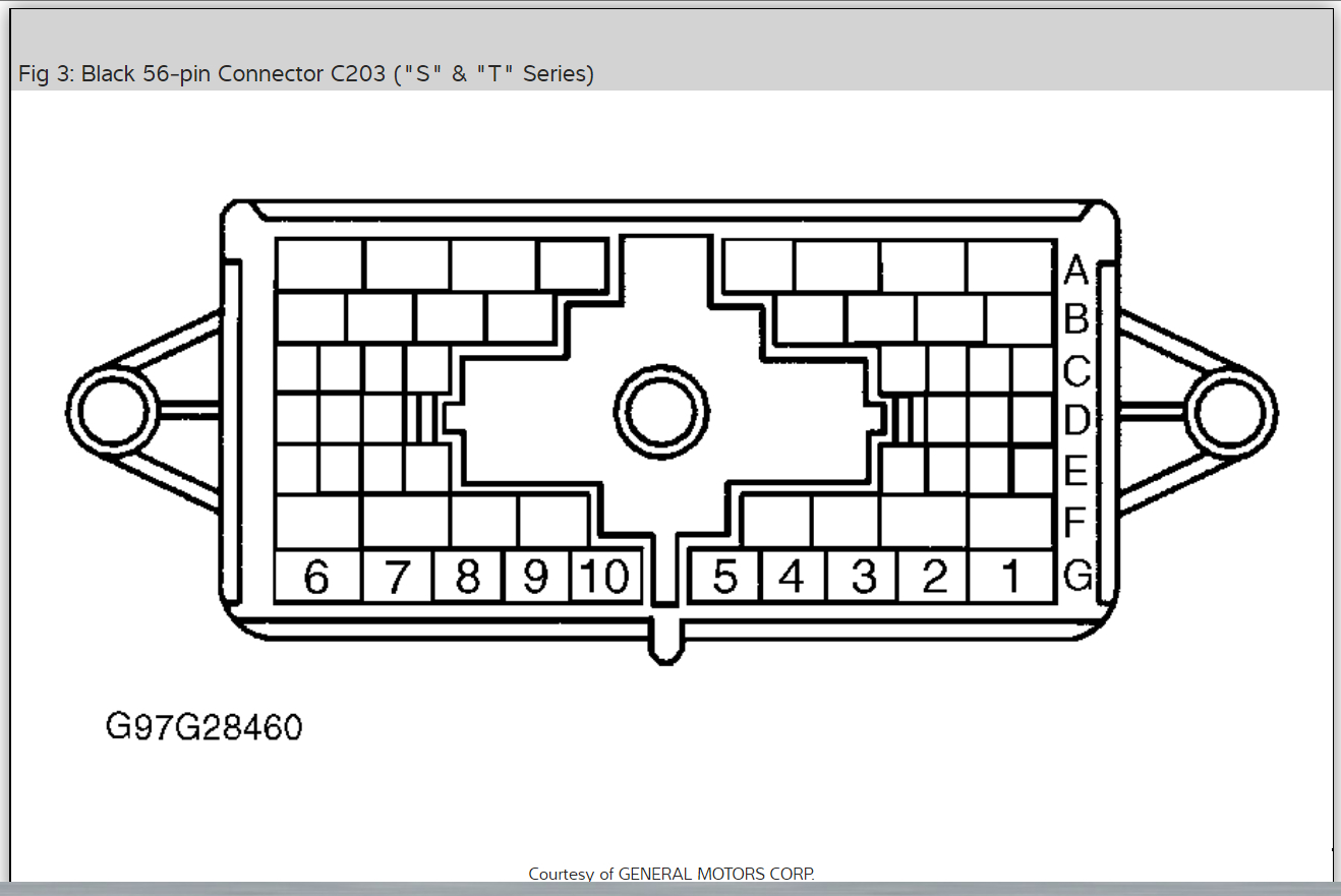

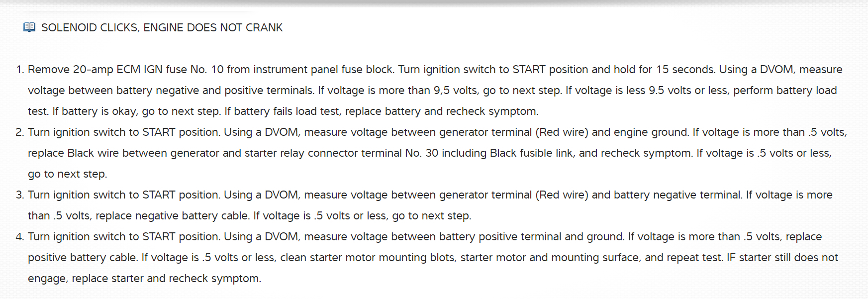

This sounds to me like it could be a wiring problem coming the Powertrain Control Module(PCM) a.k.a. "computer". Having said that, I have included for you, a troubleshooting guide from the vehicle manufacturer for you in the diagrams down below. Please go through it and get back to us with what you find out.
