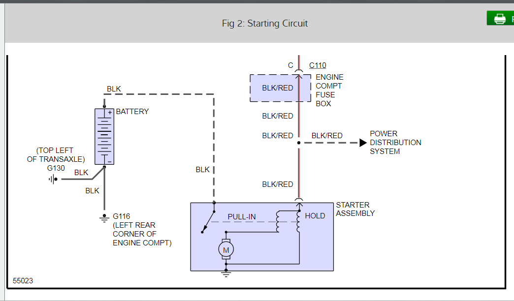

I have a my car built as a race car but my motor is completely stock 1.8. I installed the motor now it won't start. I checked for spark, and fuel, I found out I have to wiggle my ignition switch to even get connection to start it. It's cranking strong but won't start and run. I was told it could be my ignition switch or ignition coil. after a little bit trying to start it I lost spark from the ignition coil. Could it be my ignition switch?

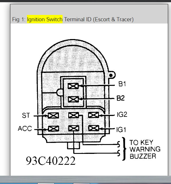

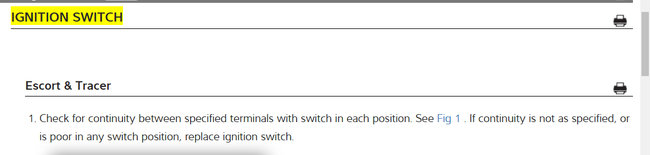

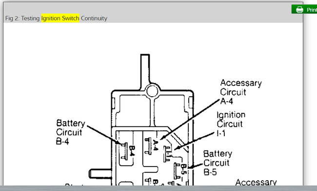

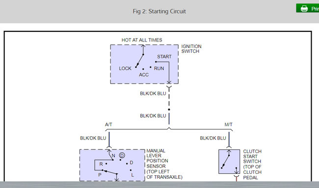

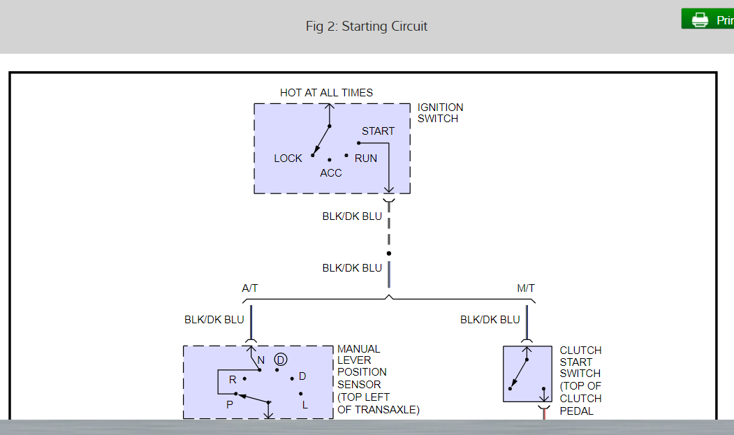

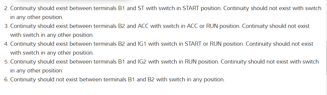

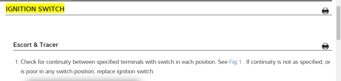

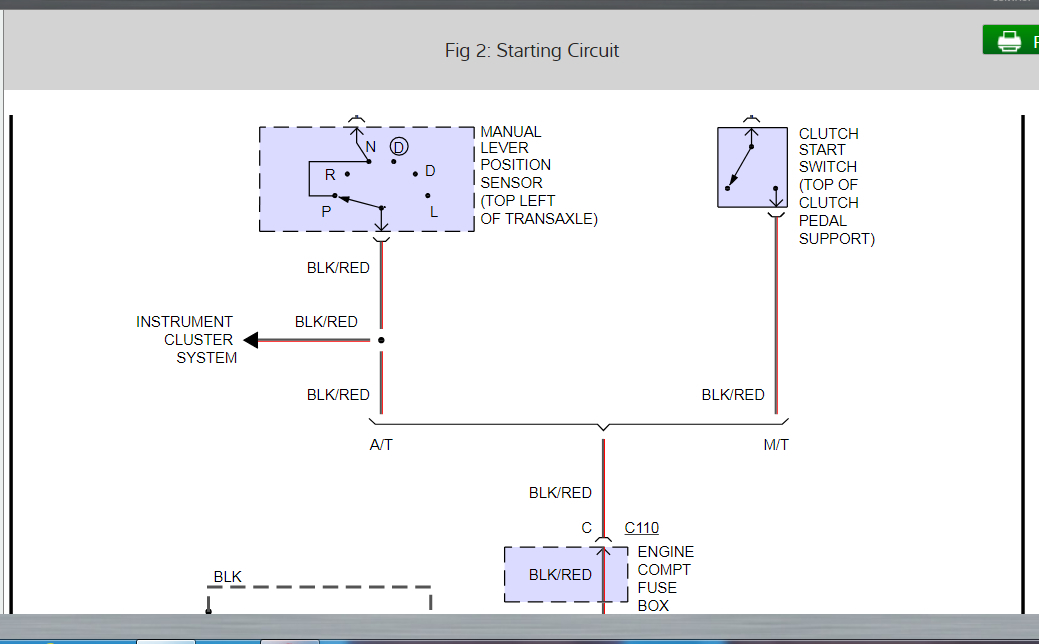

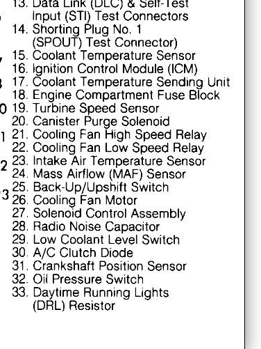

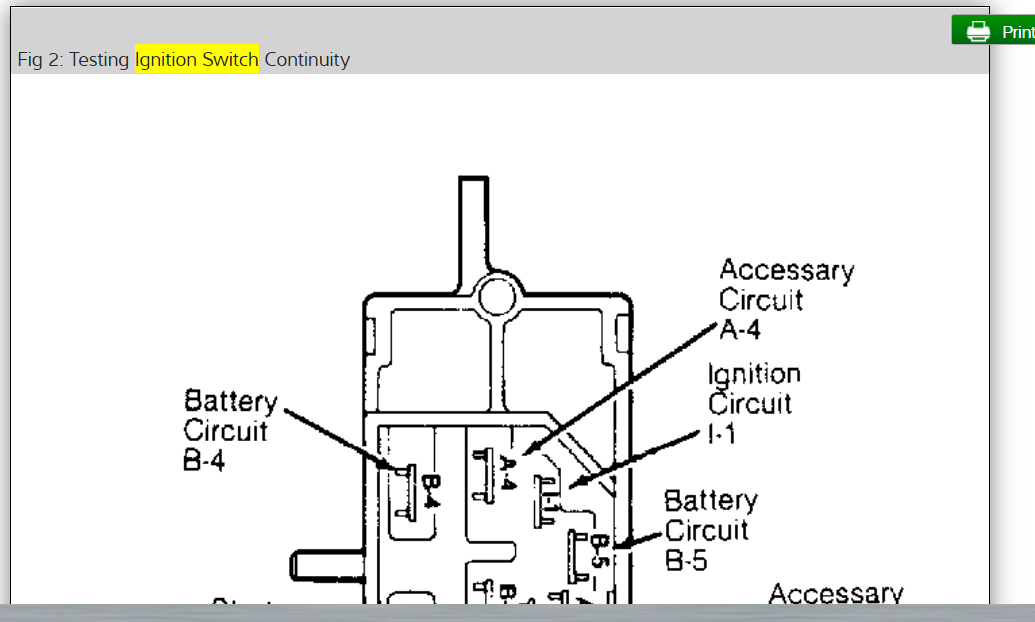

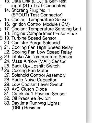

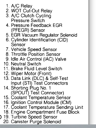

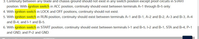

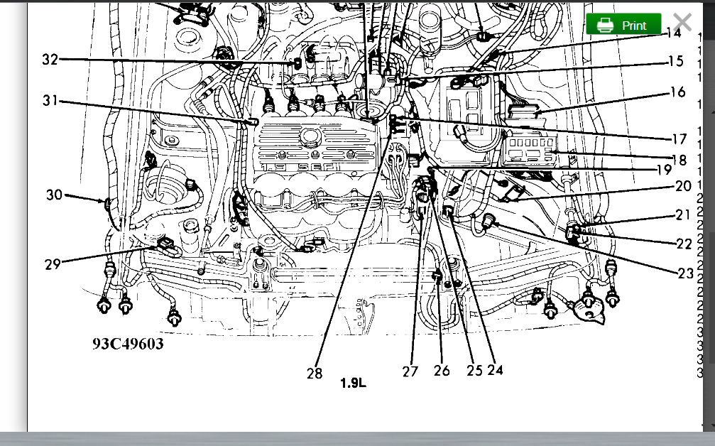

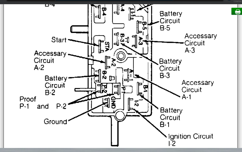

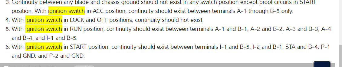

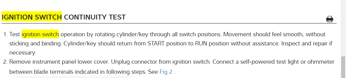

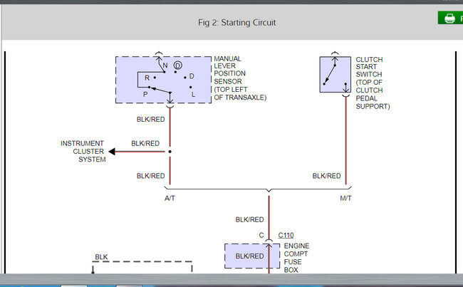

It absolutely could be, but not if your engine is cranking. The ignition switch just allowing electricity to pass through it to the starter solenoid, so if your engine is cranking then the ignition switch is probably good. You can see this in the wiring diagram I have included in the diagrams down below as well as the factory troubleshooting guide for the ignition switch I through in just for good measure. I would check your vehicle's Crankshaft Position Sensor (CKP) which is located in your vehicle's distributor. The CKP sends crankshaft rotational information to your vehicle's Power-train Control Module (PCM) and the PCM won't realize that your engine is trying start so it will will not fire the spark plugs are turn on the fuel injectors. I have included a few links for you to go to below:

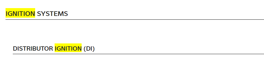

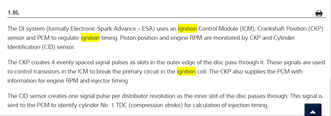

Okay, did you replace the CKP sensor? It is used by your vehicle's Ignition Control Module to determine ignition timing. I have included a description of your vehicle's ignition timing in the diagrams down below. Please go through it and get back to us with what you find out.
