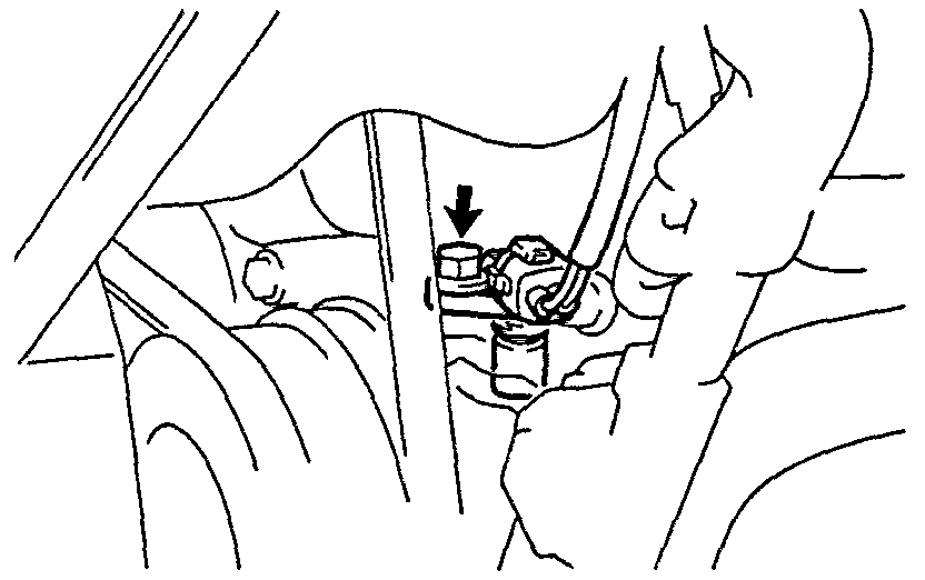

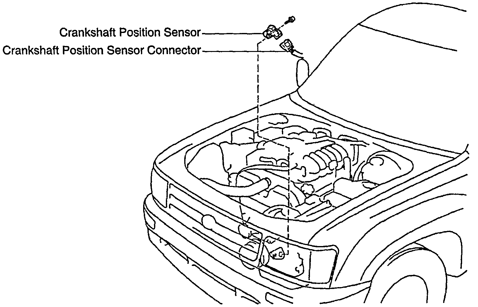

If you feel this could be the issue, here are the directions specific to your vehicle for replacement. The attached two pictures correlate with these directions.
COMPONENTS FOR REMOVAL AND INSTALLATION
REMOVAL
REMOVE CRANKSHAFT POSITION SENSOR
- Disconnect the crankshaft position sensor connector.
- Remove the crankshaft position sensor bolt.
Torque: 7.8 Nm (80 kgf.cm, 69 in lb)
INSTALLATION HINT: Installation is in the reverse order of removal.
