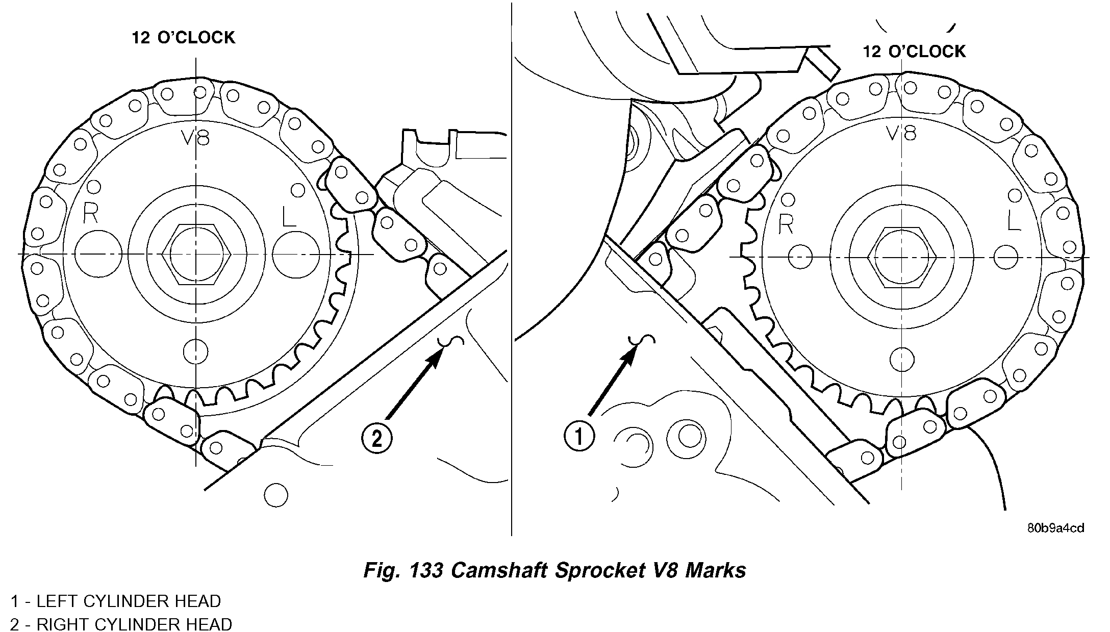

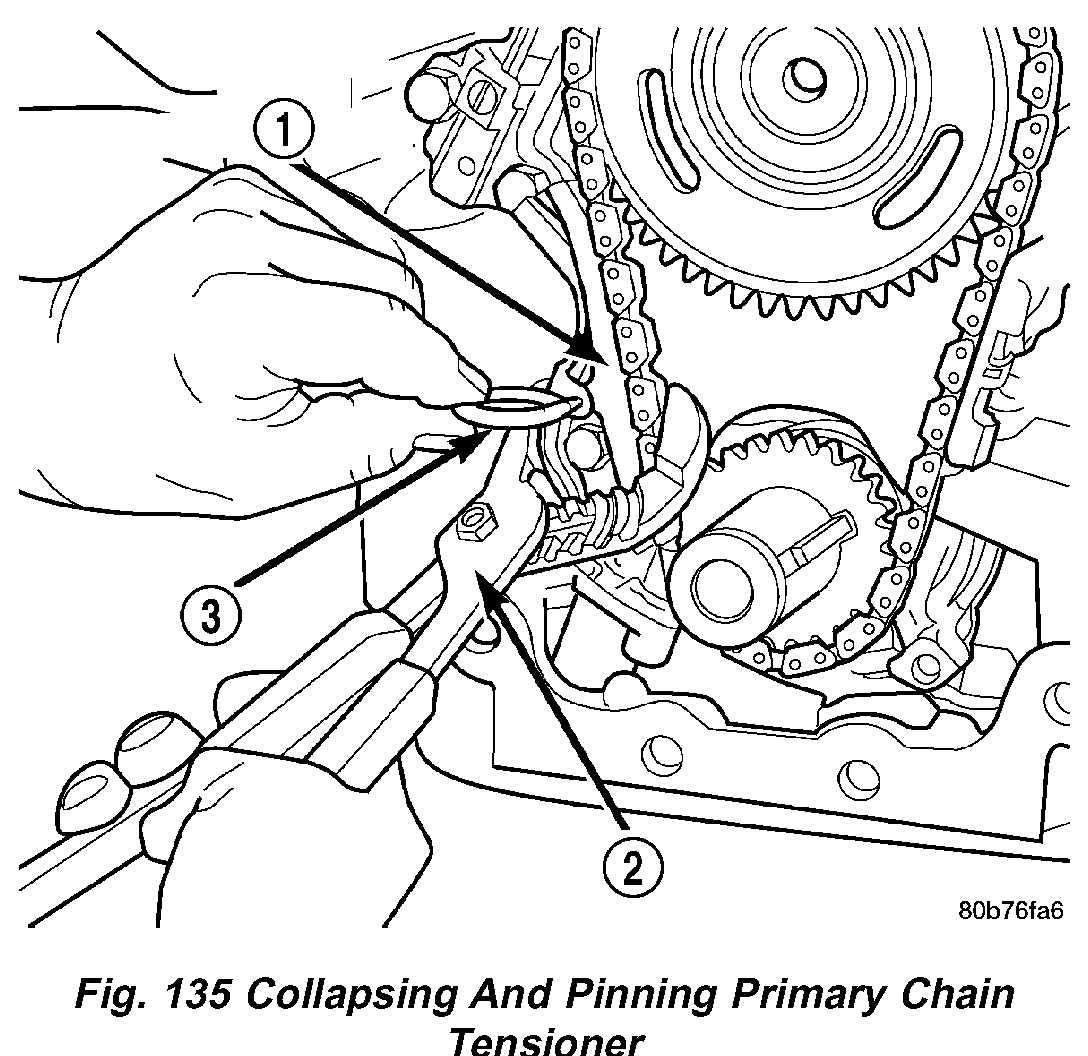

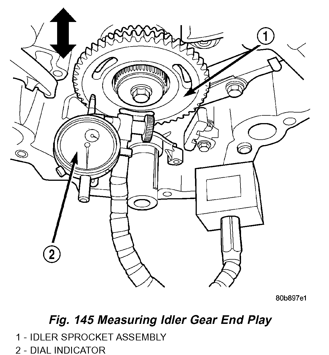

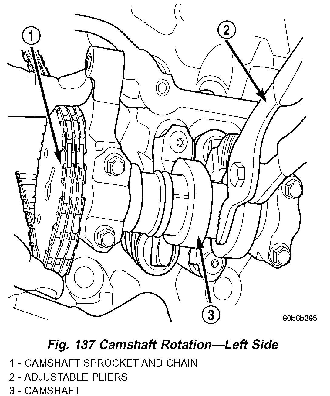

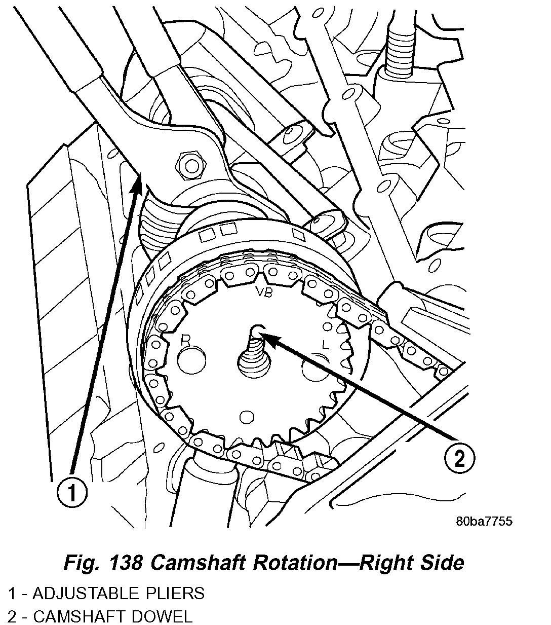

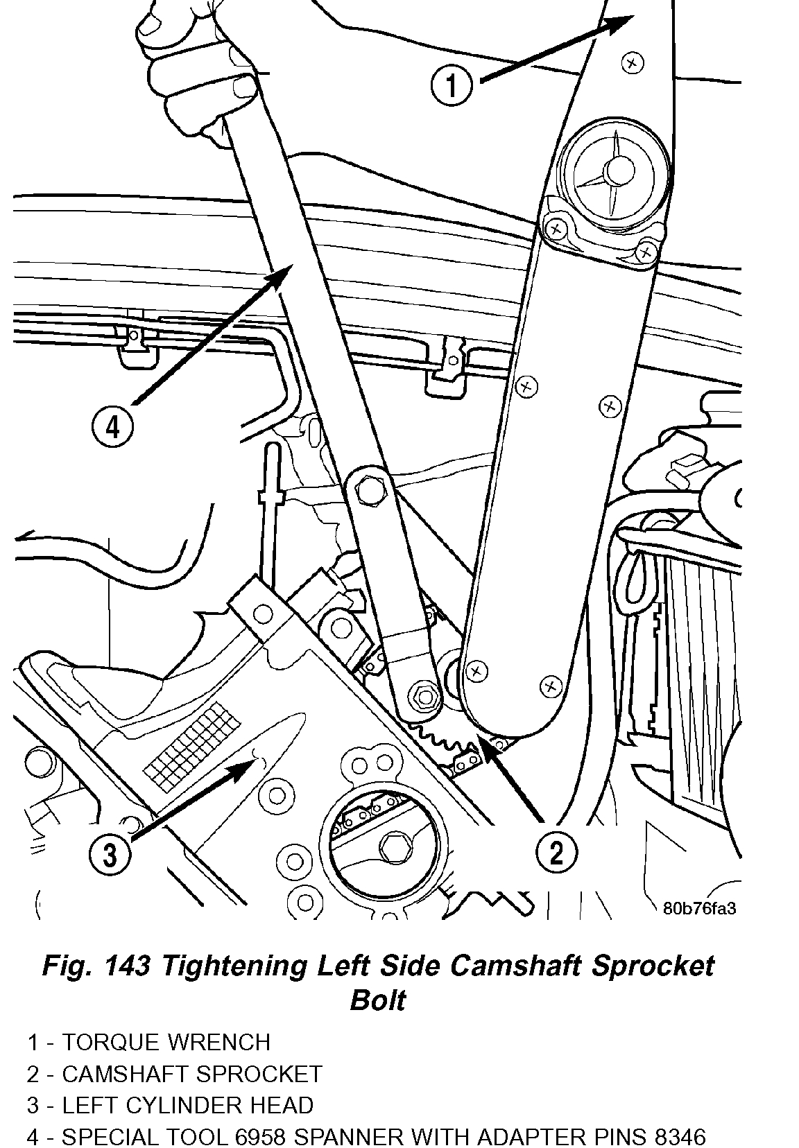

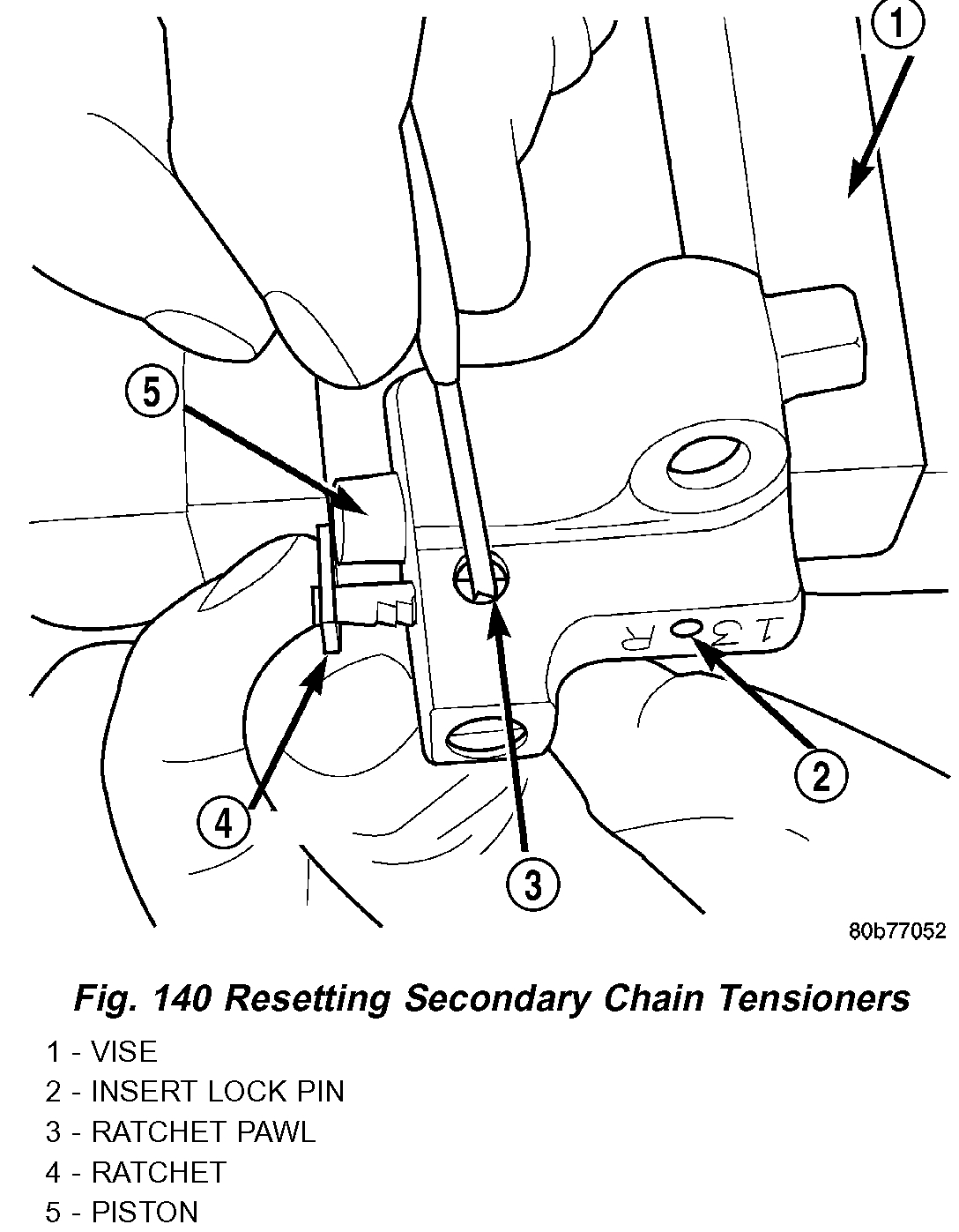

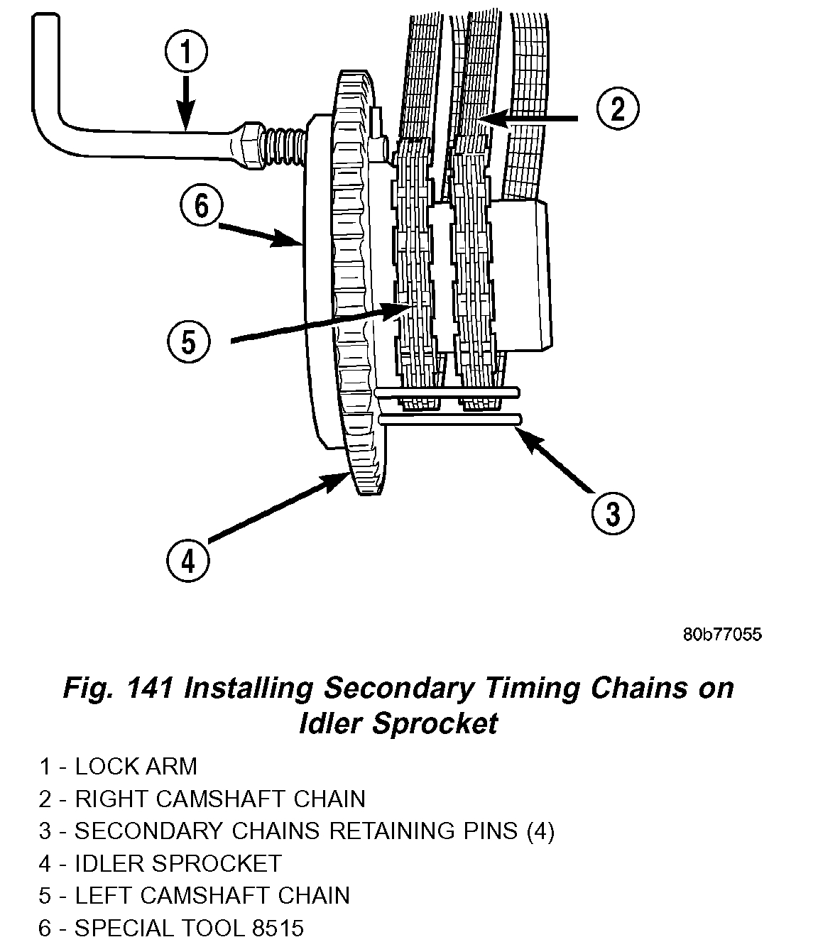

Is it possible for you to record it cranking so I can hear it? Based on your description, it may be timing. Here are the directions for the removal and replacement of the timing components. Take a look through them and see if it is what you did. The attached pics correlate with the directions.

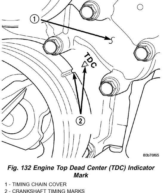

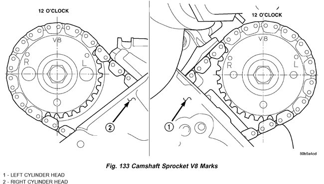

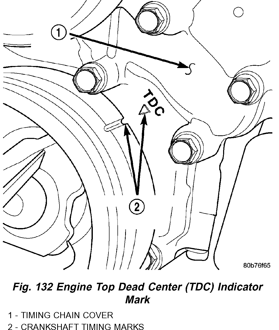

5. Rotate engine until timing mark on crankshaft damper aligns with TDC mark on timing chain cover (Fig. 132) (# 1 cylinder exhaust stroke) and the camshaft sprocket "V8" marks are at the 12 o'clock position (Fig. 133).

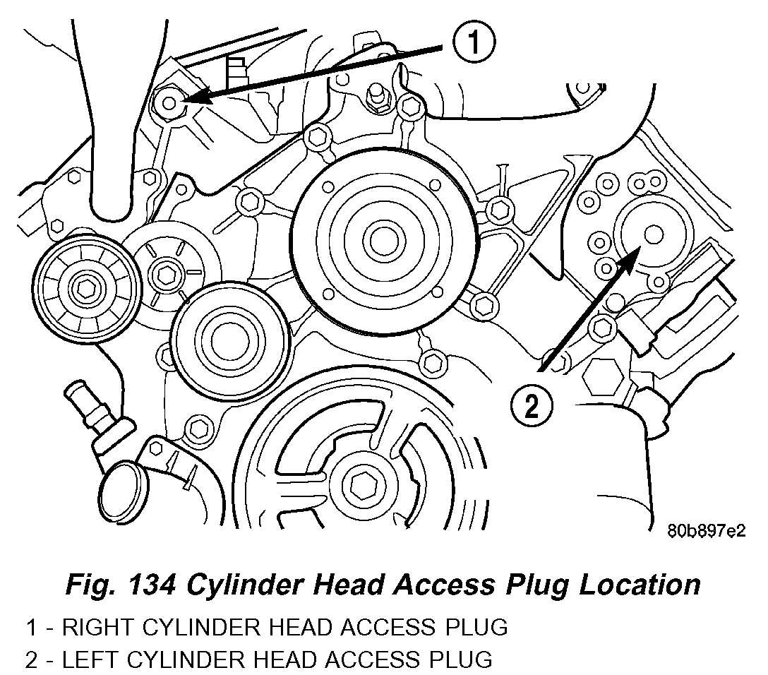

7. Remove access plugs (2) from left and right cylinder heads for access to chain guide fasteners (Fig. 134).
8. Remove the oil fill housing to gain access to the right side tensioner arm fastener.

10. Collapse and pin primary chain tensioner (Fig. 135).

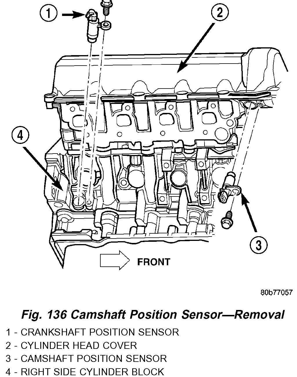

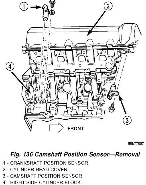

12. Remove camshaft position sensor from right cylinder head (Fig. 136).
CAUTION: Care should be taken not to damage camshaft target wheel. Do not hold target wheel while loosening or tightening camshaft sprocket. Do not place the target wheel near a magnetic source of any kind. A damaged or magnetized target wheel could cause a vehicle no start condition.
CAUTION: Do not forcefully rotate the camshafts or crankshaft independently of each other. Damaging intake valve to piston contact will occur. Ensure negative battery cable is disconnected to guard against accidental starter engagement.

14. While holding the left camshaft steel tube with adjustable pliers, (Fig. 137) remove the left camshaft sprocket. Slowly rotate the camshaft approximately 15 degrees clockwise to a neutral position.

15. While holding the right camshaft steel tube with adjustable pliers, (Fig. 138) remove the right camshaft sprocket. Slowly rotate the camshaft approximately 45 degrees counterclockwise to a neutral position.

1. Using a vise, lightly compress the secondary chain tensioner piston until the piston step is flush with the tensioner body Using a pin or suitable tool, release ratchet pawl by pulling pawl back against spring force through access hole on side of tensioner. While continuing to hold pawl back, Push ratchet device to approximately 2 mm from the tensioner body Install Special Tool 8514 lock pin into hole on front of tensioner. Slowly open vise to transfer piston spring force to lock pin (Fig. 140).

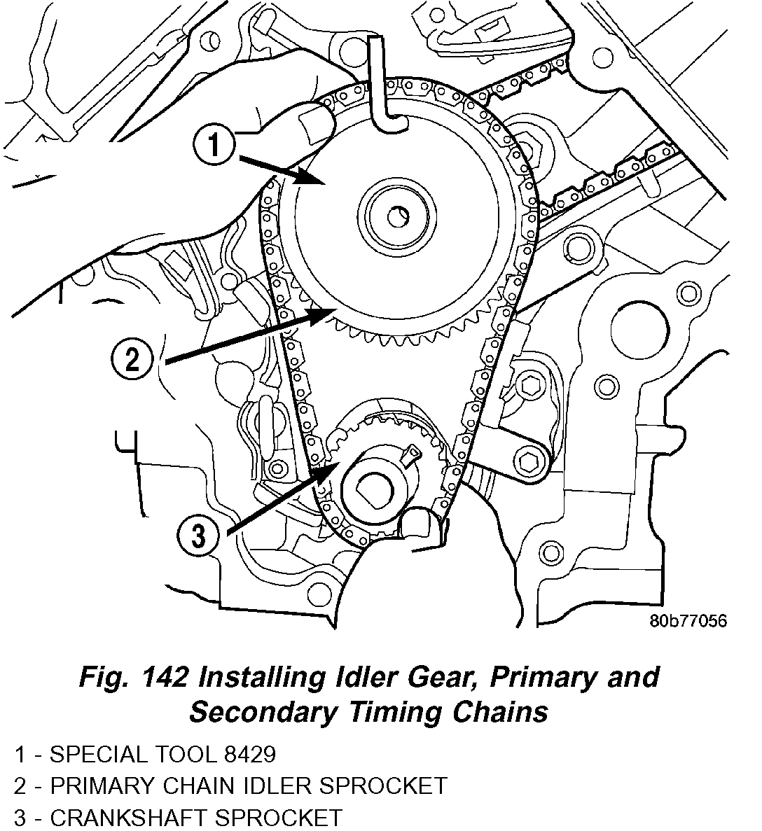

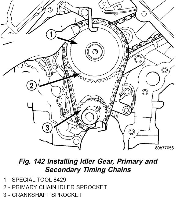

pic 10

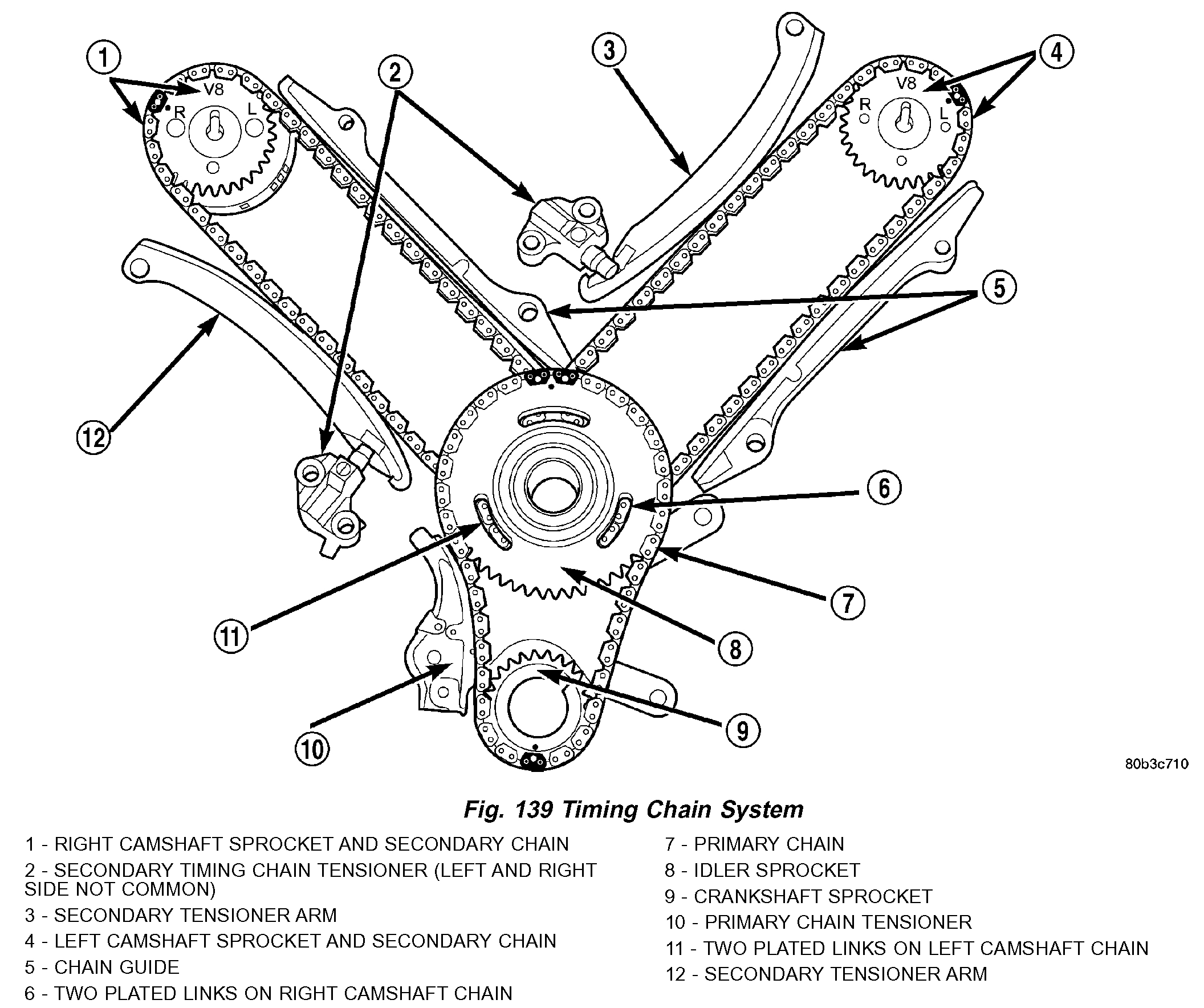

7. Install both secondary chains onto the idler sprocket. Align two plated links on the secondary chains to be visible through the two lower openings on the idler sprocket (4 o'clock and 8 o'clock). Once the secondary timing chains are installed, position special tool 8515 to hold chains in place for installation (Fig. 141).
8. Align primary chain double plated links with the timing mark at 12 o'clock on the idler sprocket. Align the primary chain single plated link with the timing mark at 6 o'clock on the crankshaft sprocket (Fig. 139).
9. Lubricate idler shaft and bushings with clean engine oil.
pic 11
10. Install all chains, crankshaft sprocket, and idler sprocket as an assembly (Fig. 142). After guiding both secondary chains through the block and cylinder head openings, affix chains with a elastic strap or the equivalent, This will maintain tension on chains to aid in installation.

14. Verify that all plated links are aligned with the marks on all sprockets and the "V8" marks on camshaft sprockets are at the 12 o'clock position (Fig. 139).

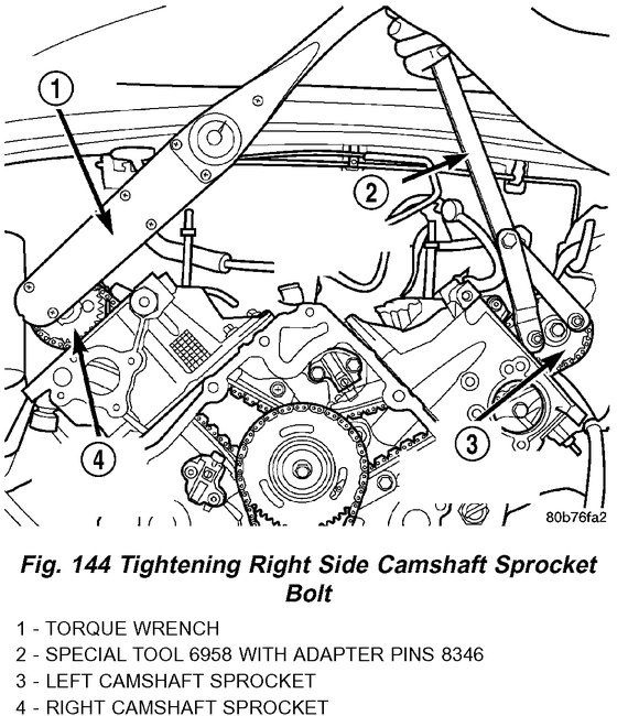

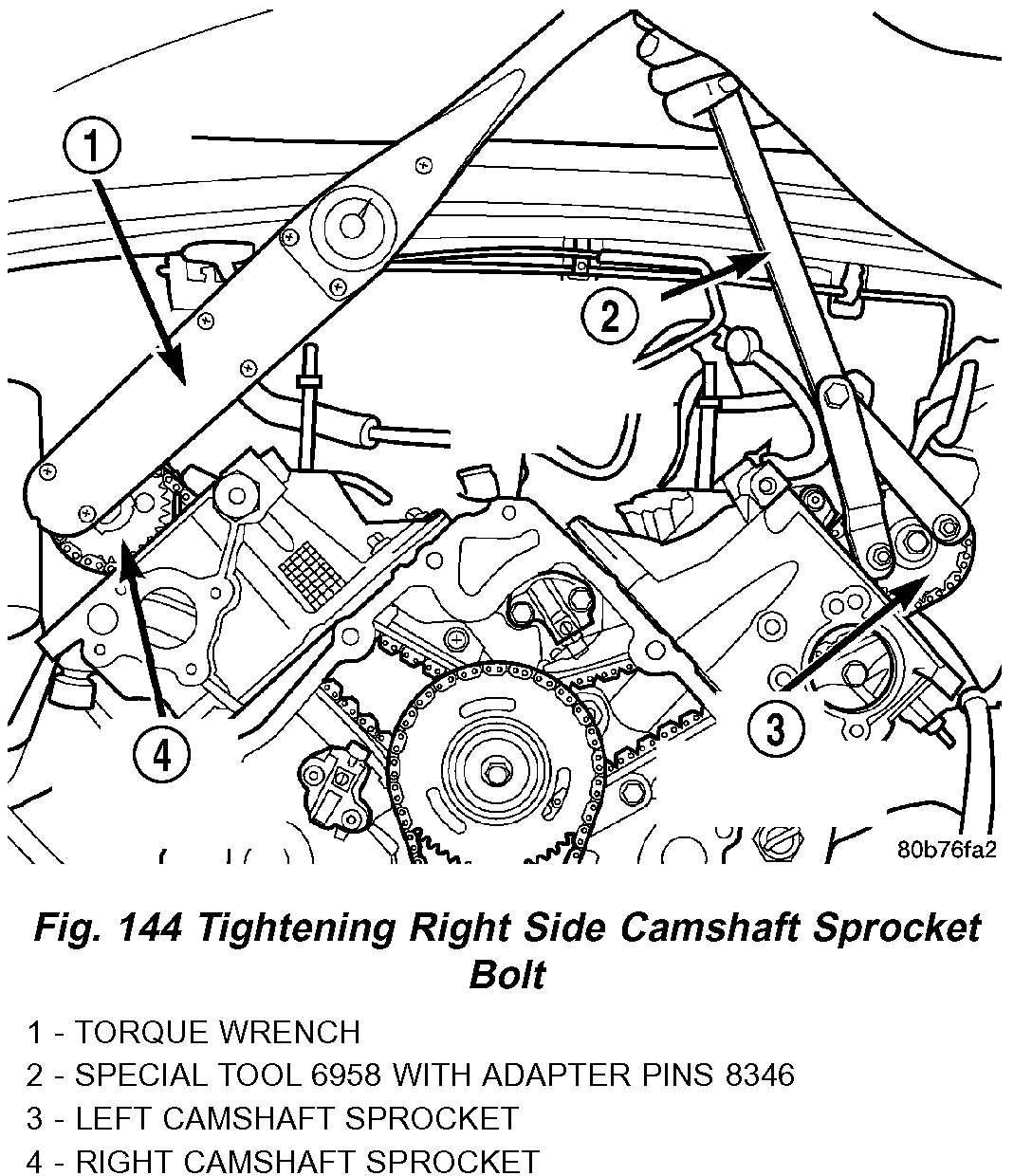

18. Using Special Tool 6958, Spanner with Adaptor Pins 8346, tighten left (Fig. 143) and right (Fig. 144). camshaft sprocket bolts to 122 Nm (90 ft. lbs.).
19. Rotate engine two full revolutions. Verify timing marks are at the follow locations:
- primary chain idler sprocket dot is at 12 o'clock (Fig. 139)
- primary chain crankshaft sprocket dot is at 6 o'clock (Fig. 139)
- secondary chain camshaft sprockets "V8" marks are at 12 o'clock (Fig. 139)

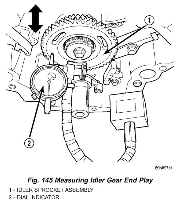

21. After installing all chains, it is recommended that the idler gear end play be checked (Fig. 145). The end play must be within 0.10 - 0.25 mm (0.004 - 0.010 inch). If not within specification, the idler gear must be replaced.
