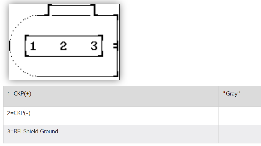

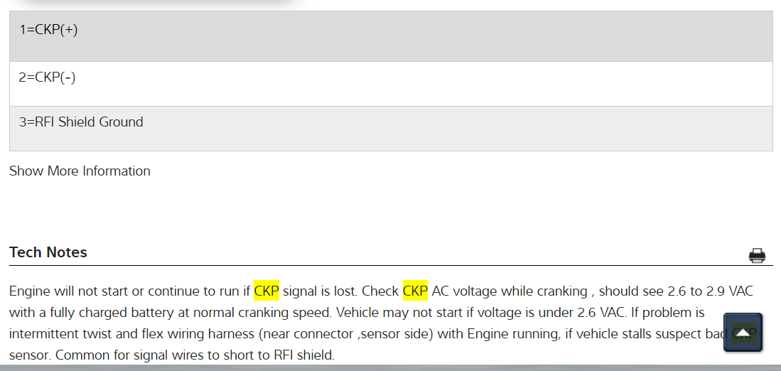

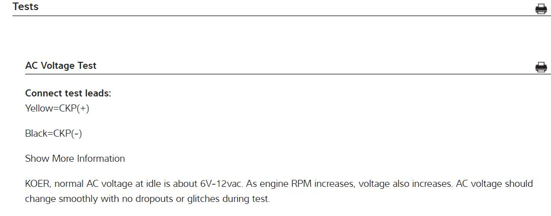

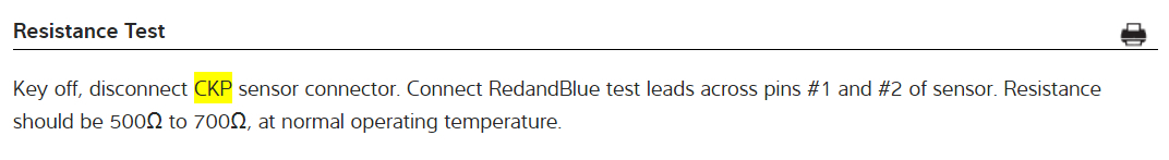

Hi, i am new here and my car is cranking but not starting. Check wiring to crankshaft sensor and getting 2.5 volts on all three pins what should i do?
Apr 12, 2019 at 12:15 PM
SCGRANTURISMO
  • 4,897 POSTS

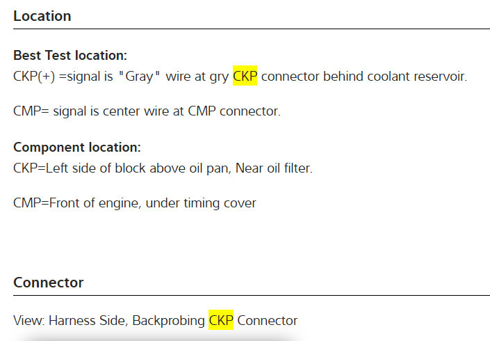

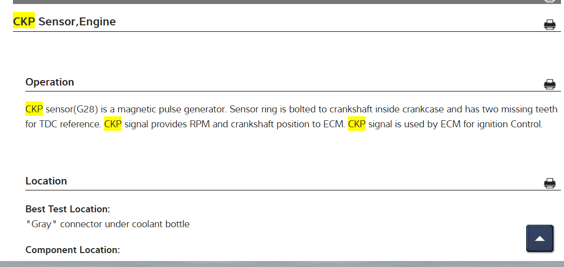

This sounds to me like your vehicle's Crankshaft Position Sensor (CKP) sensor has a short in it. The middle wire on the connector is the ground wire and should have no voltage to it at all. In the diagrams down below I have included a factory diagnostic test for the CKP sensor. I have also included a few links for you to go to below as well:
https://www.2carpros.com/articles/how-a-crank-shaft-angle-sensor-works
Please go through these guides and the information in the diagrams down below and get back to us with what you are able to find out, please.

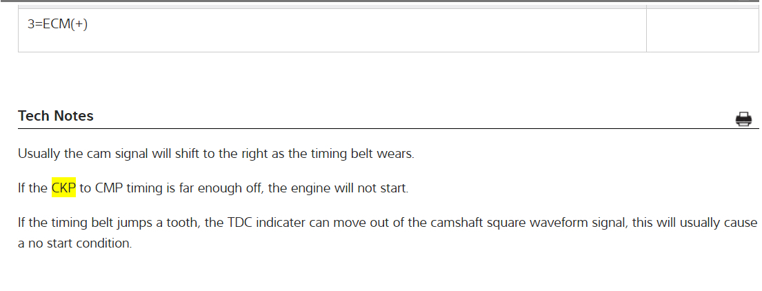

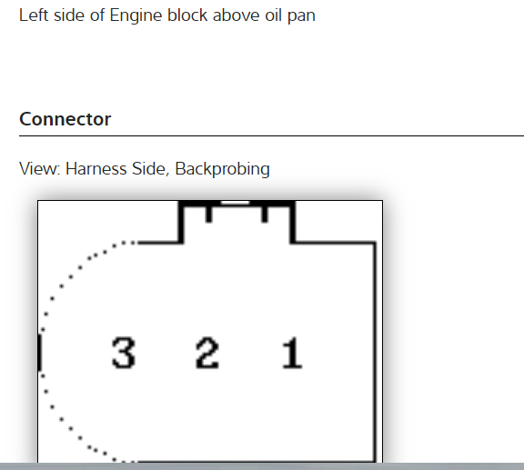

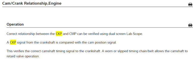

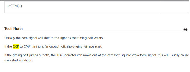

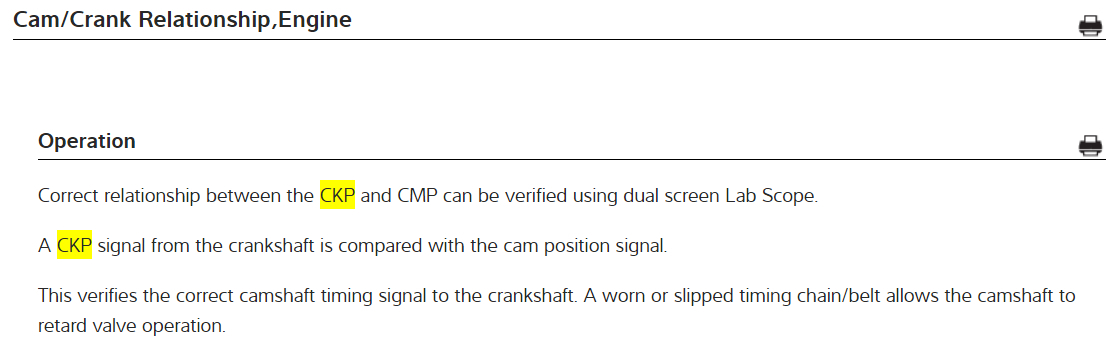

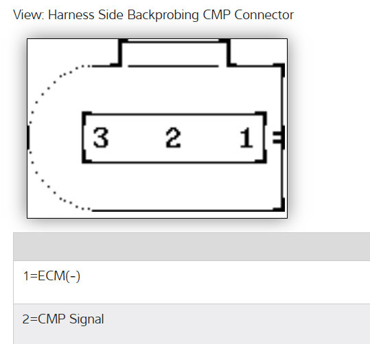

Hi alex got a new crankshaft sensor and still no start can it be a faulty camshaft sensor and how can i test the camshaft sensor?
Apr 15, 2019 at 8:24 AM
SCGRANTURISMO
  • 4,897 POSTS
Hello again,
I have included the information that you requested in the diagrams down below. There are a couple of other tests that I did not include because they require the use of a dual lab scope. I have also included a link below for you to go to below.
https://www.2carpros.com/articles/camshaft-angle-sensor-replacement
Please go through these guides and get back to us with what you are able to find out, please.
