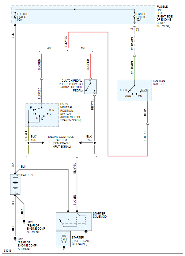

Vehicle ran fine. drove to store and timing belt broke, fixed that but still no crank. found out when belt broke it bent valve stems. Replaced all 8 and compressioned them. firing order is 1 2 4 3. set distributor rotor on number 1. finally cranked but ran rough and missing then shut off. repeated the distributor and timing but now wont crank at all. please help.
