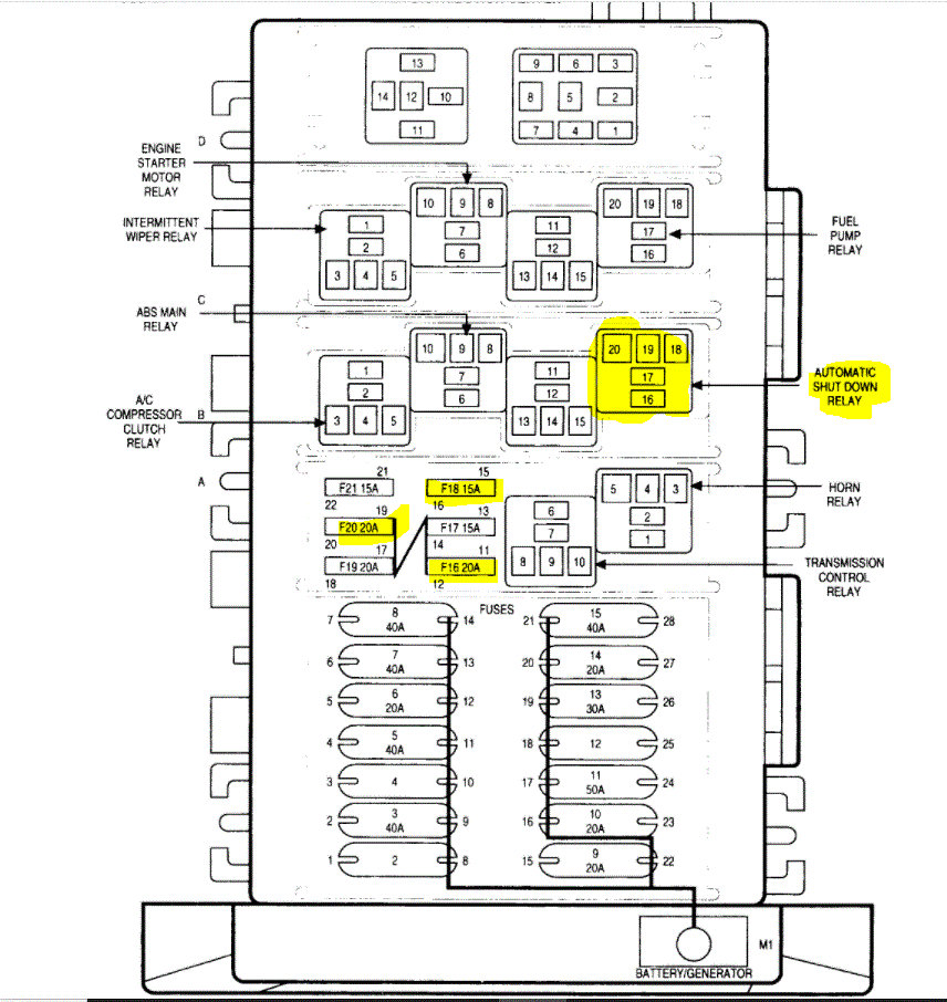

If you don't hear the pump and lost spark, I need you to check a couple of fuses and the automatic shutdown relay (ASD). The ASD will shut down fuel and ignition if it fails.

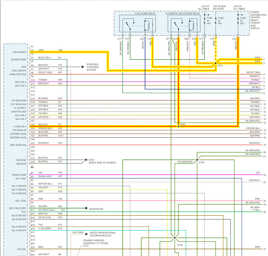

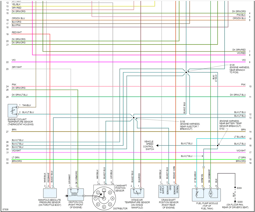

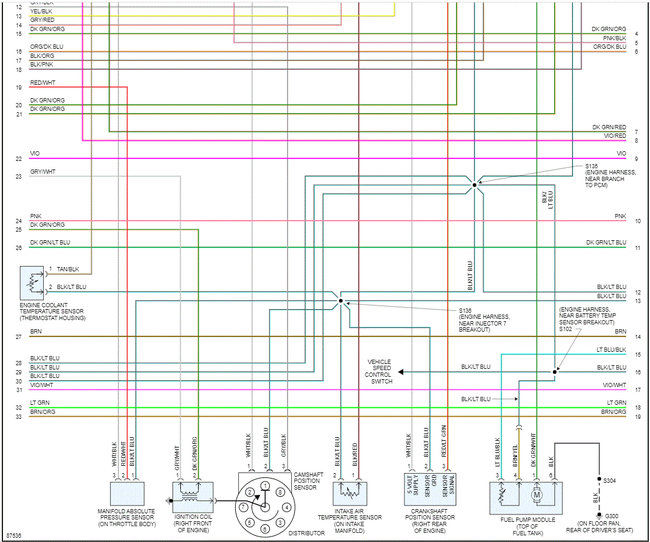

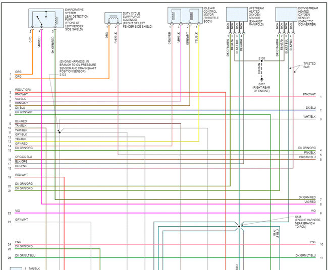

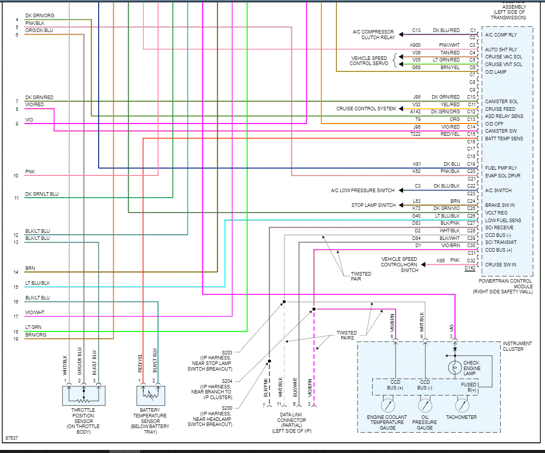

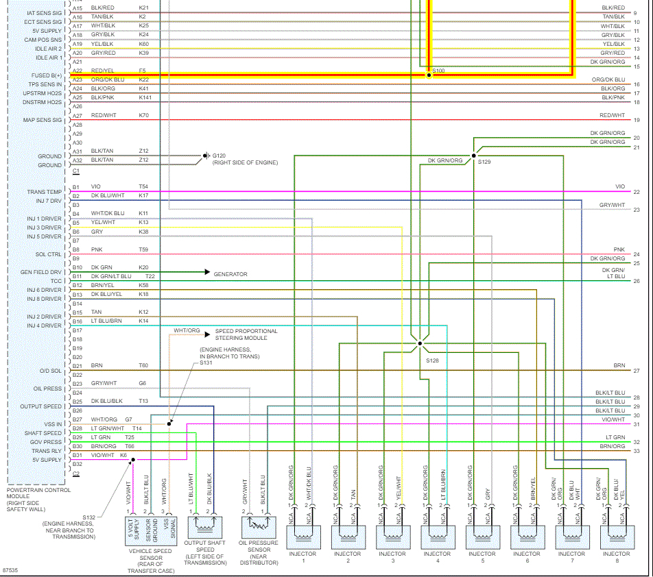

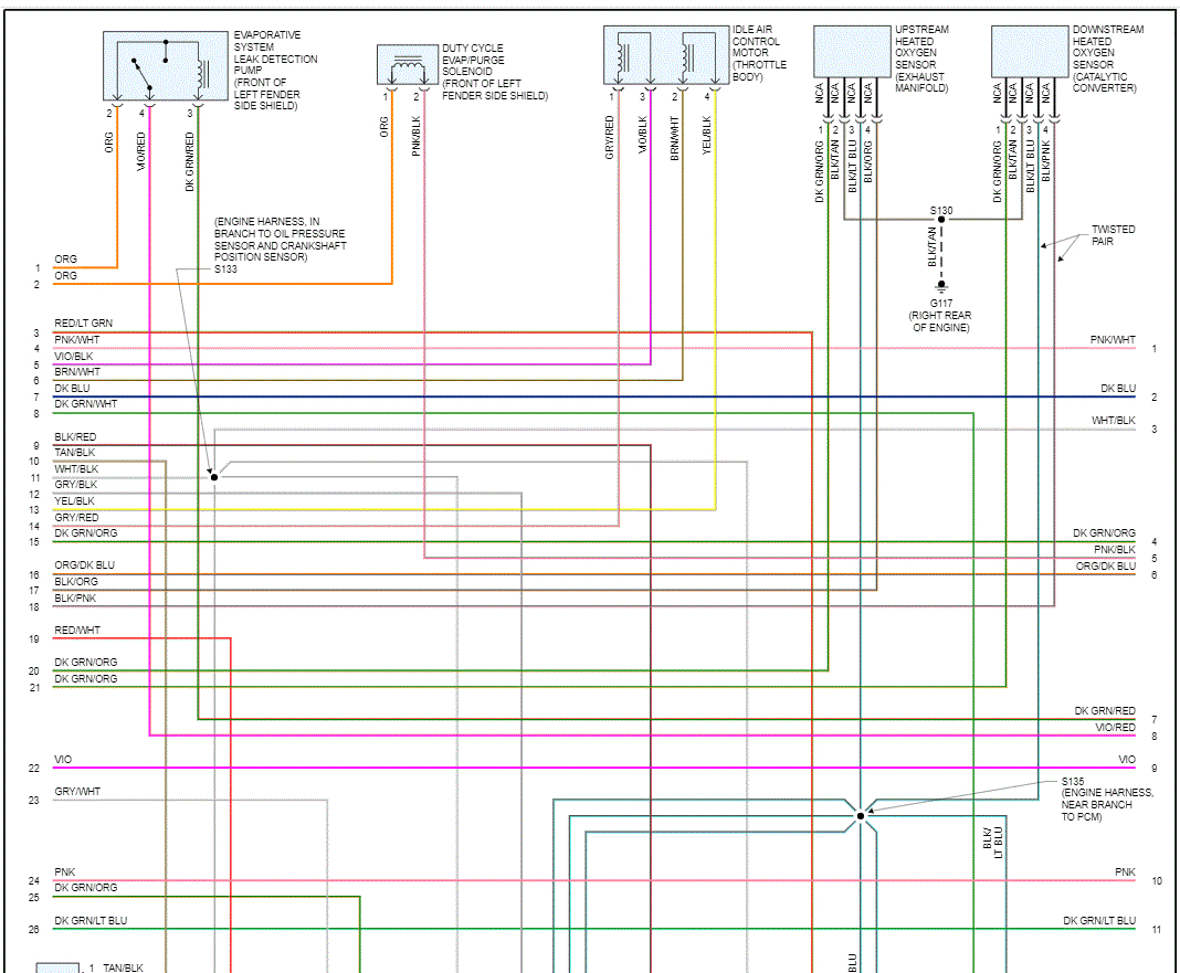

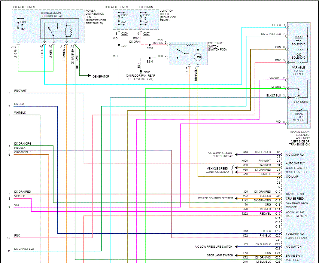

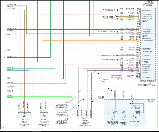

I attached the entire wiring schematic below for the powertrain management circuit. I highlighted the ASD relay and the fuses. First, confirm the fuses are good and have power to them. Here is a link to help:
If they check good and have power, switch the ASD relay with a different one in the fuse box having the same part number to see if it makes a difference. If there isn't one, here is a link that explains how to test a relay.

The last pic shows the three fuses and the ASD locations in the under-hood fuse box.

See pics below.
Note: I had to cut each of the three pages of schematics in half to make them readable for you. I did overlap them so you can follow from one to the next.
