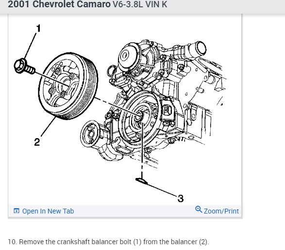

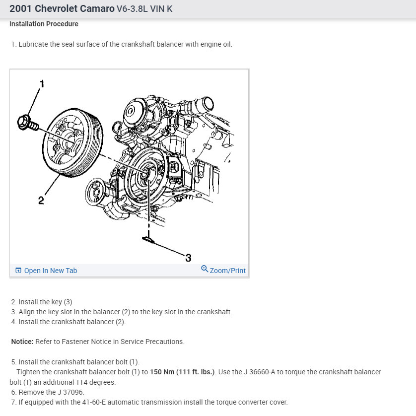

When I put the pulley back on the car how many foot pounds do I torque the bolt to and do have to get a new bolt for the pulley? I read somewhere that the bolt is hard to find is that true? Thank you for answering my questions.
