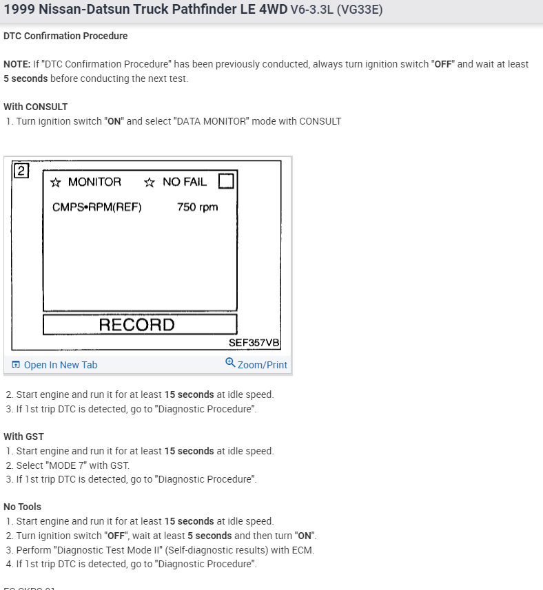

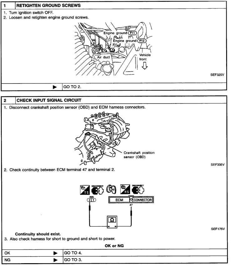

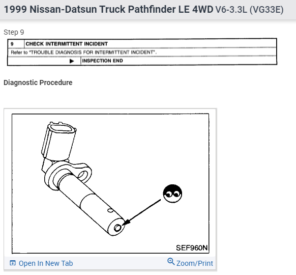

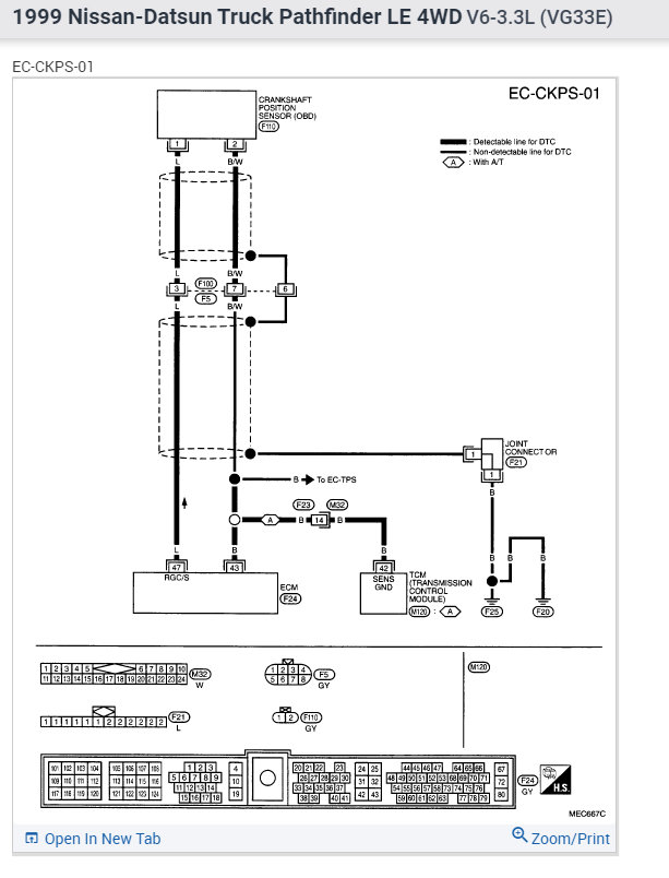

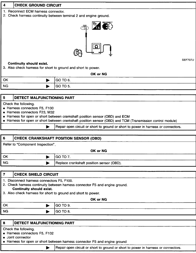

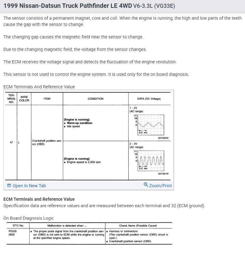

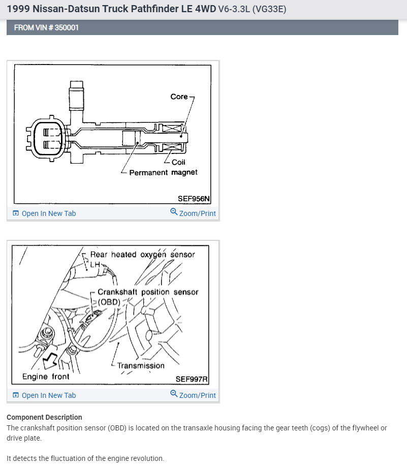

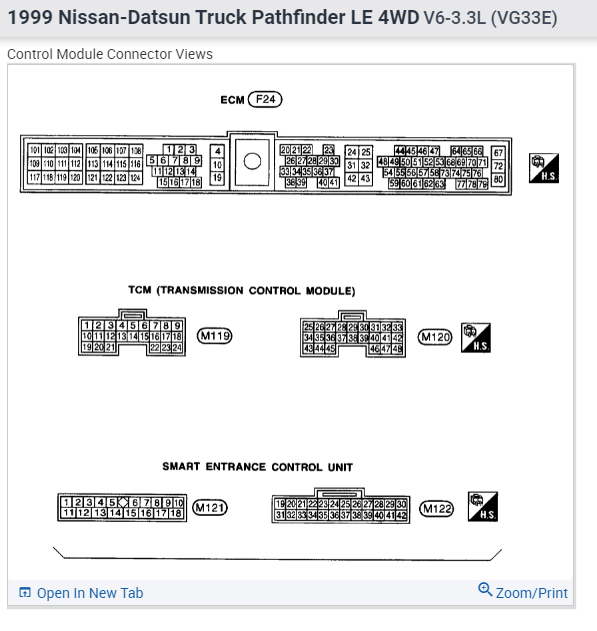

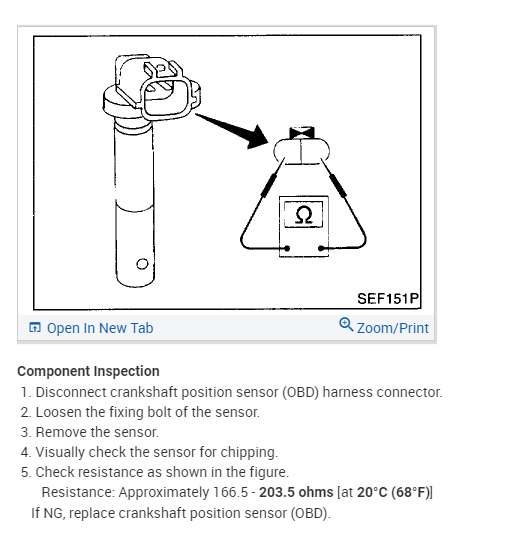

The code P0335 gets triggered when the ECM does not receive a proper signal from the crank sensor. It can be due to a sensor or faulty wiring. It can also be due to an issue with the ECM.
This will require a deeper dive to look at all the possibilities.
I have attached a trouble shooting guide for this code below. Go through this and that should narrow down the issue.
