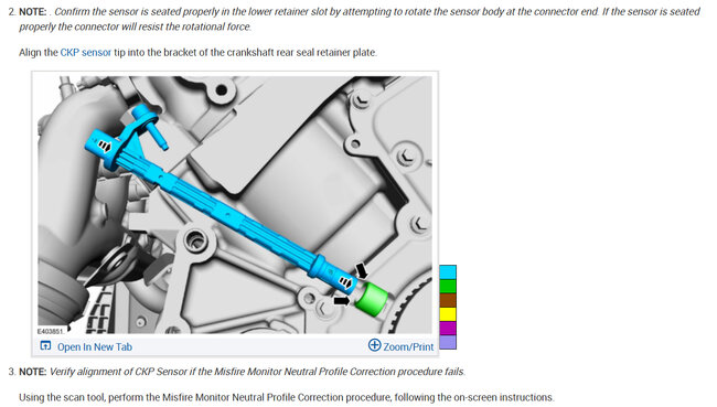

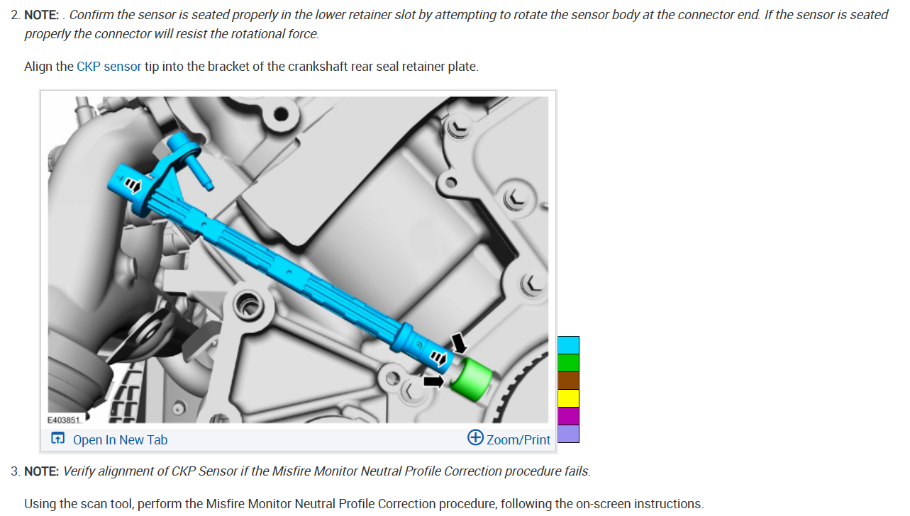

I would scan for codes first. This video can help:
https://www.youtube.com/watch?v=InIlnsjOVFA&t=11s

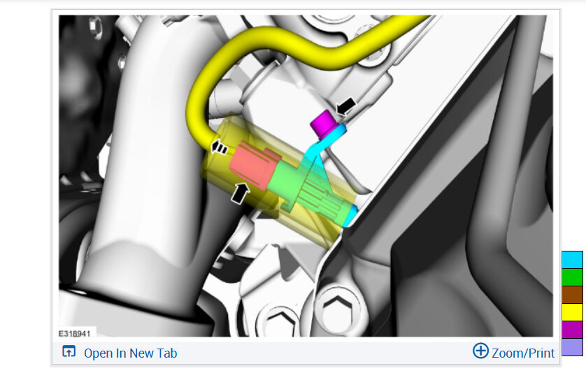

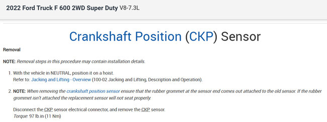

Here is the crankshaft angle sensor so you can check it out and replace it if needed.
Using the scan tool, perform the Misfire Monitor Neutral Profile Correction procedure, following the on-screen instructions.
It looks like a ong sensor, and it is at the rear of the engine block. Check out the images (below). Please let us know what happens.
