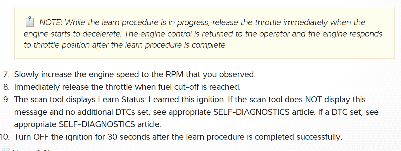

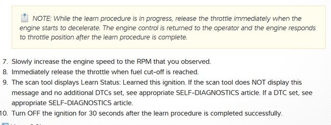

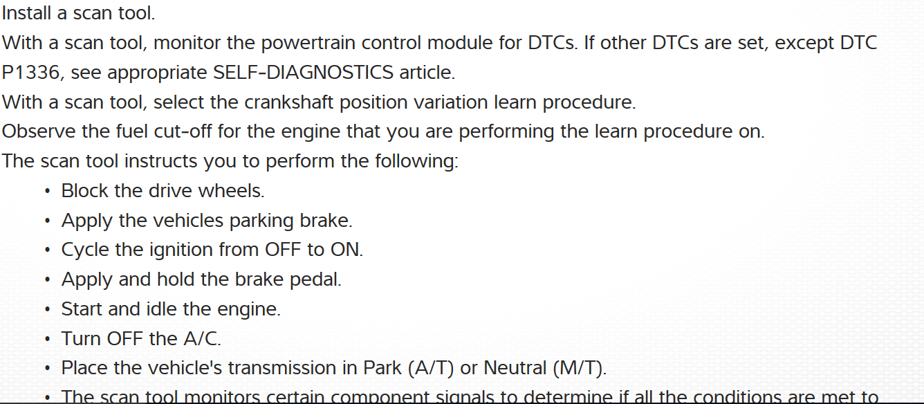

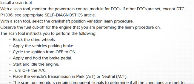

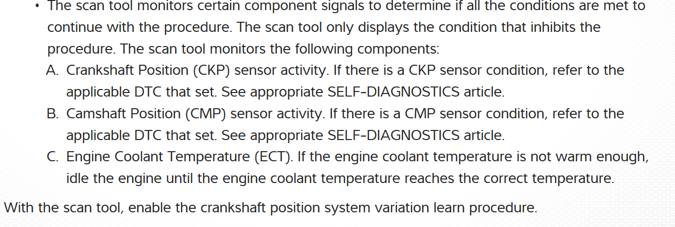

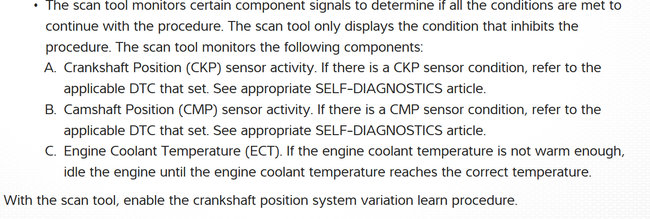

If you do not have a professional scan tool you cannot do it. See pictures.
