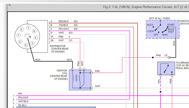

Engine turns, no spark, no fuel. Just replaced plugs, wires, cap, rotor, and coil.

Unfortunately after some more research. This truck has a 1993 7.4L in it. So, new question is.... is there and where is the crank sensor located on a 1993 454 small block?
Jun 2, 2023 at 8:19 AM
The crankshaft sensor is inside the distributor. Please check out the images below.
Jun 3, 2023 at 9:25 AM
SILVERSAC
Thank you. Great information, very helpful. Replaced and truck started and runs great.
