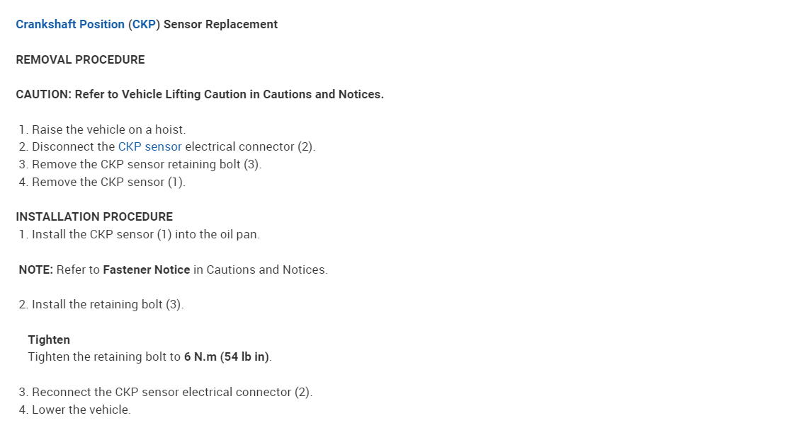

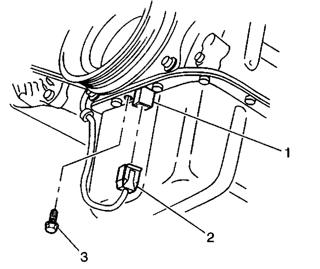

Hello, the crankshaft position sensor is just below the harmonic balancer on the front edge of the oil pan, I'll post a diagram.
Check for oil inside the harness plug for the sensor.
