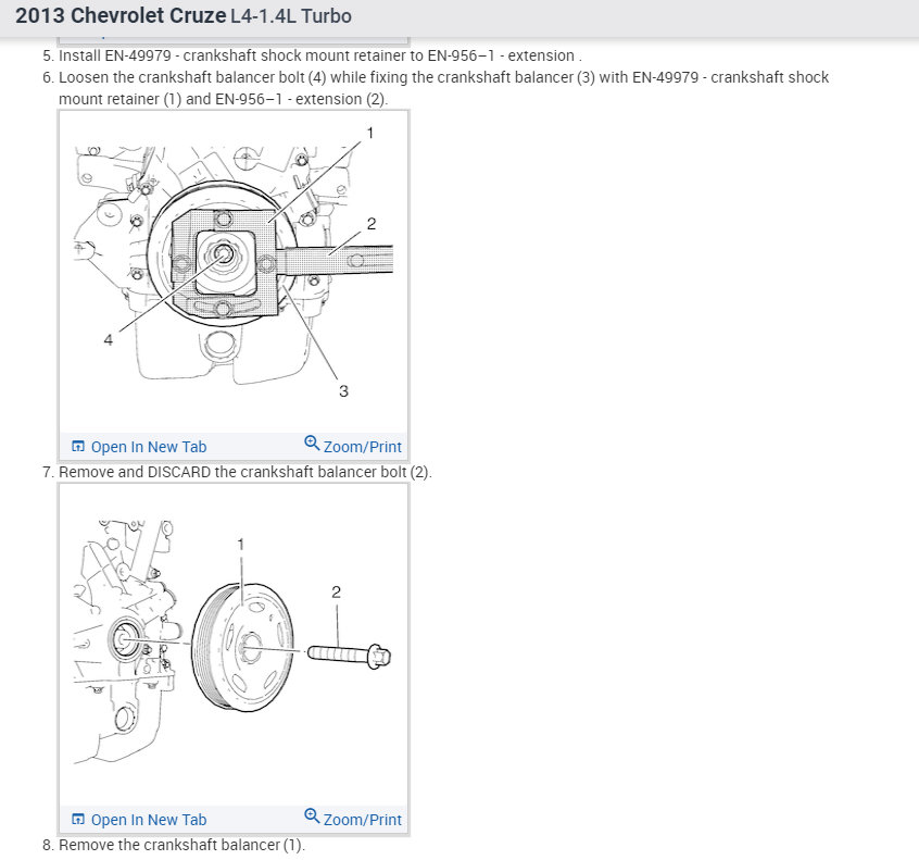

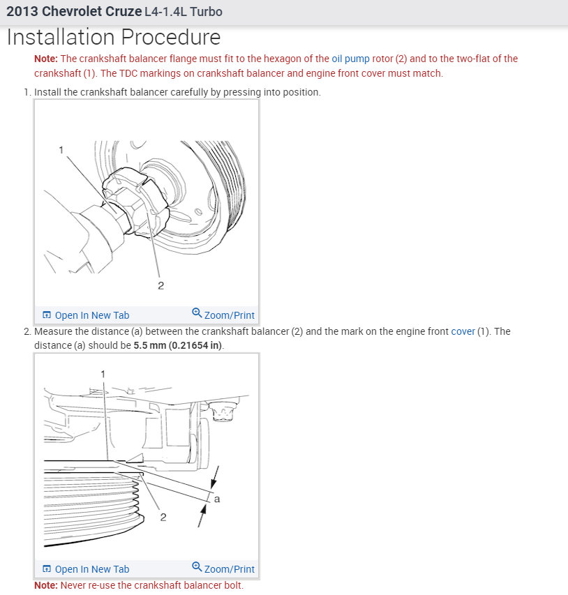

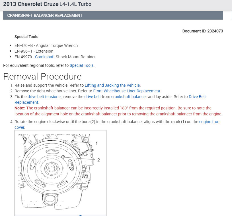

I replaced the timing cover due to the valve cover holes being stripped from previous owner. After reinstalling everything I tried to put the crank pulley back on and it wouldn't go all the way onto the crank. I purchased a new pulley hoping it would fix the problem, but it didn't. I can get the pulley to start on the ring for the oil pump, but it won't spline onto the pulley allowing it to go on the crankshaft.
