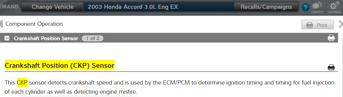

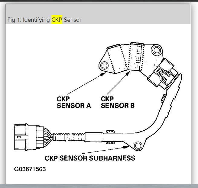

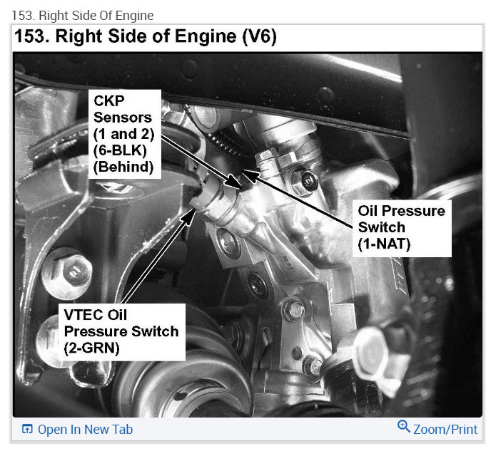

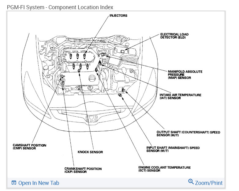

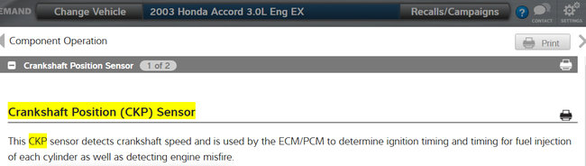

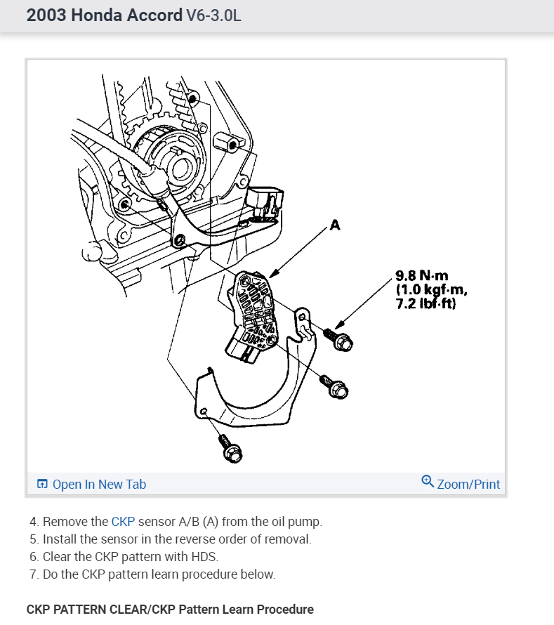

I'm getting no fire on two coils. I had it put on the computer a few weeks ago and 300 through 306 popped up on the computer telling me that all cylinders was misfiring, but the code for the crank position sensor did not come up. could it still be the crank position sensor?
