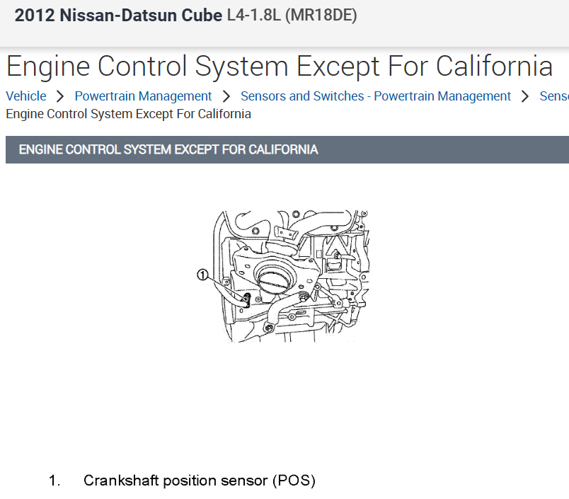

Crank shaft position sensor location needed.

The crankshaft sensor is located down low on the block, near the rear, under the exhaust manifold. Check out the images (below). Let us know if you need anything else.
