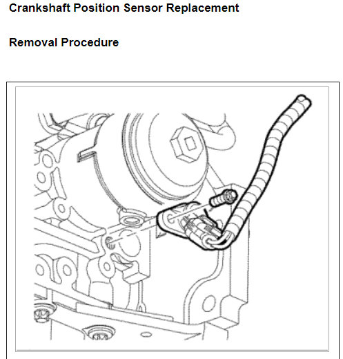

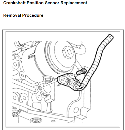

This sounds like a classic crankshaft position sensor that is going out. When this sensor goes out is does not trigger a check engine light but we should run the codes first to see what comes up.
and
Here is the location of the sensor for your car. Check out the diagrams (below). Please run some tests and get back to us.
