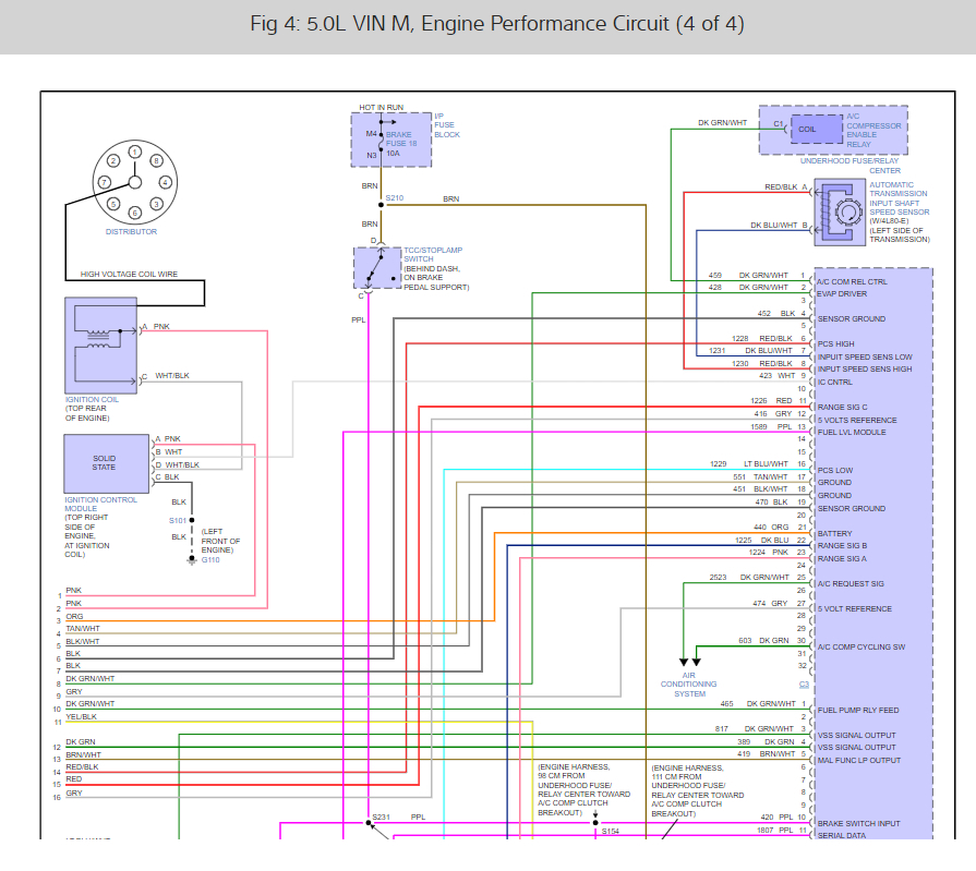

It’s not security and did the hard reboot too. I’m thinking ground fault on ecm or bad ecm. Soon as I get a helper I’ll check if crank sensor is sending signal but it has power and ground. No signal at Icm or coil

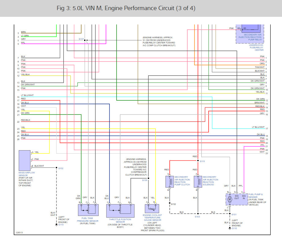

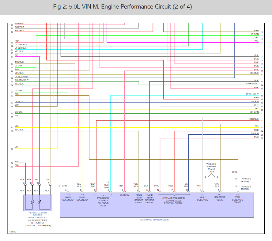

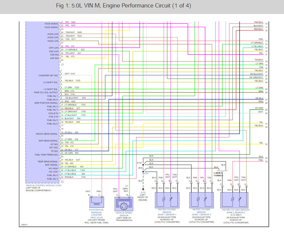

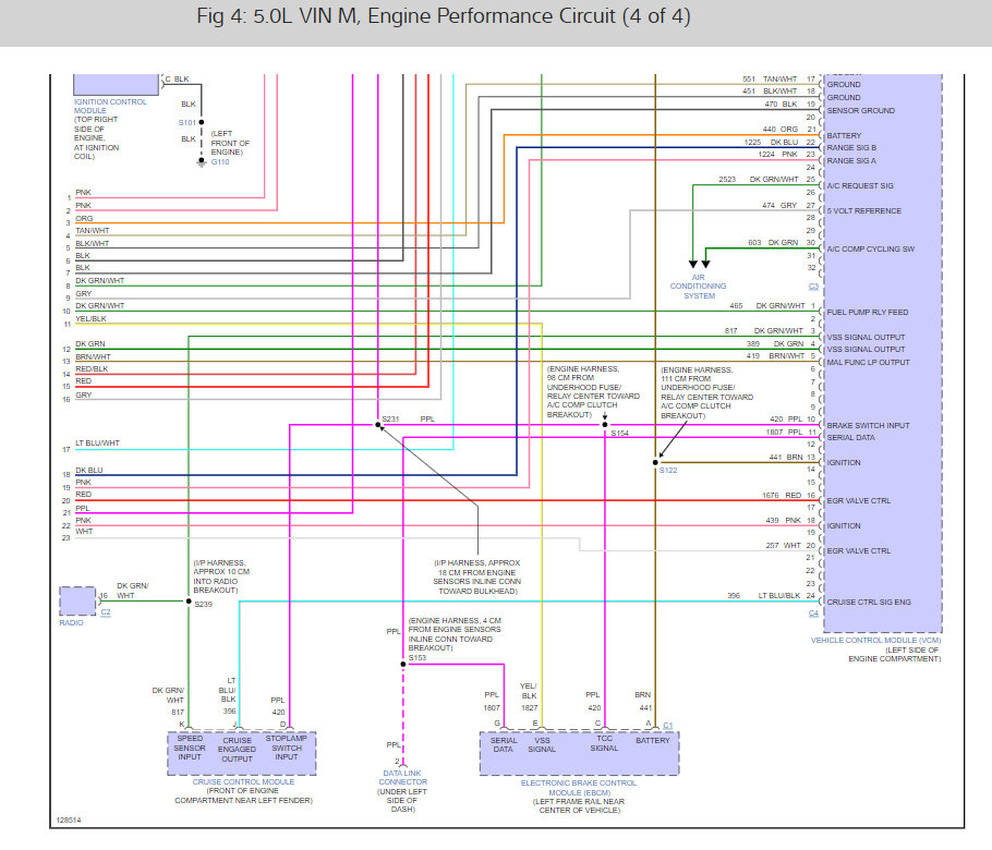

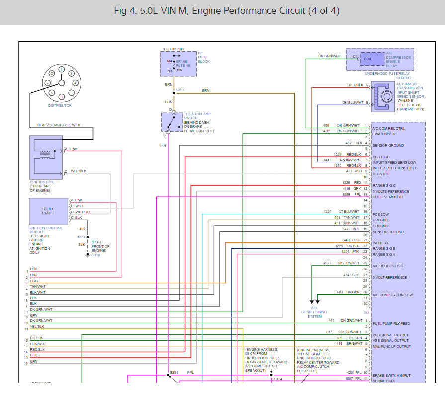

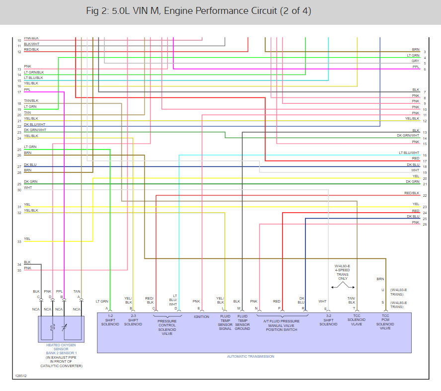

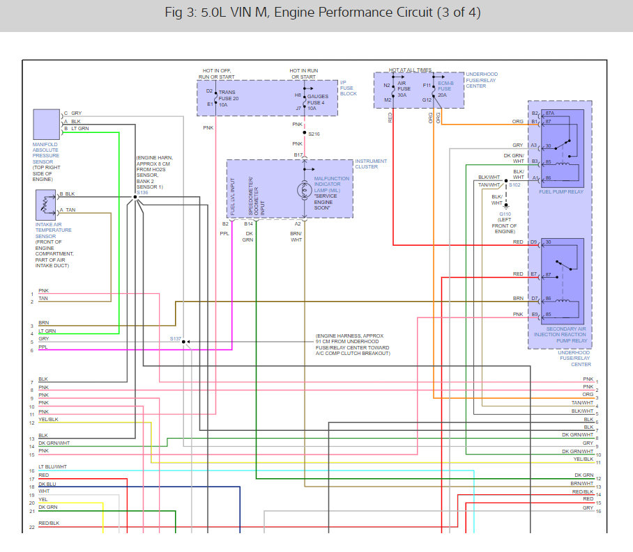

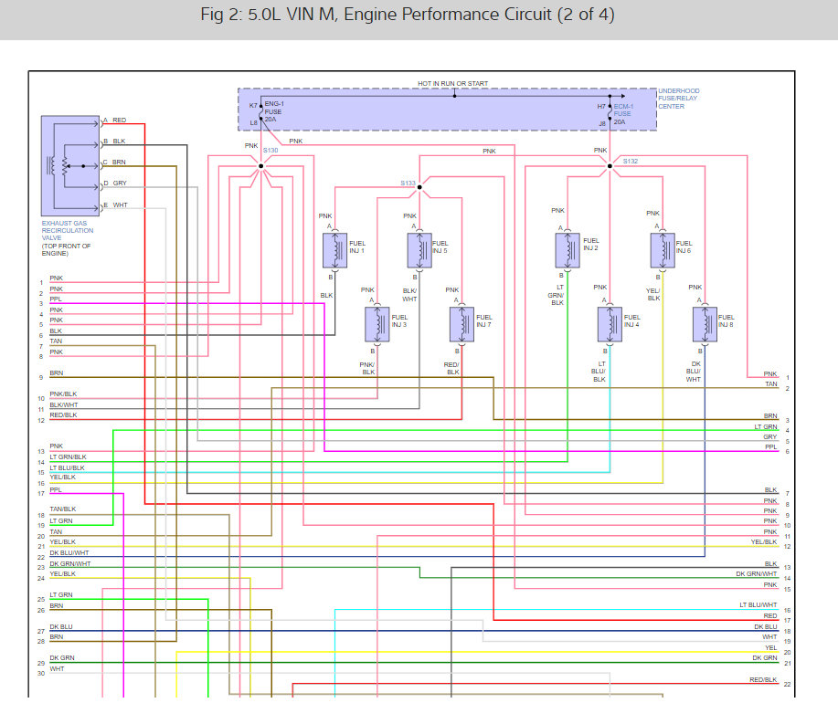

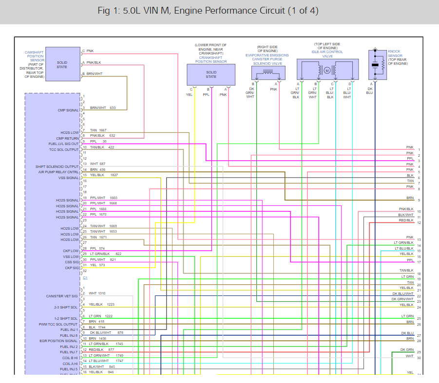

So, the engine has no spark, correct? Can you hear the fuel pump come on in the tank when you turn the key on? Here is the engine/PCM wiring diagrams so you can check the grounds and see how the system works:
Check out the diagrams (below). Please let us know what you find.
