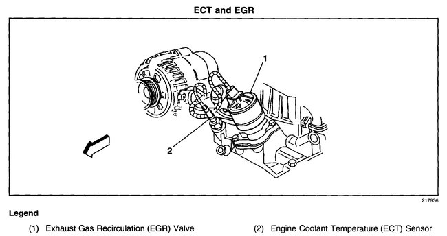

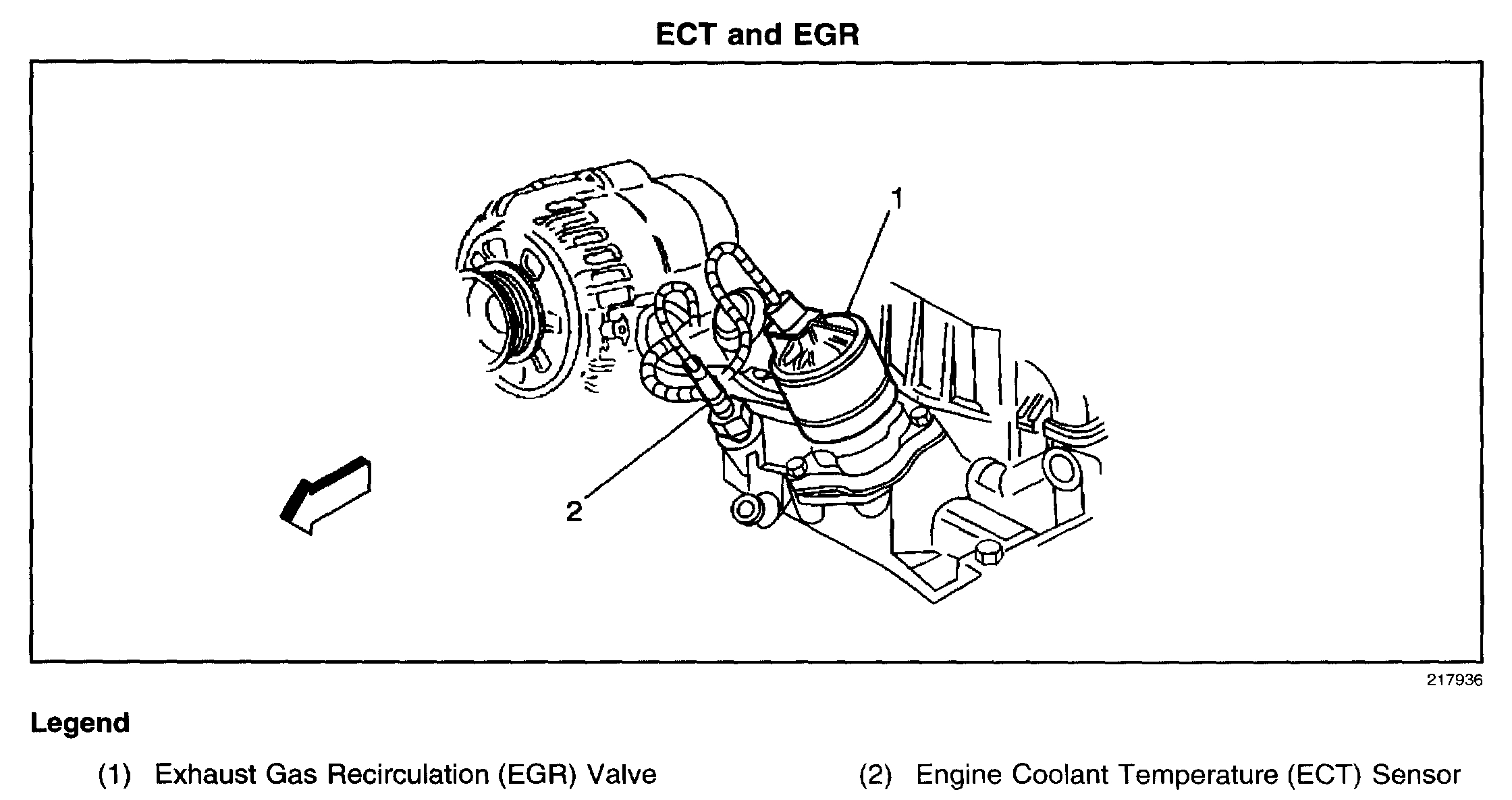

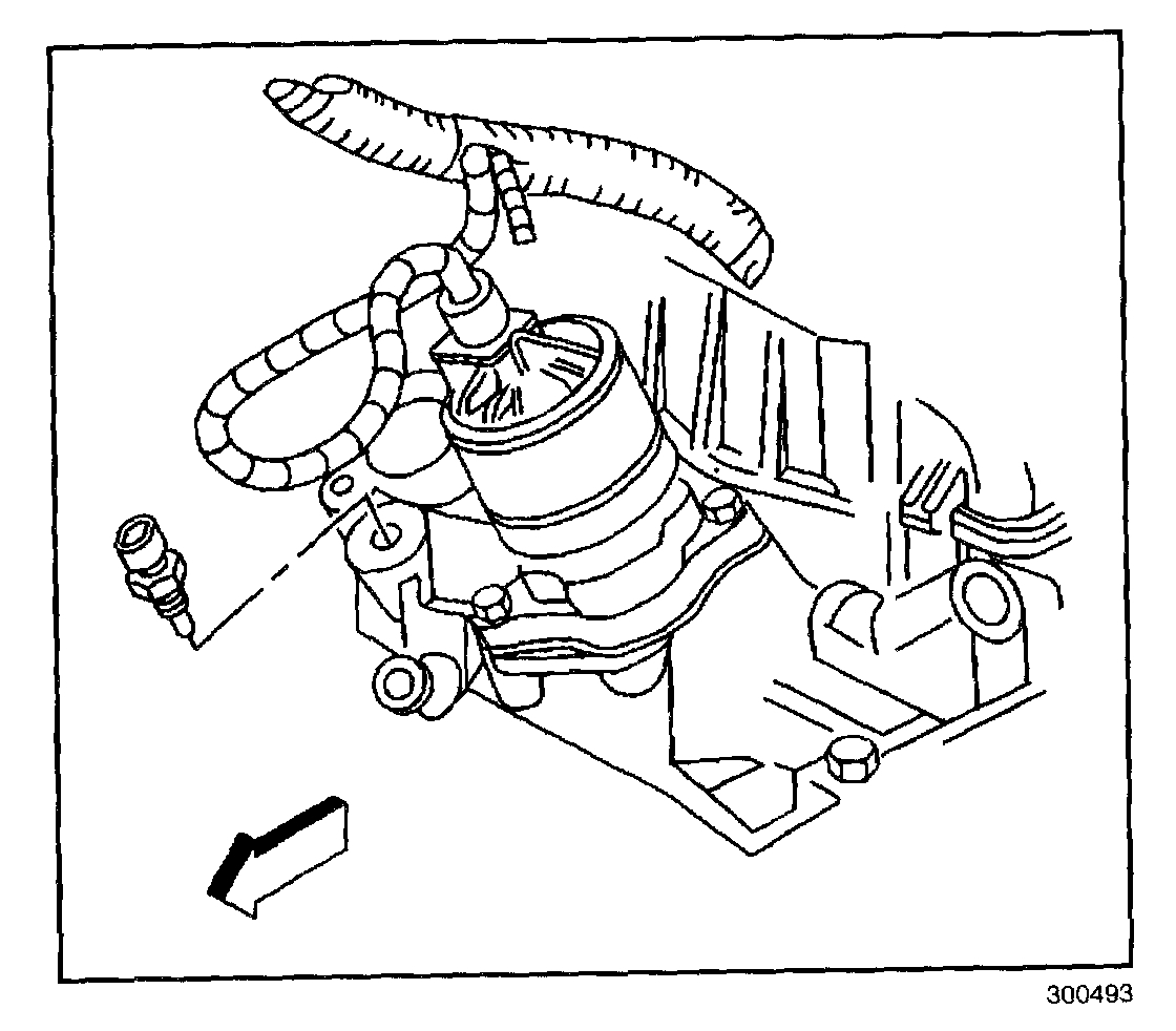

If you find that you have both spark and fuel, the next recommendation I have is to check the engine coolant temperature sensor. You will need a live data scanner to do this. When the engine fails to start, you need to see what temperature the ECT is telling the computer the coolant is. I had one of these in shop with running bad, then good, then no start. The ECT was telling the computer that it was -40ºF. The engine was flooding with fuel. Replaced the sensor and problem was solved.
I attached a picture of the sensor. It is number 2 in the picture.

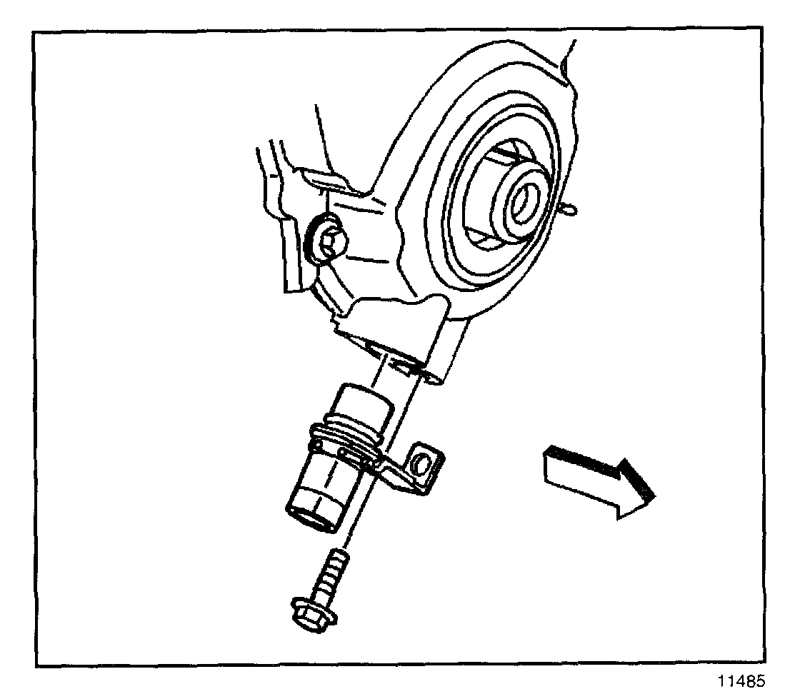

pic 3
1. Install the sensor into the timing cover. Lubricate the O-ring with clean engine oil before installing.
NOTE: Refer to Fastener Notice in Service Precautions.
2. Install the sensor hold down bolt.
Tighten
Tighten the bolt to 8 N.m (71 lb in).

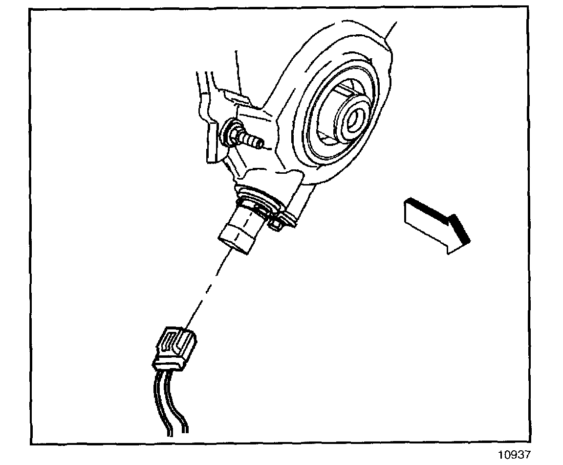

pic 4
3. Install the CKP sensor harness connector.
4. Lower the vehicle. Refer to Lifting and Jacking the Vehicle.
5. Connect the negative battery cable.
6. Perform the CKP System Variation Learn Procedure. Refer to CKP System Variation Learn Procedure. See: Vehicle > Programming

Engine coolant temp sensor
https://www.2carpros.com/articles/coolant-temperature-sensor-cts-replacement
_________________________________________

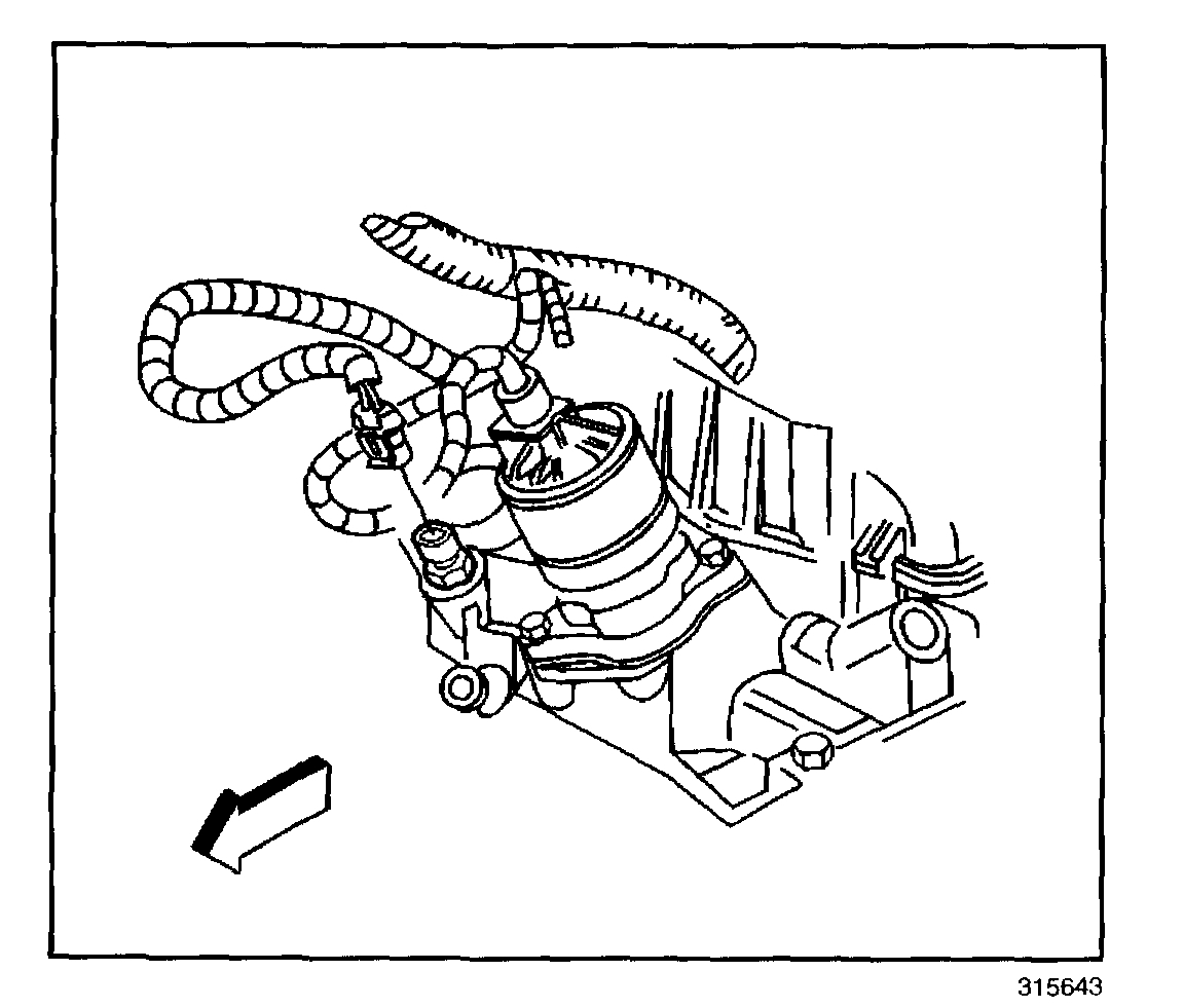

Pic 5 shows location.
Specific directions for your vehicle.

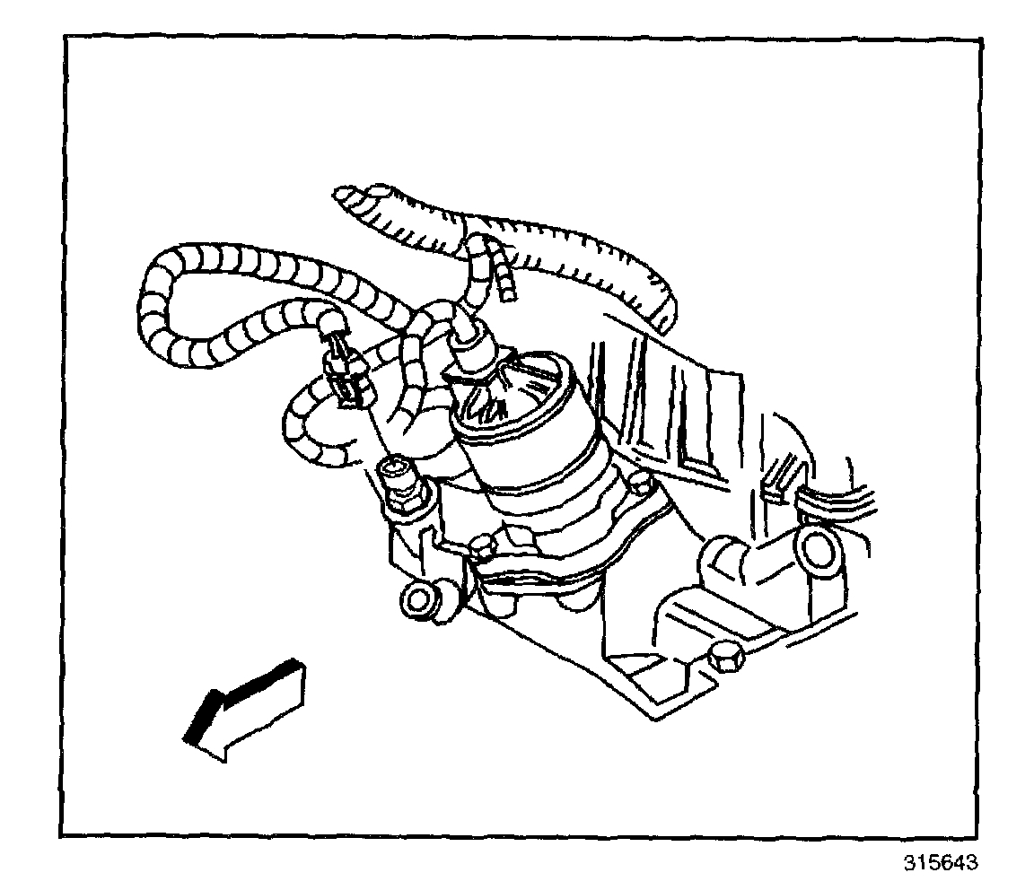

pic 6
1. Turn OFF the ignition.
2. Remove the air cleaner assembly.
3. Drain the cooling system below the level of the Engine Coolant Temperature (ECT) sensor. Refer to Draining and Filling Cooling System in Cooling System.
4. Disconnect the ECT sensor harness connector.
