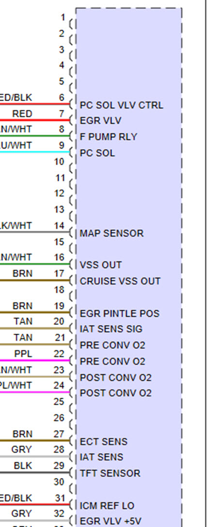

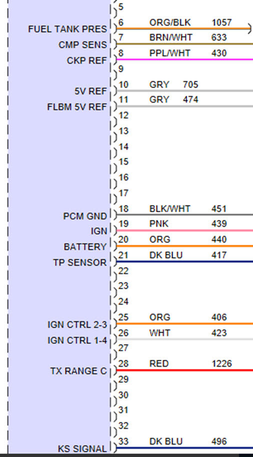

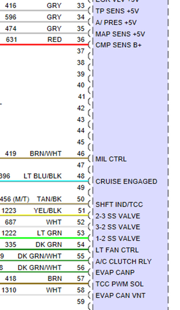

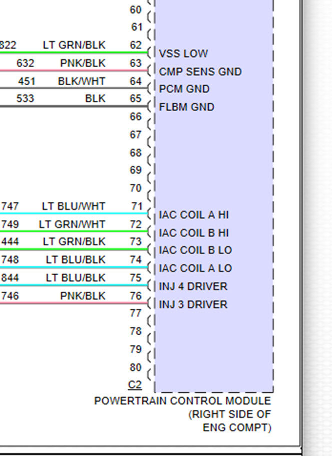

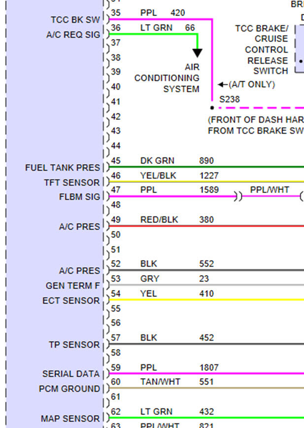

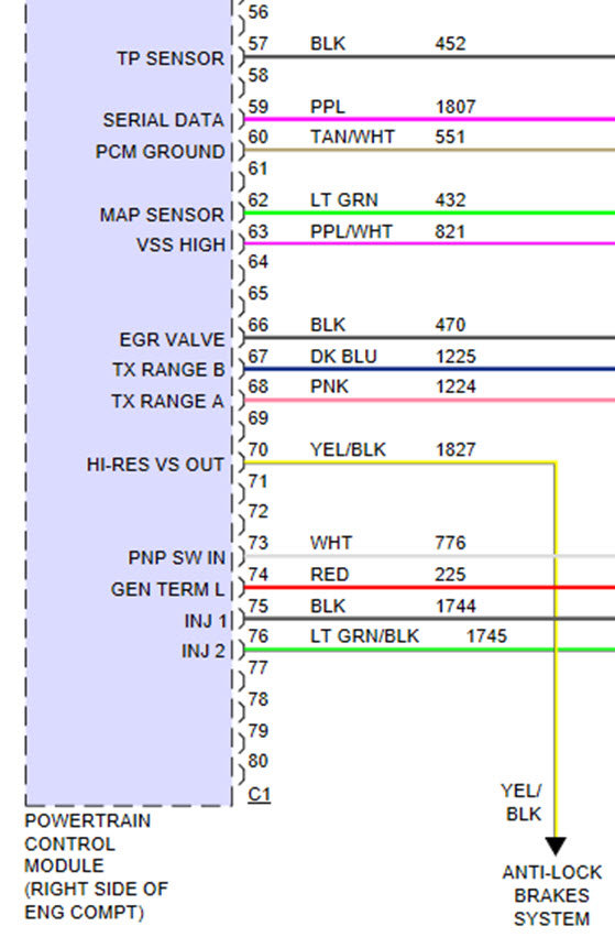

This truck came to me for repairs over the last weekend. It has proper fuel pressure,spark and engine timing. New intake gaskets. New ICM, CKP,and CMP. I have a 5 volt reference voltage to most of my engine management sensors. This truck will not start. No cross firing. New plugs and wires. Also coils are new. Scan tool data says calculated load at 100%. And rear 02 has no voltage and is new also. Also has new FPR. Any help would be greatly appreciated!
