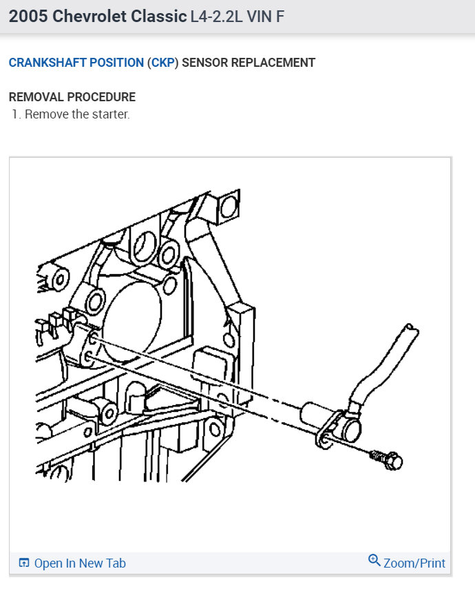

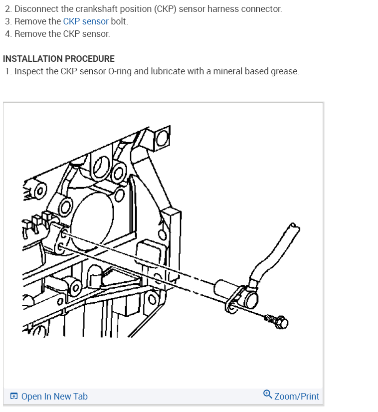

After fixing a spark plug misfire I had earlier before. i fixed my p0340 code after changing the ignition coil and ICM and i still couldn’t get it to start. i found out i had a broken starter and had it replaced and still nothing. After that i changed my crankshaft sensor seeing that my car doesn’t have a camshaft sensor, so i currently have no codes but i have fuel coming to fuel rail but I'm thinking about using starting fluid to get an idea of what would happen. Whenever i crank there’s no RPM signal on the obd scanner which leads me to suspect it’s a possible faulty crank sensor. I would love to hear some feedback! Love this website!
