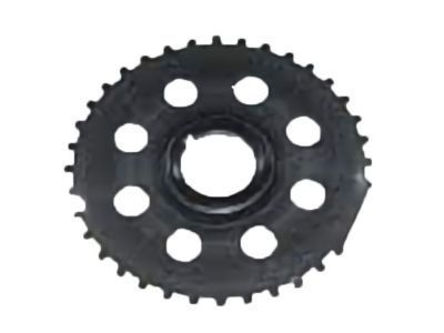

I would probably look over the parts and see what's different. It could simply be that GM wanted 3X and 18X signals while Toyota wanted 6X and 24X. You could test that if you have access to an O-scope or rig up a test to watch how many notches are showing up from the sensors. If I remember that engine uses a bolt on reluctor wheel (# 19315-0T030) behind the crank pulley. Take a look and see if those are the same between the two. Could do the same with the cams. Might be that you just swap the crank wheel or a cam and are done.

Thank you so much for your help. The pickup for the crank sensor was different pattern and while I was in there, i changed the cams just to be safe. Motor is back in, starts and runs. I really appreciate you taking the time to assist me with my troubleshooting, it helped a lot.
