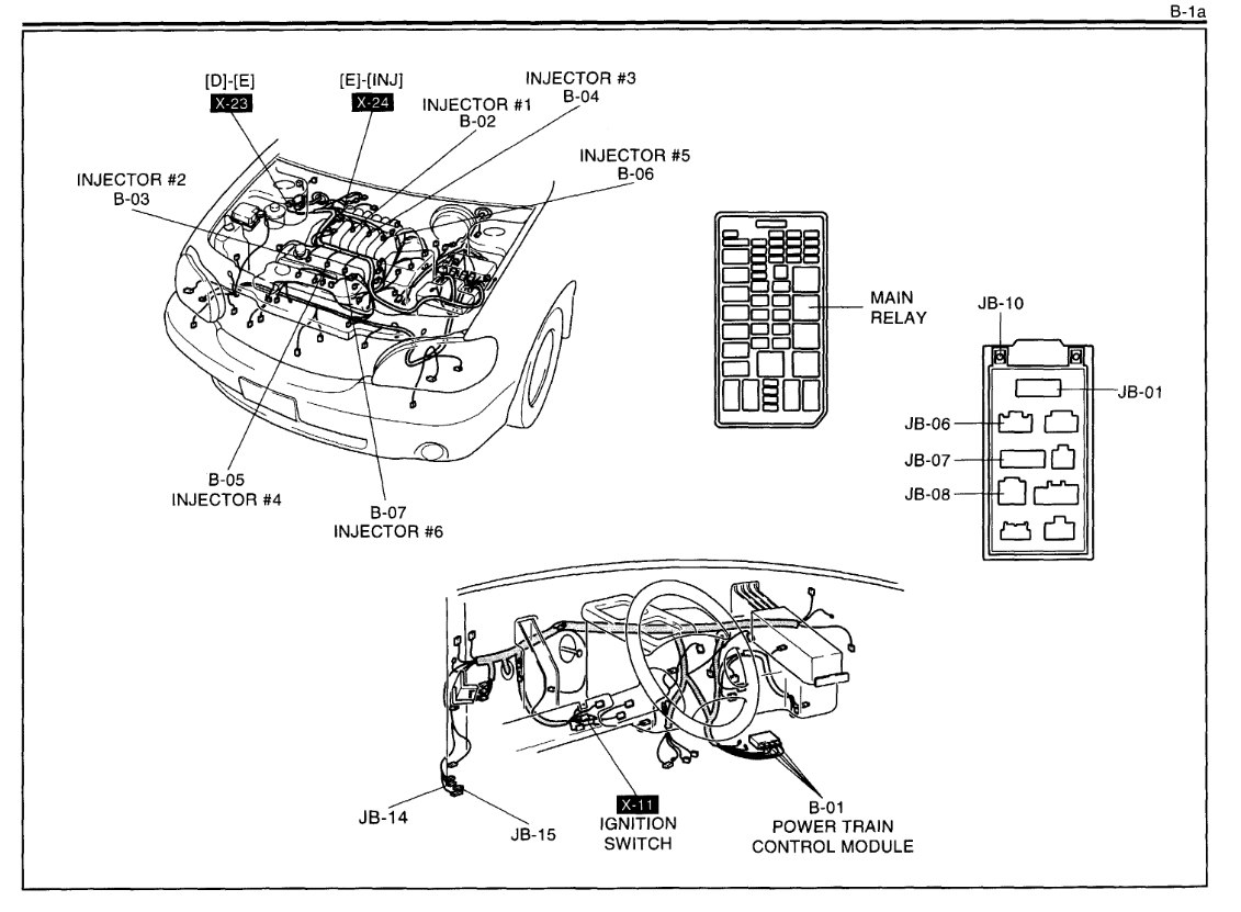

It sounds like the PCM is bad. can I ask when it starts does it run okay? Here is the PCM location so you can swap it out with a used or rebuilt unit. Remove the connectors to check for corrosion/water damage as well. Check out the diagrams (below). Please let us know what you find.

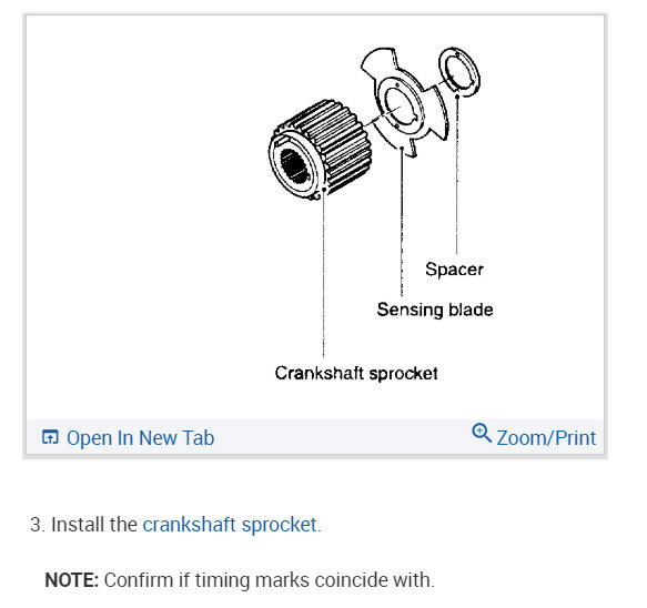

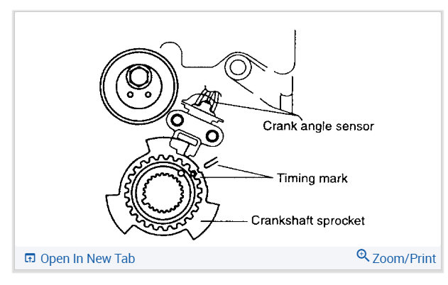

PCM is good, somehow the angle sensor blade got bent and screwed the sensor cause it is now bringing the p0338 crankshaft sensor code. i am going Saturday to find a new sensor and maybe a new crankshaft gear, even though i replaced it not even two months ago. :( darn Kia's!

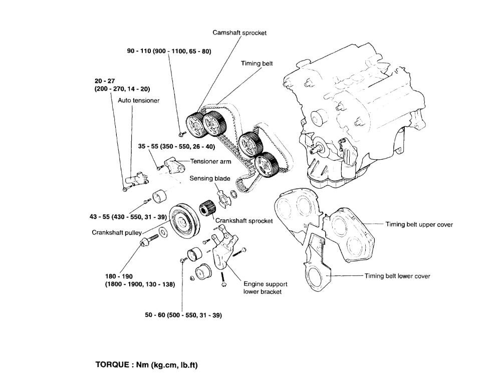

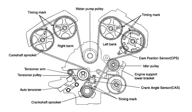

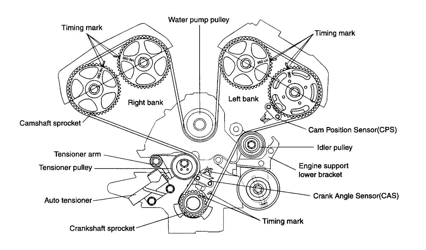

I will upload the video later as I now am re-timing it. the car was about five teeth off. my guess is that it slipped, but i am am lucky as these are interference motors (which is the reason I have done everything I have to it.
Jun 4, 2019 at 1:19 PM

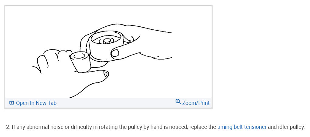

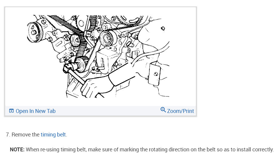

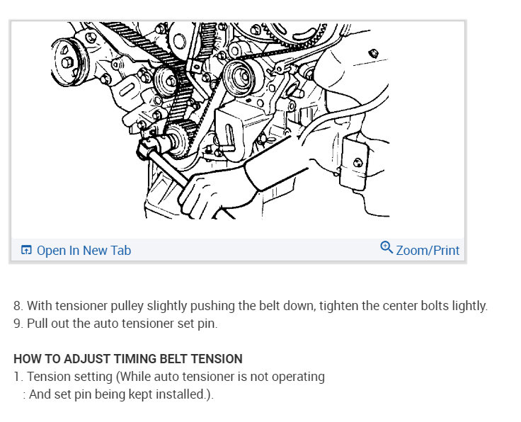

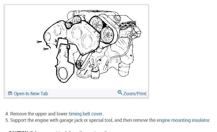

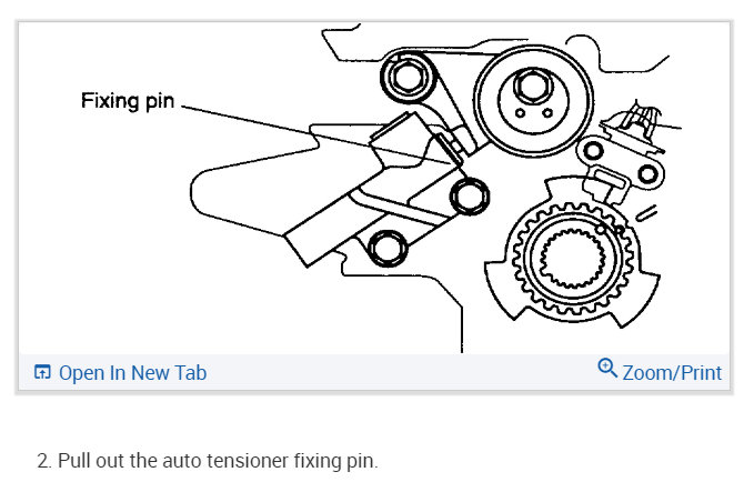

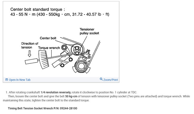

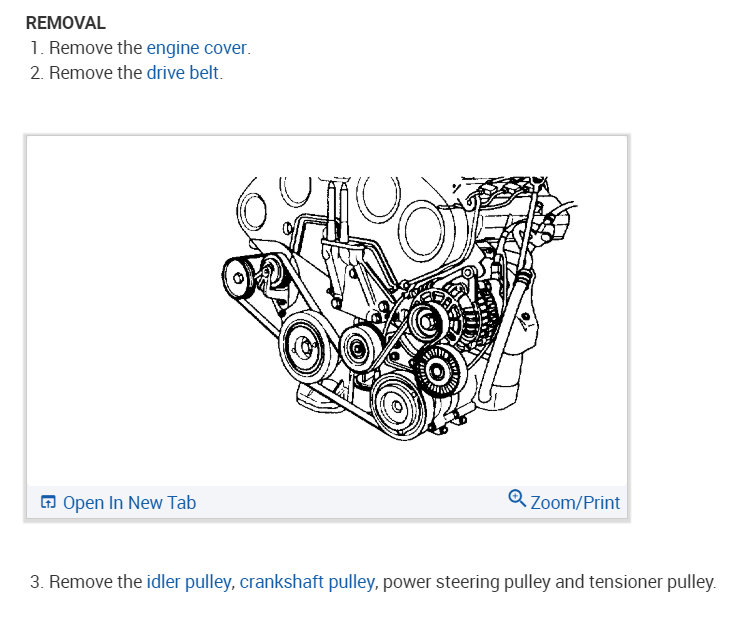

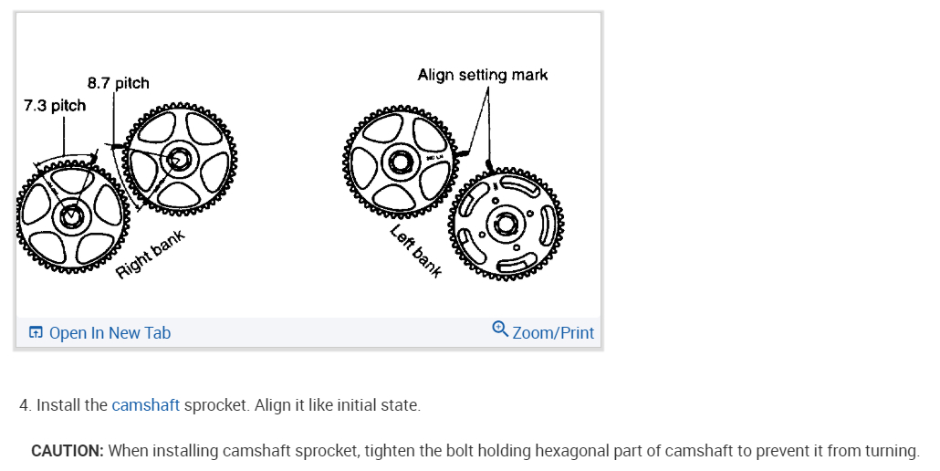

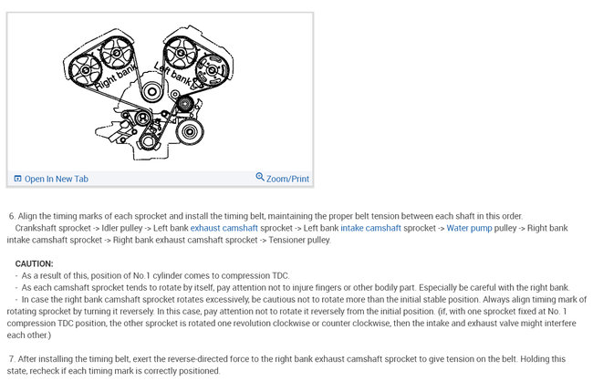

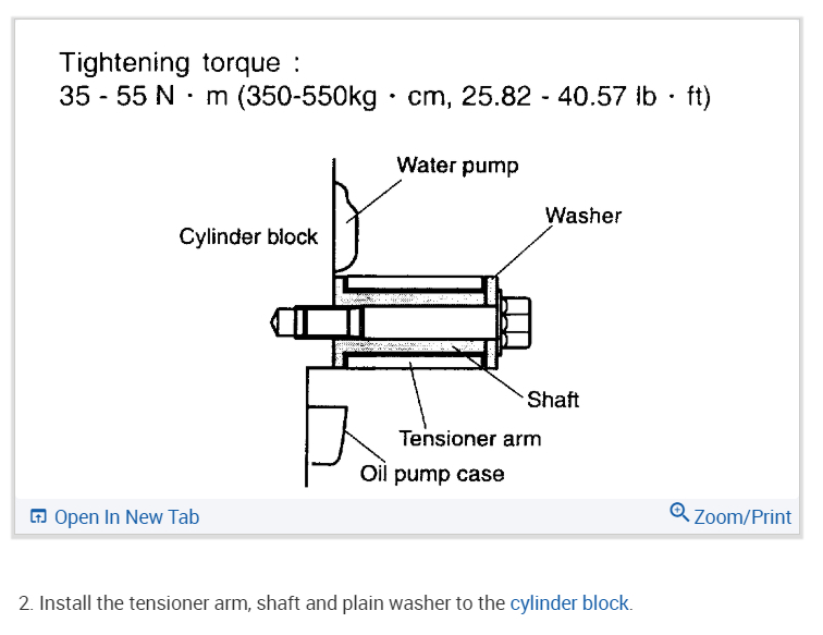

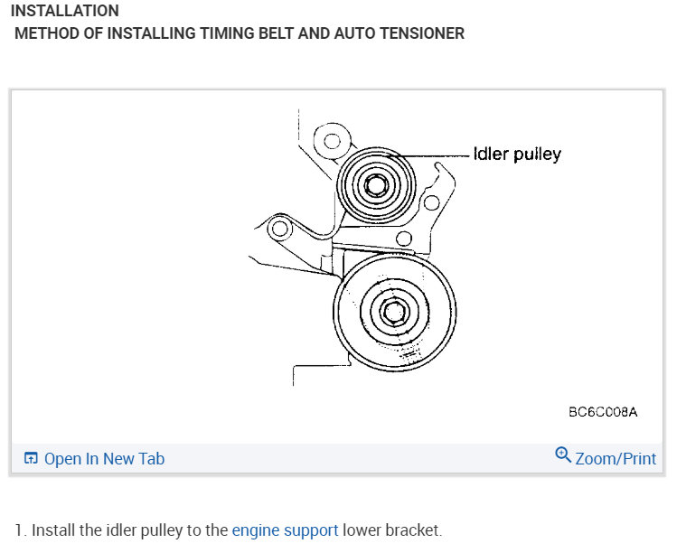

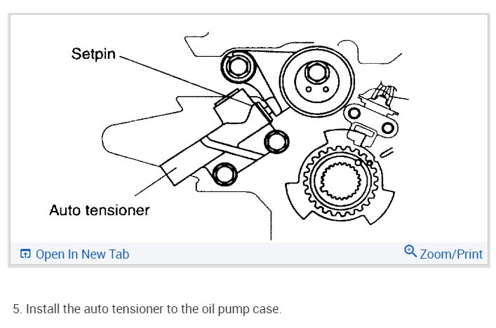

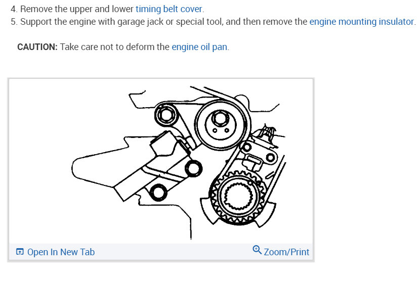

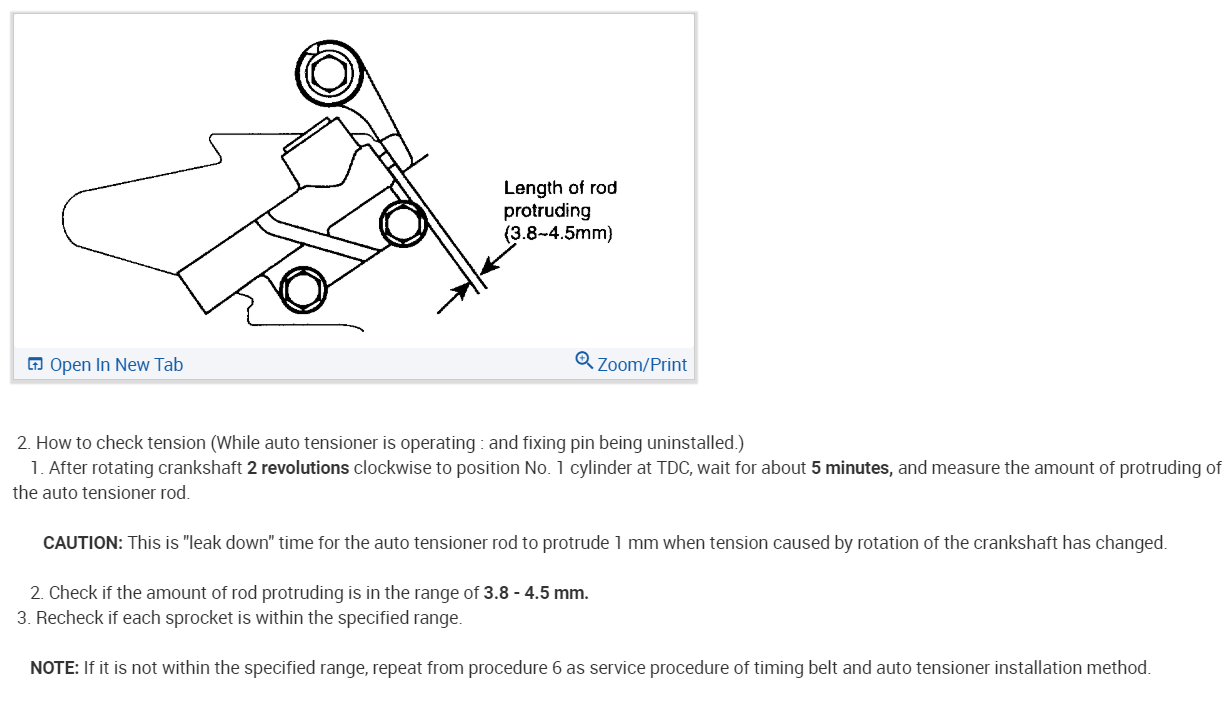

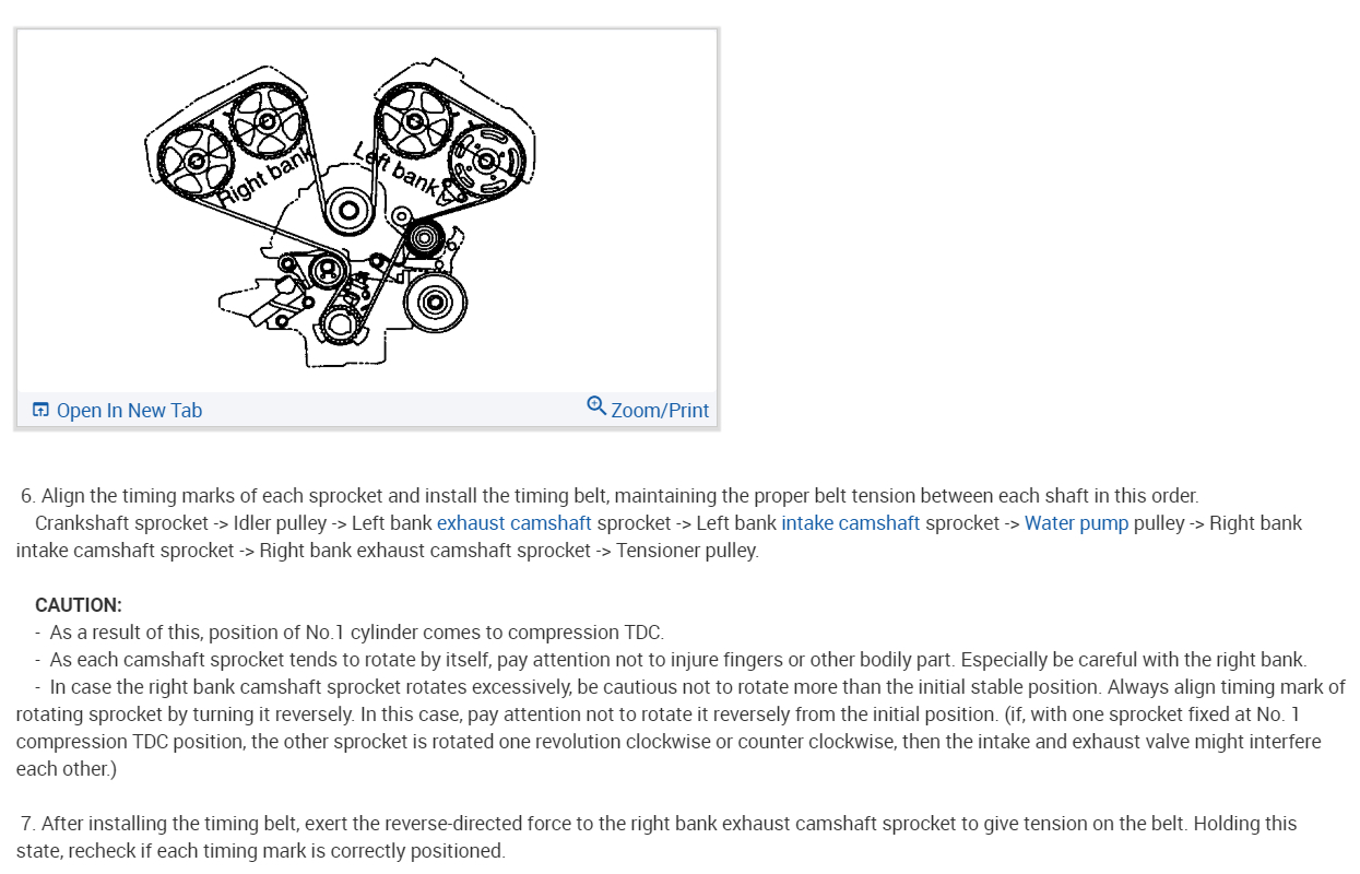

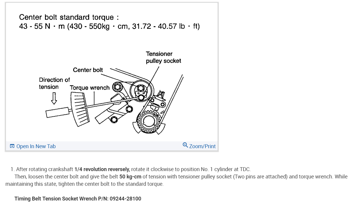

Yep that will do it. I found the timing belt replacement instructions and diagrams below to help you do the job. Check out the diagrams (below). Please let us know what happens.

made sure that timing is set right and at proper tension and it is still doing same thing. cranking acts like it wants to start but will not.
