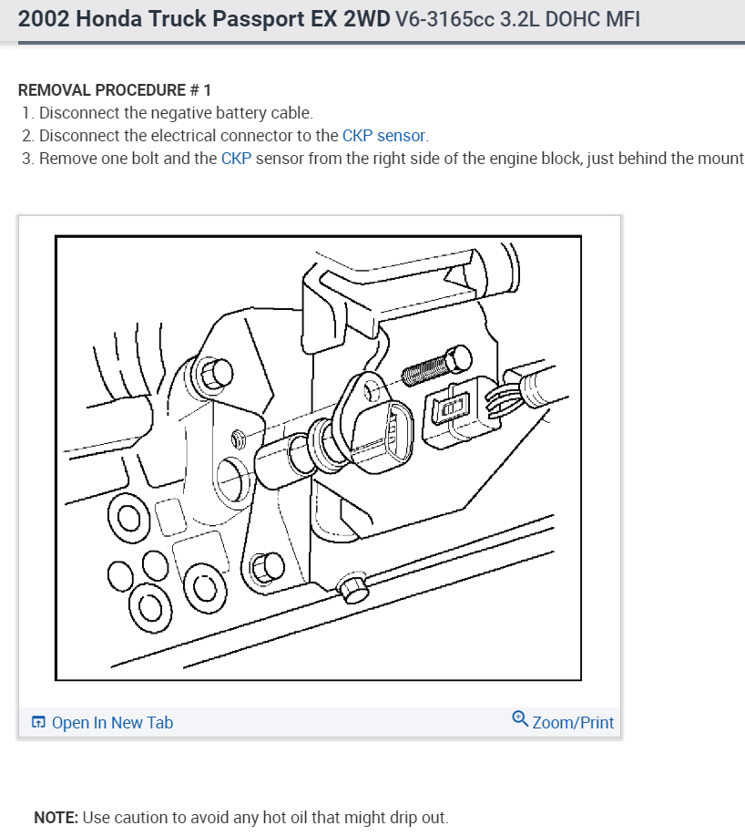

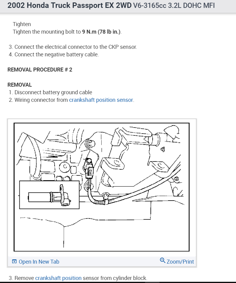

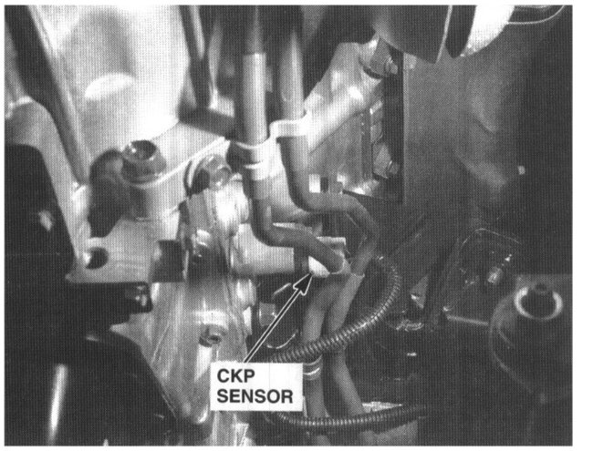

Hi Kerisa my name is Alex and I will be helping you today. This sounds like it might be your crankshaft position sensor giving you problems. Here are a couple of instructional videos that will probably help. Let me know if you have any other questions or concerns, and we will go from there.
Jan 21, 2019 at 2:18 AM
Here is the location of the crankshaft sensor to help you replace it. but lets run the codes is see what comes up. Here is a guide with diagrams below:
