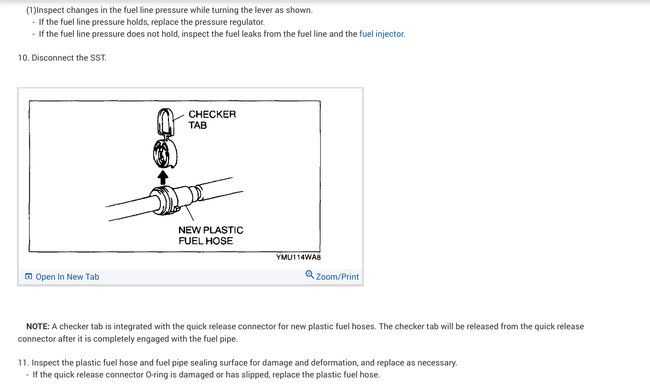

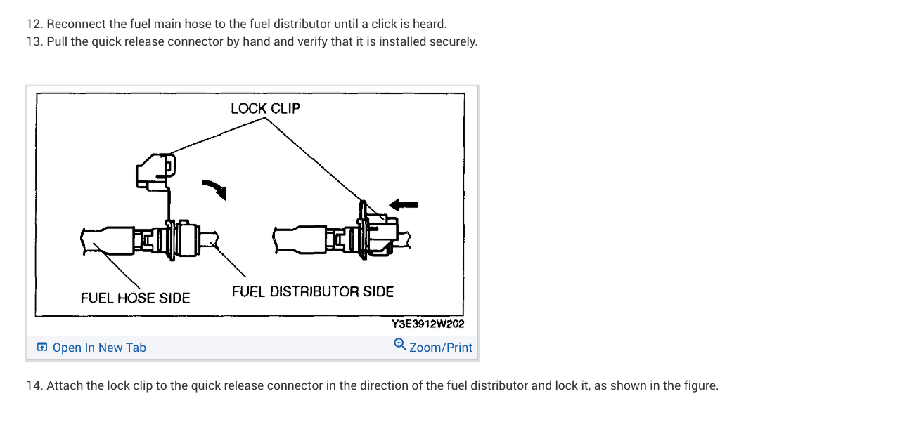

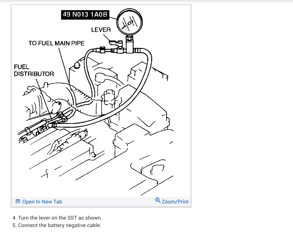

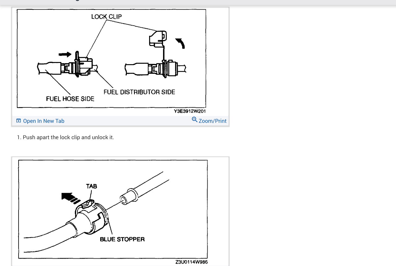

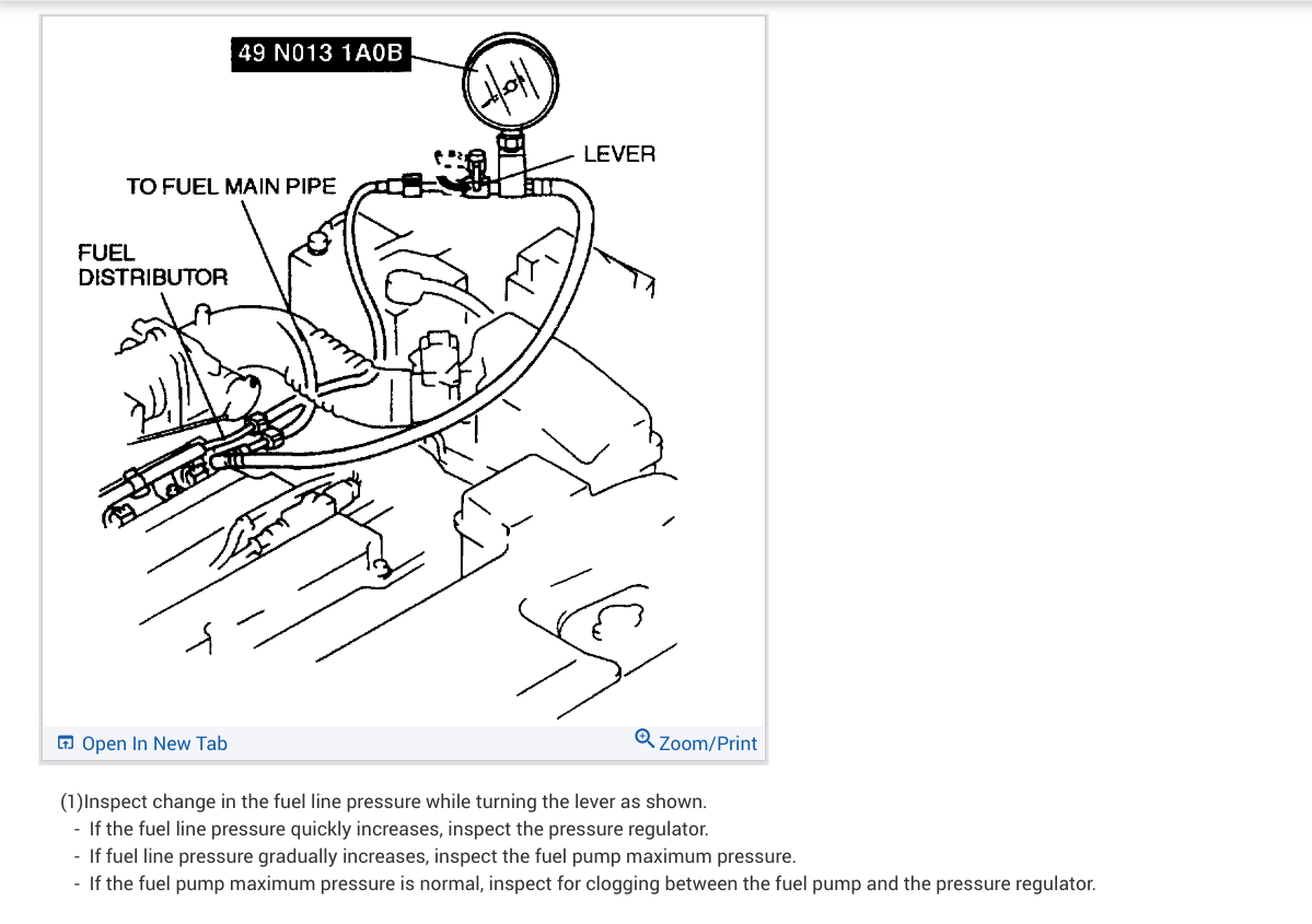

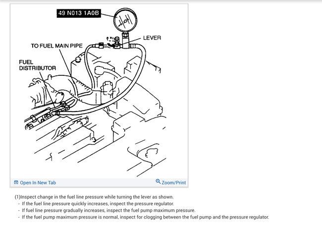

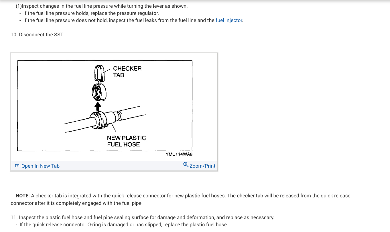

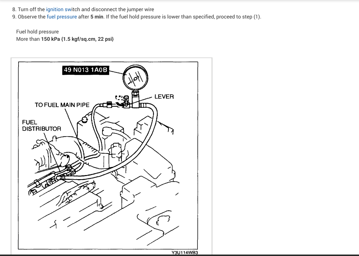

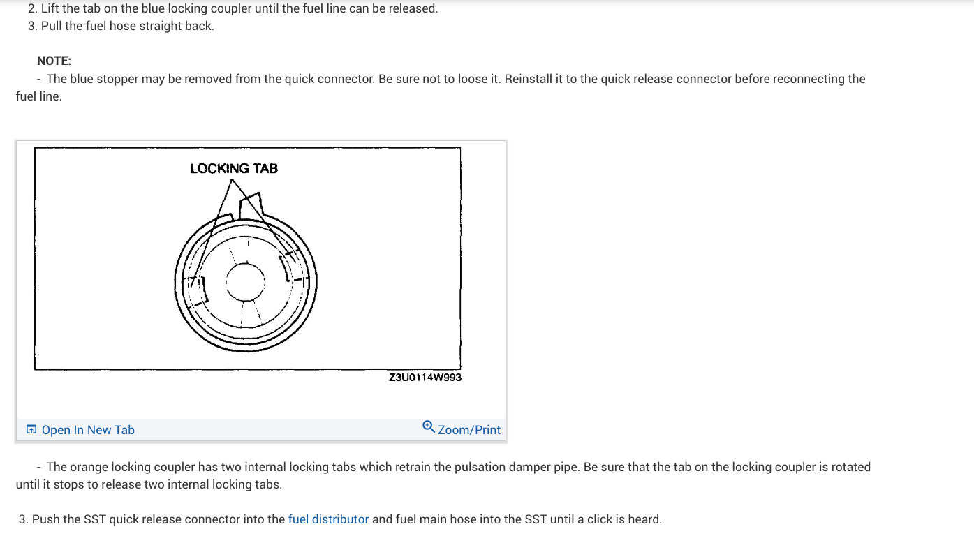

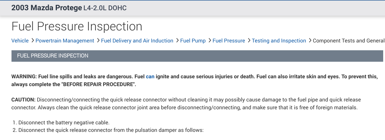

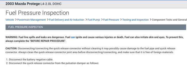

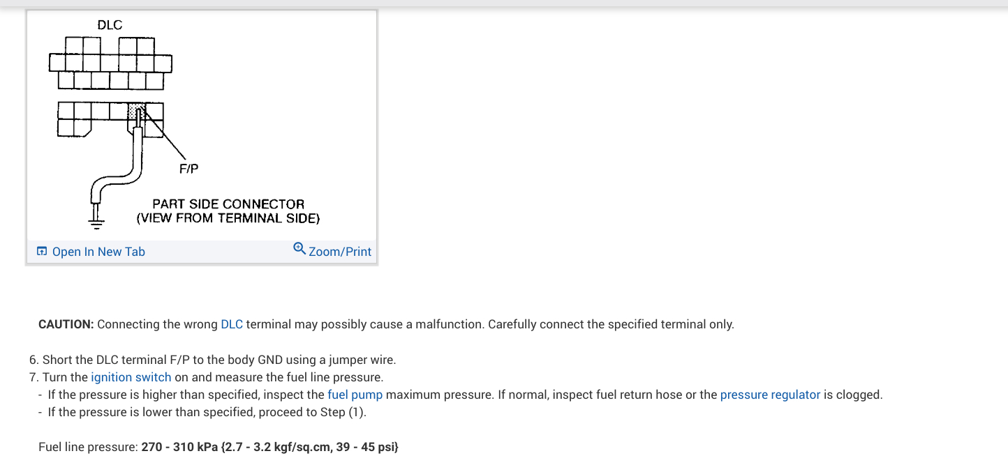

Okay, so it's getting spark, and at the proper time as the timing belt is correct, so let's check to see if you are getting fuel. Here is a link below to a generic guide on how to check fuel pressure:
In the diagrams down below I have included the instructions on how to test the fuel pressure in your vehicle. Please get back to us with what results you are able to find out, and we can proceed from there.
