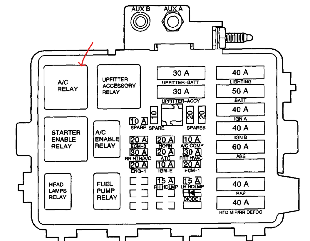

So it sounds like you have 2 issues, we will handle the battery drain on this thread, I have seen the AC compressor relay stick on and rain the battery down on these cars, here is the location of the relay so you can remove it to see if the drain stops, also this guide can help you as well. Please go over it for the easy find drains.
https://www.2carpros.com/articles/car-battery-dead-overnight
Please start a new thread for he engine issue. Check out the images (below). Please let us know what happens.
