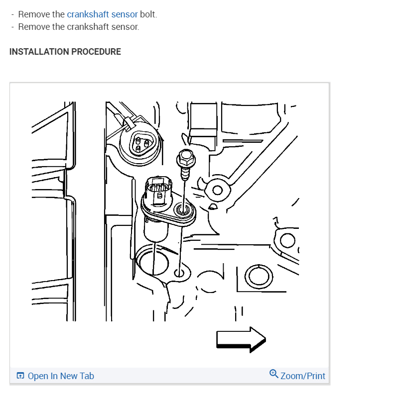

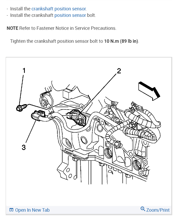

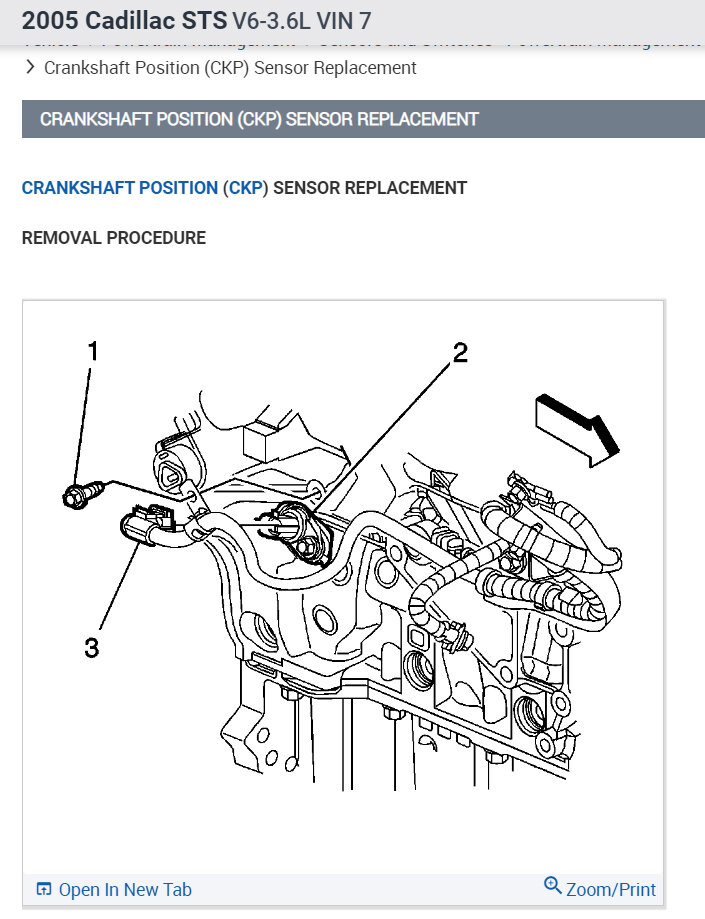

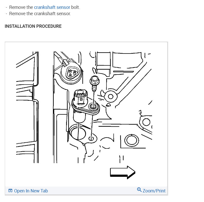

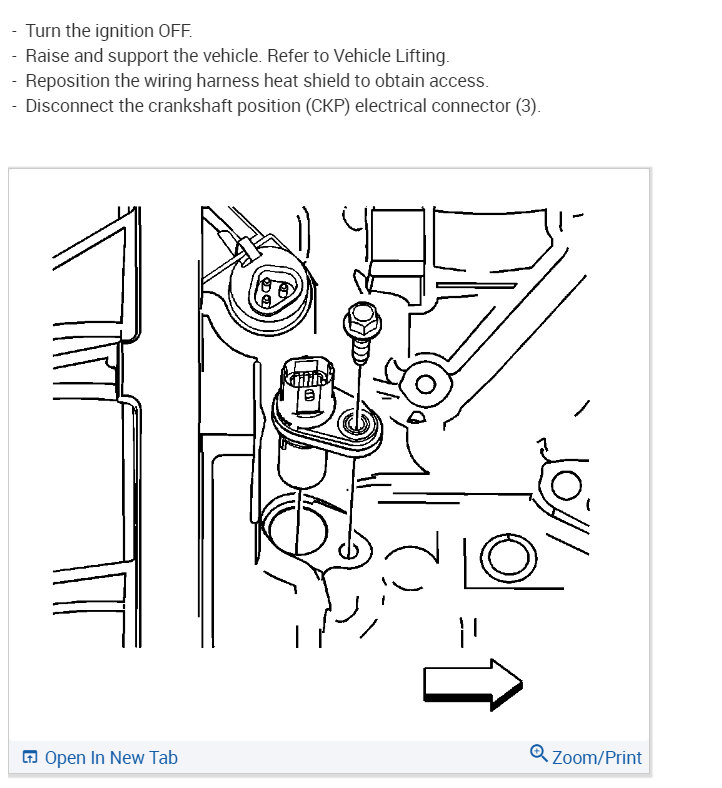

To me it sounds like the crankshaft angle sensor has gone out here is the location so you can swap it out if needed. Check out the images (below). Let us know what happens and please upload pictures or videos of the problem so we can see what's going on.
