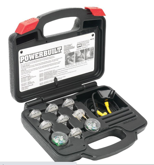

The PCM controls the firing of the injectors. Do you have access to a noid light set? If you don't most auto parts stores have a tool loaner program and can rent you one.I suggest putting a noid light on the individual injectors to check and see if you're getting an injector pulse signal.Hope this helps and thanks for using 2CarPros.

To answer your question no. If all the marks were lined up when you installed the timing belt then there would not be a no-start condition regardless of where the valves where located during the combustion process. I'm still wanting to know if you are receiving an injector pulse. I've attached a picture below of a noid light set.The're available at Harbor Freight,Home Depot, and most local auto parts stores .Auto parts stores have tool loaner programs and can rent you one.Hope this helps and thanks again for using 2CarPros

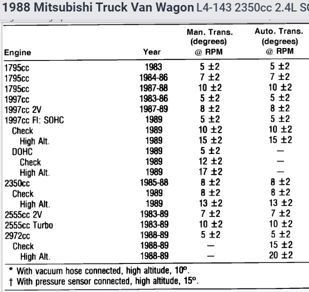

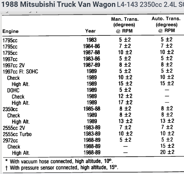

So you say you are getting spark and fuel but a no start condition?After moving the distributor it started? It sounds like it might be a timing issue. I've attached a picture below of timing specifications.Hope this helps and keep us updated.Thanks again for using 2CarPros.
