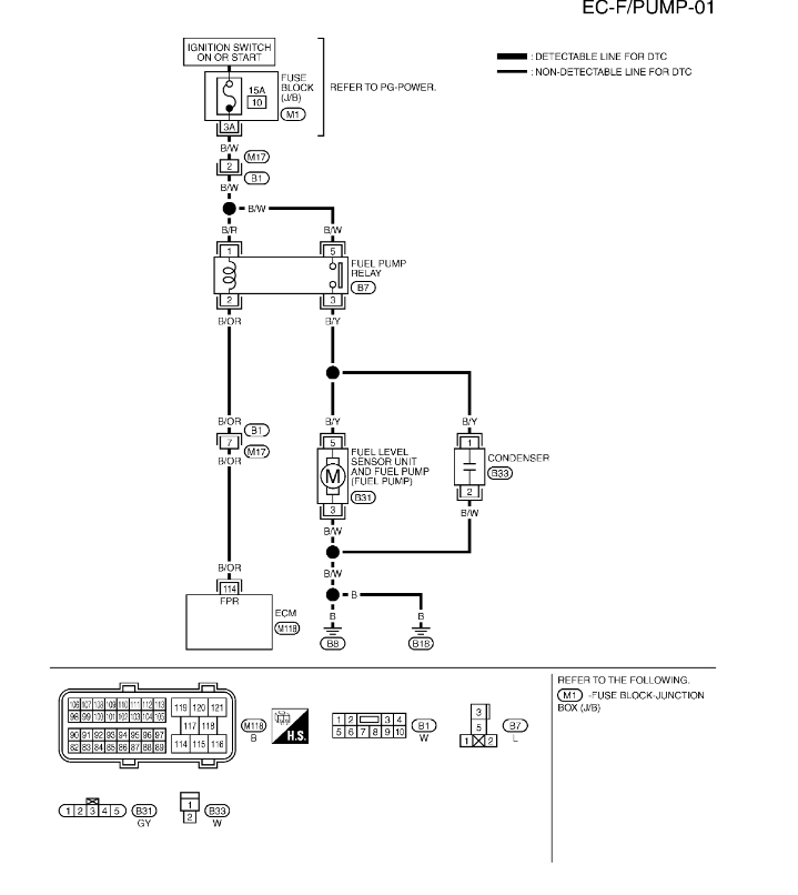

Trying to find fuel pump relay to test for possible crank no start condition.

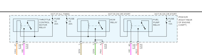

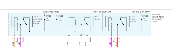

the fuel pump relay is located in the engine compartments' IPDM.
I have seen them "built in" so they might not be serviceable. Can you hear the fuel pump turn on for about 5 seconds when you turn the key on and not crank the engine over? How does the engine sound while cranking over?
This guide can help:
https://www.2carpros.com/articles/car-not-running-advanced
